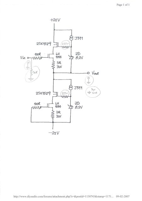

James,
I did build the DAO JFET Follower. (EUVL's work) I am rebuilding it now with another supply that might be good (better?) (CLC without active regulation) I thought it would be a good idea to try and make the Zen produce a little more topend details, if possible.
The amp deserves another shot , since it is an overall very charming and musical amp. The C2 is not in the standard Zen circuit, but i will try to use your bypass technique on the output caps which are 2*1000uF Panasonic FC. Those blue styrene's might work wonders, thanks a lot 😉 Do you recommend the 0,1r at the output caps also?
For reference, i attached the DAO JFET Follower.

Ah Kimbo,
The Lightspeed impedance load problem once again!
Headamp input gets a buffer - at present, thinking of similar to the Jfet D1 o/p buffer (Spencer's), or possibly a variation of the surprising NS10 preamp.
NP mentioned publishing an article soon that may also include a finished design, if we get lucky
The F3 amp has lower Zin (>10kR) and needs a buffer to be usable with the Lightspeed, so there will be some different circuits appearing soon.

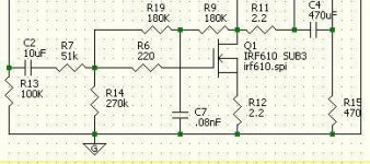

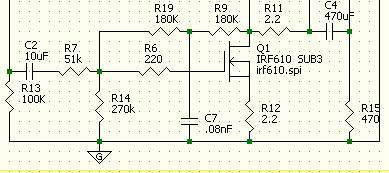

I've been playing around trying to give a slight boost to the treble to offset the drop caused by increasing the input impedance. (I need min 50k if I was to use a lightspeed instead of a regular pot)
My circuit theory is pretty rudimentary, so my idea below is probably full of holes......but hey.....I'm here to learn...so don't be shy with your criticism.
So, what is wrong with inserting a cap in the middle of the feedback to remove some hf.....I figure that bumping up R7 (51K), R9 (360K) & R14 (270K), splitting R9 and adding a 0.08nF to earth results in a -3db at 17.5KHz and -4db at 20kHz. Which is not that far off the original spec of ~ -3db at 20kHz. Will I be altering the operating points too much?
(of course a whooping great inductor in series with R9 will do it but it would need to be bigger than the amp!)

.....but had finally decided to return to the simple original Marcello supply (with perhaps a slight increase in the caps).........
.......but rats! I know I shouldn't have re-read Nelsons 'Zen' papers! I have just been checking out his 'Zen Variations - Part 3 - Active Supply Regulation.' So I'm thinking that if Nelson thinks regulation is a good idea for the zens, perhaps I should reconsider. I know that Metalman says that "A separate P/S voltage regulator for each channel made a whopping difference" Has anyone else made a change from the original to regulated and noticed a difference?
http://www.passdiy.com/pdf/zen-v4.pdf
"For many audio sources, this input impedance is simply
too low to give optimal performance. The ideal input impedance
would be something up around 47 K ohms. We will address this fault here and now...."
And he then details how to go about adding a simple buffer. This appears to me to be the best approach if I wanted to pursue the Lightspeed. I suspect that my scheme in the post above would increase distortion too much.
However after much deliberation (not to mention the fact that so many people love this headphone amp just as it is) I think I will pretty much keep it standard and use a normal pot for volume control. However, James, you may wish to try this.....I'd be very interested in the results especially if you hook it up to your lightspeed,
I am in two minds about the power supply. For the last week I have been planning on using a pair of LM338s for a regulated supply, possibly based on Tangent's 'Tread' http://www.tangentsoft.net/elec/tread/
or even 'Steps'
http://www.tangentsoft.net/elec/teps/
