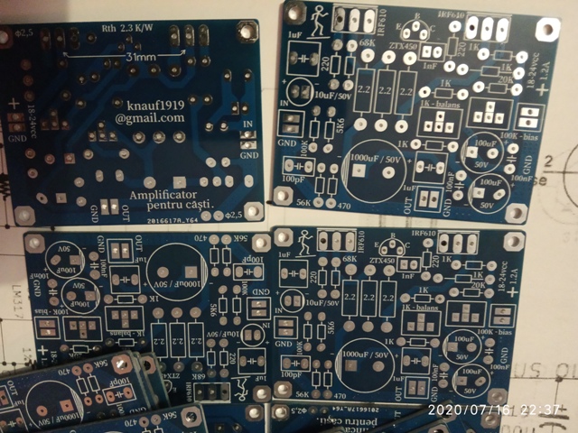

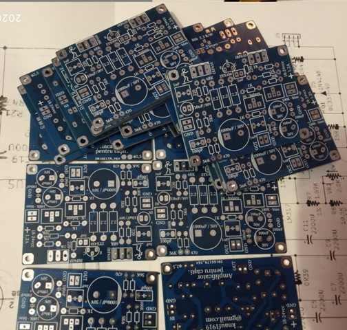

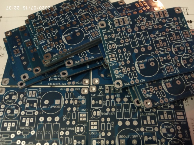

This week I will order some PCBs from the factory and it is possible to make some pieces available.

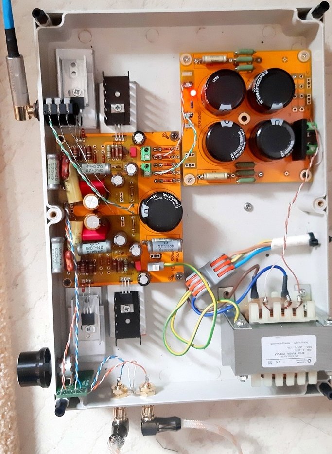

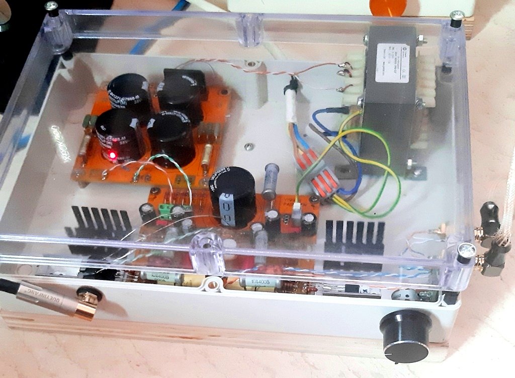

My iteration of the tortello design:
It runs on +24VDC as suggested, with a slightly beefed-up PSU.
Input capacitors are in parallel with ex-Soviet PIO and Silver Mica.
Output electrolytic capacitors are in parallel with ex-Soviet PIO, Silver Mica and Wima FKP.
All others are bypassed with either polypropylene or polyester caps (some are hiding beneath the PCB).
Plus one ex-soviet PIO you can see standing next to the PSU electrolytic.
In terms of sound, it really does a great job!
If I'd try to describe it, it combines solid-state clarity and accuracy with a bit of tube 'spirit'.
It is dead quiet and I hear no thump on turn-on.
Biased at around 200mV.
It is a powerful amplifier that will drive pretty much anything.
I am using it with my HD599 cans at the moment and my 50kOhm potentiometer is set to 1/4 of a turn.
Mosfets can get pretty hot, so they obviously need proper heat-sinks.
Thanks again to tortello (and Nelson Pass) for sharing this simple and great sounding design.

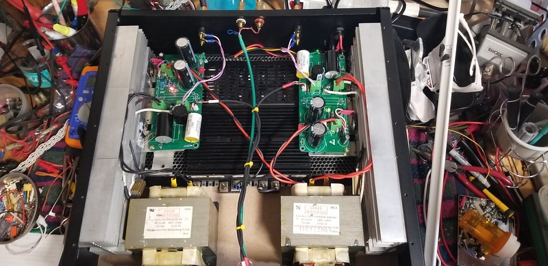

On SE Class A amps, the stereo imaging might be not so good if the channel separation is compromised from a common PSU rail that doesn’t have any local bulk capacitance to isolate fluctuations. You can test this by listening to left channel while only inputing signal to right channel etc. this can be fixed with an extra CRC between the PSU and each channel. About 2200uF and 2.2ohms should work.
Also, for 32ohm headphones use 2200uF output caps for deeper bass extension. Bypass with a 2.2uF film cap for good HF extension. Your chassis and system looks really good nice and clean. If you are into simple Class A headphone amps that have slam and only 0dB gain, check out the LuFo Lite.
You are right about the separate rails.Nice work!
I might do a version 2.0 with separate PSU rails and PCBs for each channel.
I use 1000uF of capacitance for the output due to limited space. I might squeeze a larger cap there as you said.
Regarding your unity gain design, it definitely suits my taste. I will look into it.
Thanks!
