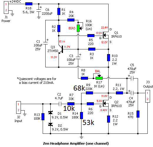

Tested few IRF610 (12) according to the matching circuit, the SEC ones are in the 4.49-4.59 range, the Vishay ones are between 4.90 and 5.01.
Can make several matching pairs for Q2 🙂

Powered up... and realized that I cannot adjust the bias: the voltage across R12 is around 1.1V and does not change while adjusting the 100k trimmer (R16).
Used 2sc1815 instead of the ztx450 for Q3. It sounds like the 1815 can have two pinouts with E and B inverted 😱

Could such B/E inversion explain the abnormal behavior?

Looks like even in the pdf of the second link (CDIL), both ECB and BCE (front view) are given in pages 1 and 2 respectively. Inverted the transistors on the pcb and can now adjust the bias (0.33V across R12 for 150mA).

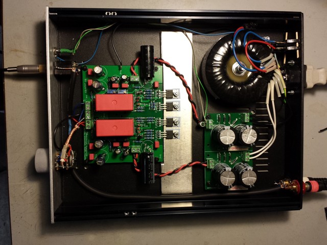

One more working mini-zen build started yeeeears ago 🙂
Here are few pics:
Big thanks to tortello and knauf1919 for the project and final layout. Also thanks to ptsoundlab for his info page and to digi01 for his all-in-one layout and simplified psu.
As written before, Q3 are 2sc1815 (take care for the pinout), the input caps are 4.7µF. The front 12V light gets about 3V to make it less bright. C4, C5 are a couple of 470µF capacitors, zeners are back on the pcb.

Nice build!
But you haven't implemented the delay relay board which shorts the output for a sec or two after turn on. Don't you get a terrible thump in your headphones on turning on? I have the delay relay but sometimes when I switch off and on quickly the delay is not long enough (the delay circuit cap is not fully discharged so it engages the headphones quickly) and I am getting a terrible noise in the headphones, but not as terrible as without the delay thingy. I cannot imagine it is good for them without any delay circuit.

My fist version did come with the delay relay. I plan to implement it in the future now that I know that all is working fine.
As far as I remember, the delay was rather short (a couple of sec as you mentioned) but long enough to avoid noise when turning on. Maybe changing the components for a longer delay would be worth.

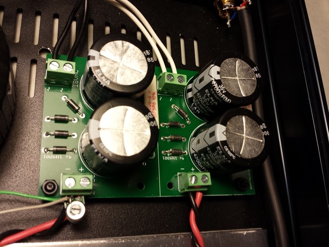

What I find intriguing is that you seem to get away with a simple power supply.
Do you have any R between C and C on your PSU board?
The original power supply did not work for me. But it is probably due to my sloppy build. Yours is so much better!
I ended up using Nazar's PSU with an extra CRC. I still have some hum with HD595 which is very sensitive. HD600 is less sensitive and the present PSU is adequate.

The power supply is indeed a very simple one, done according to digi01 schematics (New MINI ZEN Headphone Amp PCB group order...). [1N4001 (4), 4700uF (2) and 5.6R (1)] x2. It then feeds the amplifier with a pcb (very) inspired by the one that knauf1919 posted.
