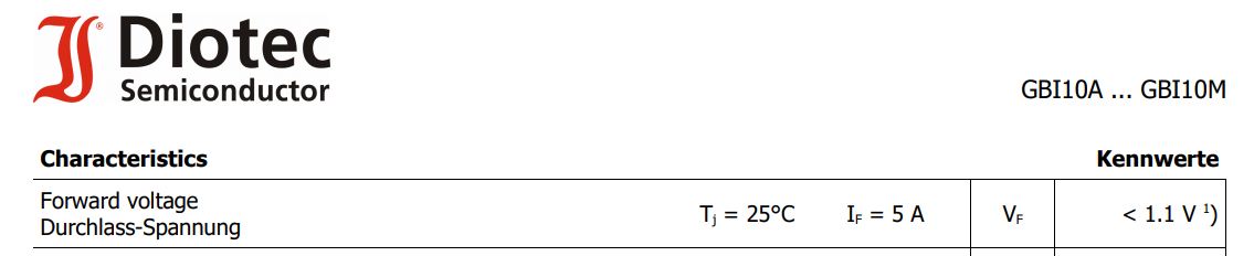

The choice of voltage for the power transformer must be chosen taking into account the voltage drop on the rectifier bridge mainly, but also on the resistive elements.

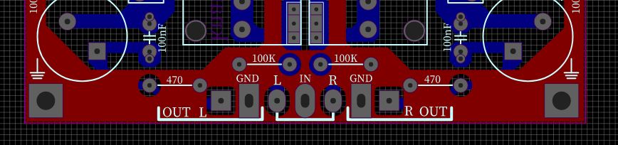

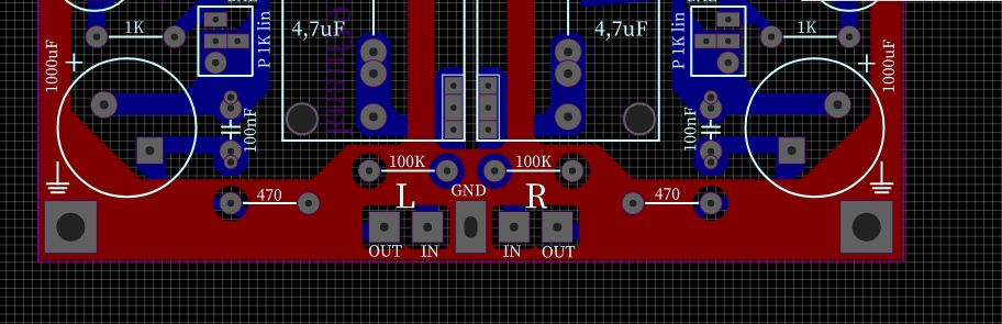

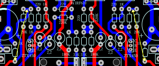

Regarding the pcb post #244, looks like the junction/connection between R1-R2-R4 is missing withing the right channel.

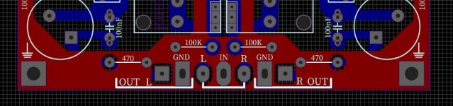

Still wondering how the inputs-outputs are connected in this board (one ground per signal, or one ground per input/output, or grounds only for outputs...?).
Show me in a drawing.Regarding the pcb post #244, looks like the junction/connection between R1-R2-R4 is missing withing the right channel.
Especially for you I will put more GND connections. 🙂🙄Still wondering how the inputs-outputs are connected in this board (one ground per signal, or one ground per input/output, or grounds only for outputs...?).
This will be the final version. But I'm not quite sure.
I rushed a bit with attaching the files without paying attention to certain details. I will ask a moderator to change the files with some correct ones.

Here is a crop regarding what I was saying above.
On the left side, there is a (blue) connection between R1, R2 and R4.
On the right side, R2 and R4 are connected together, but no connection to R1.
Regarding the ground connections, thanks, it's clear now. Will have to take care about loops though 🙂

I think this is more appropriate. Single connection for GND signal.
I also corrected the connection between the resistors.
That's all. I hope there was no mistake.

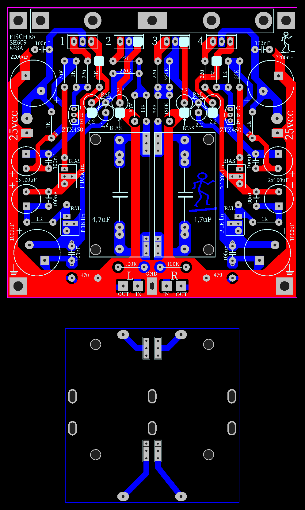

I'm asking a moderator to delete the files from the 244 post because they are wrong. Thanks.
corrected files // 244 post //
I have corrected the files posting 244. Maybe I will make some boards at the factory but after going over this situation with the virus.
According to the promise I will also draw the power supply.
