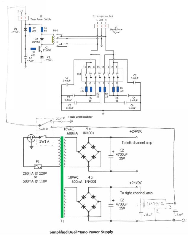

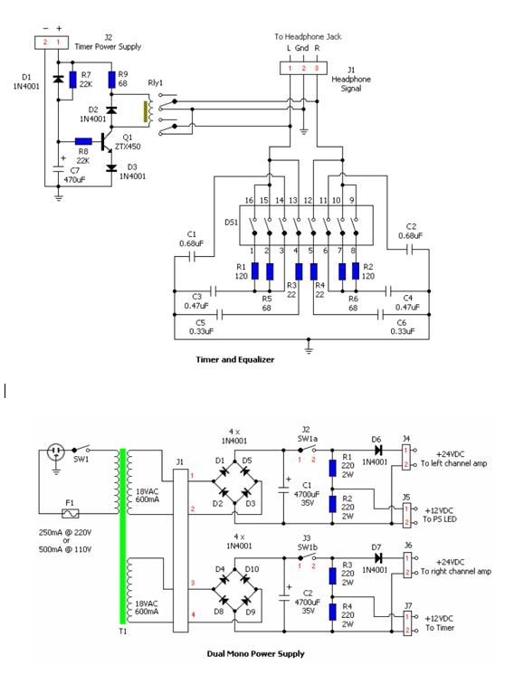

Question about the Muting Timer Circuit
I would like to retain the muting timer function, but would like to eliminate the voltage divider network (2 x 220R) that is used to create the 12V for the relay, and also switch off the line voltage coming into the transformer when the headphone amp is not being used.
Would the modified circuit shown below accomplish this? The reason I want to do this is to keep all AC out of the unit when I am sharing the input select and volume control to act as a passive preamp for non-headphone use.
Thanks!
Thanks!

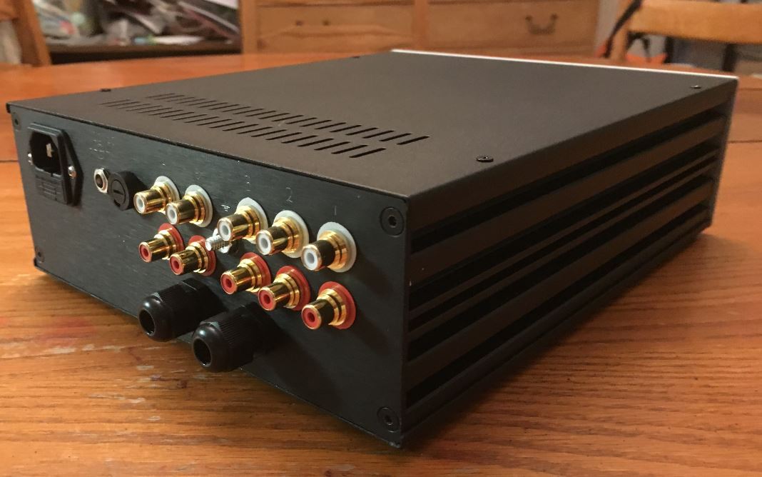

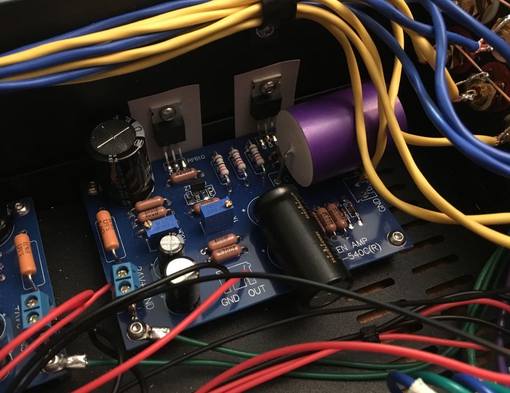

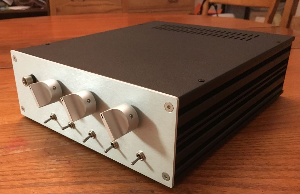

Thanks for sharing the design of your headphone amp Tortello! Mine is up and running and sounds great through my Grado SR325e headphones. Thanks also to everyone else who posted pictures of their builds and shared their experiences it really helped me.
To help others with future builds I am posting a couple pictures and some of my learnings (If these things are obvious to some, please keep in mind that this is my first DIY electronics project).

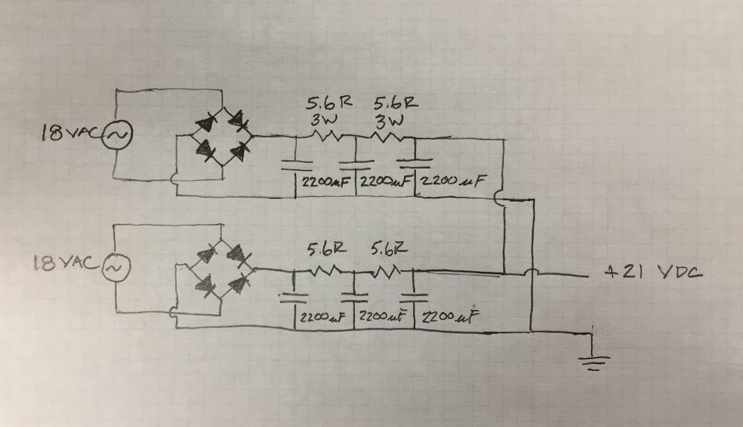

5) The hardest aspect of my build was getting the power supply quiet.
Two things really quieted my amp down:
Adding some additional CRC filtering resistors to my power supply
capacitor bank (see power supply sketch below)
Adding Tortello's recommended 100 ohm resistor between the output
ground and the safety earth.
Without these two items, I had a very annoying 60Hz buzz. After, I could not hear any power supply noise whatsoever.
6) The parallel 470 uF output coupling capacitors can be replaced by a single 1000 uF Nichicon Muse capacitor (P/N UKZ1E102MHM) for less money, and I liked the idea of having a single vs. multiple caps on the output.
Observations:
Thanks again Tortello!

I used a large CRC filter, with Grados my amp hasn´t noises but with extremely sensitive headphones (like JVC PX1000) you can hear a very low hum (I need to try a 100R between ground output and earth ground).

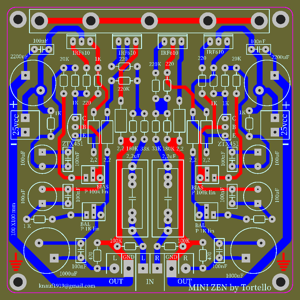

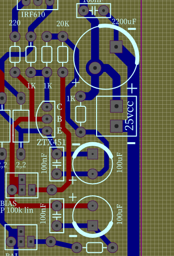

Because I was curious to build this headphone amplifier, I made a PCB (second) variant more compact.
The first one was 12 x 12 cm and had some mistakes. It is not an original version but adapted after the others that have been proposed by various members.
The prototype, in a single layer, is still on the work table, not having too much time for it.
The first impression is ok and thanks to the member @tortello and to the others who participated directly and indirectly in this project with tips and proposals.
Interested in your layout.
Also tried to make a single pcb for the whole amplifier (power+amplifier), maybe I should post it for advices. It was aside for years. The main problem is that there is a strong noise even with the inputs not connected (no wires). Might cut the board to separate power and amplifier parts.
Thank you for your interest.
Yes, I will make a separate PCB for power supply in a few days.
I will look for two transformers or one with two separate windings at Mouser. The question is the power supply stabilized or not? If there are proposals, I try to implement them.
So far, and because the box won't accomodate 2 transformers. The power supply is done with a single transformer, 2x18V.
