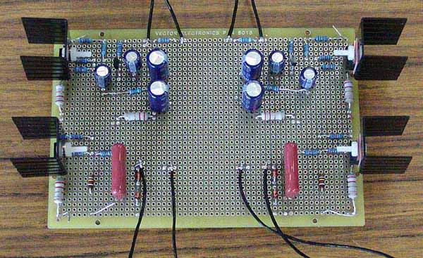

Moving Along - Old School Style
Stuffed a perfboard over the weekend and soldered it all point to point. Thought I'd share a pic. Waiting on delivery of a 50VA transformer from Plitron before I put together the power supply. Probably going overboard with the powersupply, giving it 24,000 uf of filter capacitance in a CRC arrangement, followed by separate regulator circuits for each channel. I'll post a pic of the PS once it's built.

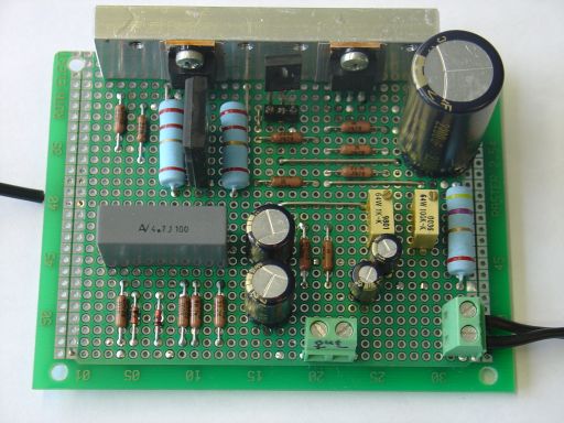

ZEN headamp
Hi Tortello or anybody who can help me,
first thanks for your detailed description! I´ve build a pair of them and powered them with 24V Akku source. But the sound isn´t anything else than wide and clear. May be it depends on my headphpones? I use Ultrasone with a high impedance of 75 Ohms. The actual output current is about 130mA. Is it aproblem of the output impedance or what can i do?

Try a better description of the sound ;
Chek if the input resistor value (R7) is correct .

Ok Stefano,
I´ll try it: The sound is nervous, aggressive and like clipping, especially at higher frequencies.
The R7 (33k in series to the coppling cap?!) is correct, but for volume control is use a 10k Pot in parrallel to the input, may be this is too low?
Hi Baggerbole,
this kind of sound is quite unusual.
The headphone impedance is not a problem, here: maybe the ( not so costant) batteries impedance?
Did you bypass them?

Thanks Marcello,
the used batteries are "big blocks" from Panasonic with a capacity of 7,2Ah and a max discharge current of over 100A.
I haven´t bypassed them (with a big Cap?). Do you think it´s necessary?
To the Italian fraction 😉
dear guys, that´s really not my first "freehand" builded circuit without a professional pcb, so we can exclude wiring and soldering mistakes to nearly 100% (nobody is perfect...)
And as I´m always still unsatisfied with the result of this job, I´ve done some additional measurements:
Outputlevel at 1kHz ->6Vpp, 10kHz ->5Vpp, 20kHz ->3,5Vpp
with 1Vpp input signal. AC level R10,R12 -> 8mVpp.
Instead of the ZTX450 i´ve used BD235 (hfe 40-160). I´ve tested different BC... with higher hfe, they made the circuit swing with MHz!
Give me a hint what to do.
Thanks and greetings from the German 🙂
Bernd

I liked Tortello's circuit . It was playing with a 600 ohm Sennheiser HP
very well .
I know at headwize there are all the DC measurements that describes the circuit . So if you have around that values the circuit should be OK .
The mosfets can be demaged , also if they work.
Try pull up the active part of the current source and listen if someting
changes -disconnetting R8 or C3 .
If you used zeners , check the zeners .
Check if the output capacitor(S) are ok .
Remember that this circuit is phase inverting .
