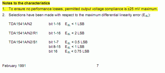

Do you have any data on that? The manufacturer does not
mention voltage degradation in the data sheet.
TDA1541A datasheet (page 7) says:
"Notes to the characteristics
1.To ensure no performance losses, permitted output voltage compliance is ±25 mV maximum."
I made 3 DACs with that chip, tried various I/V solutions and found out that it really sounds best with DAC's output as close to 0V as possible.
Snap from datasheet:
