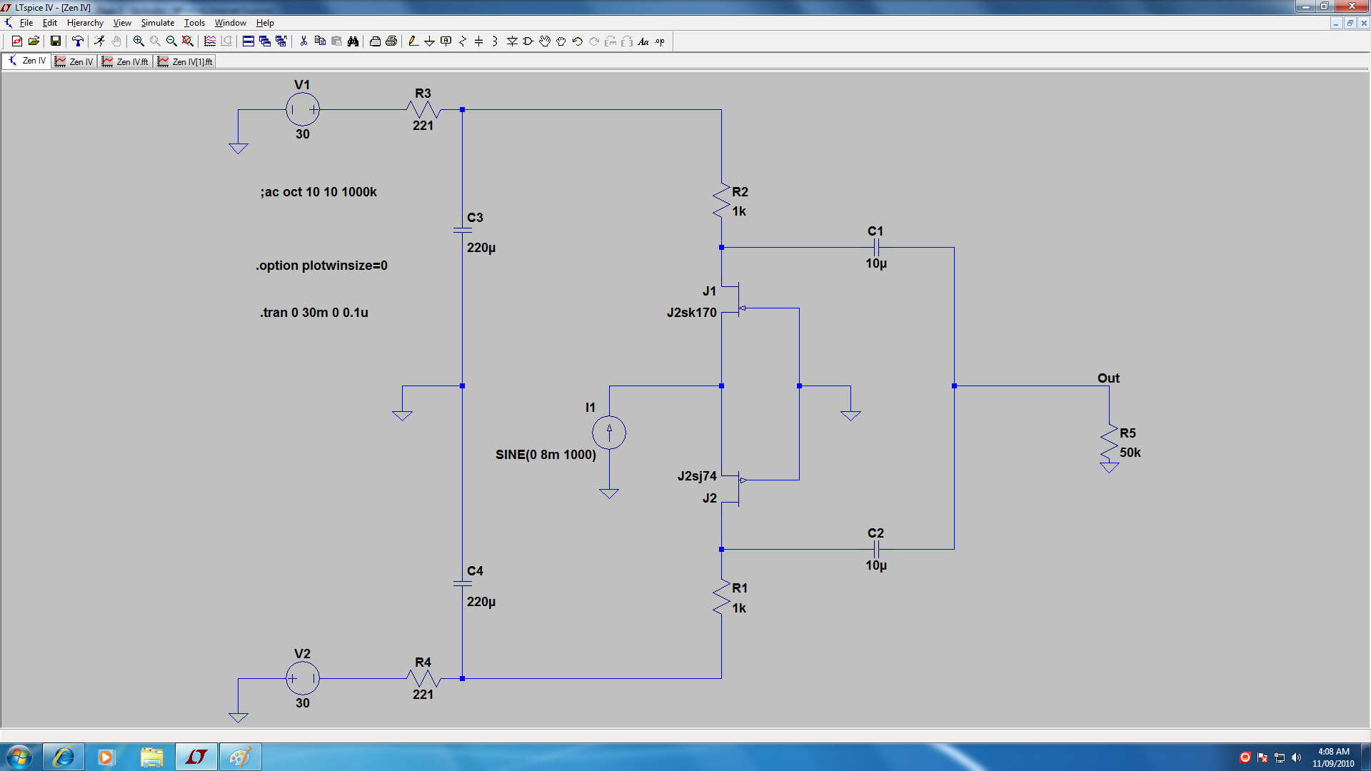

Anyone have a Spice model for this up and running yet ?

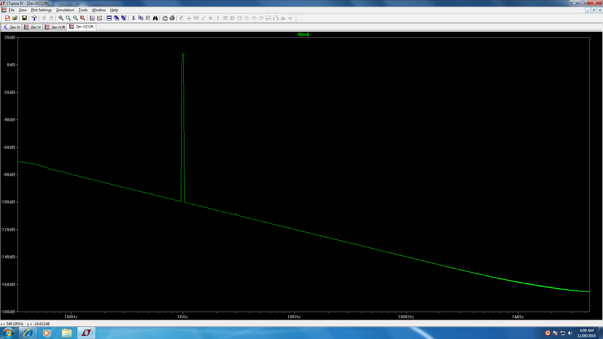

FFT of 4V peak into 50k load
You missed 10K/4n7 on output , they are the load too!
They are optional parts.
If you want me to post it I will but the results are virtually the same (ie 3/5 of FA)
