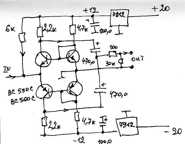

There is one who was a bit similar type of I/V output in a russian forum but using BJT, I don't know how good it would be with a TDA1541, and if it's as good as the Zen I/V, but BJT are easyer to find than Jfet.

Hi Gaetan,
There is a lot of problems with this stage:
- You use a voltage source input. Should be a current source with offset=2mA, amplitude=2mA to simulate a tda1541
- the bias current is way too low. Should be around 10mA at least to correctly handle +/-2mA swing.
- the input supply should be stable if you want to use the 6k resistor as a current source. If it is not, use a current source with a jfet.
- the rails are too low to have 10mA at idle in the output resistor R1/R4.
I've made some simple modifications to make it run:
- set the source to current type
- supply with +/- 24v
- bias resistor at input 3k
it simulates ok then

Just to make sure that everyone understands clearly - there are no problems with the I/V stage from post #106 (it works nicely, with 8.5mA through input pair and PS of +/-24V instead of +/-12V, Zin=2.5 Ohms).
The only problem is the way the Gaetan simulated it 😉 (apolon34 described the errors).
Let's not hijack this thread further - guys with interest in BJT stage from post #106 can open separate thread.
Hello apolon34
I've use the circuit from post 106 without mods, but I've forgot to give a sine current source.
After using your suggestions it's now working and thd spectrum simulation give a -80 db thd for the second hamonic.
