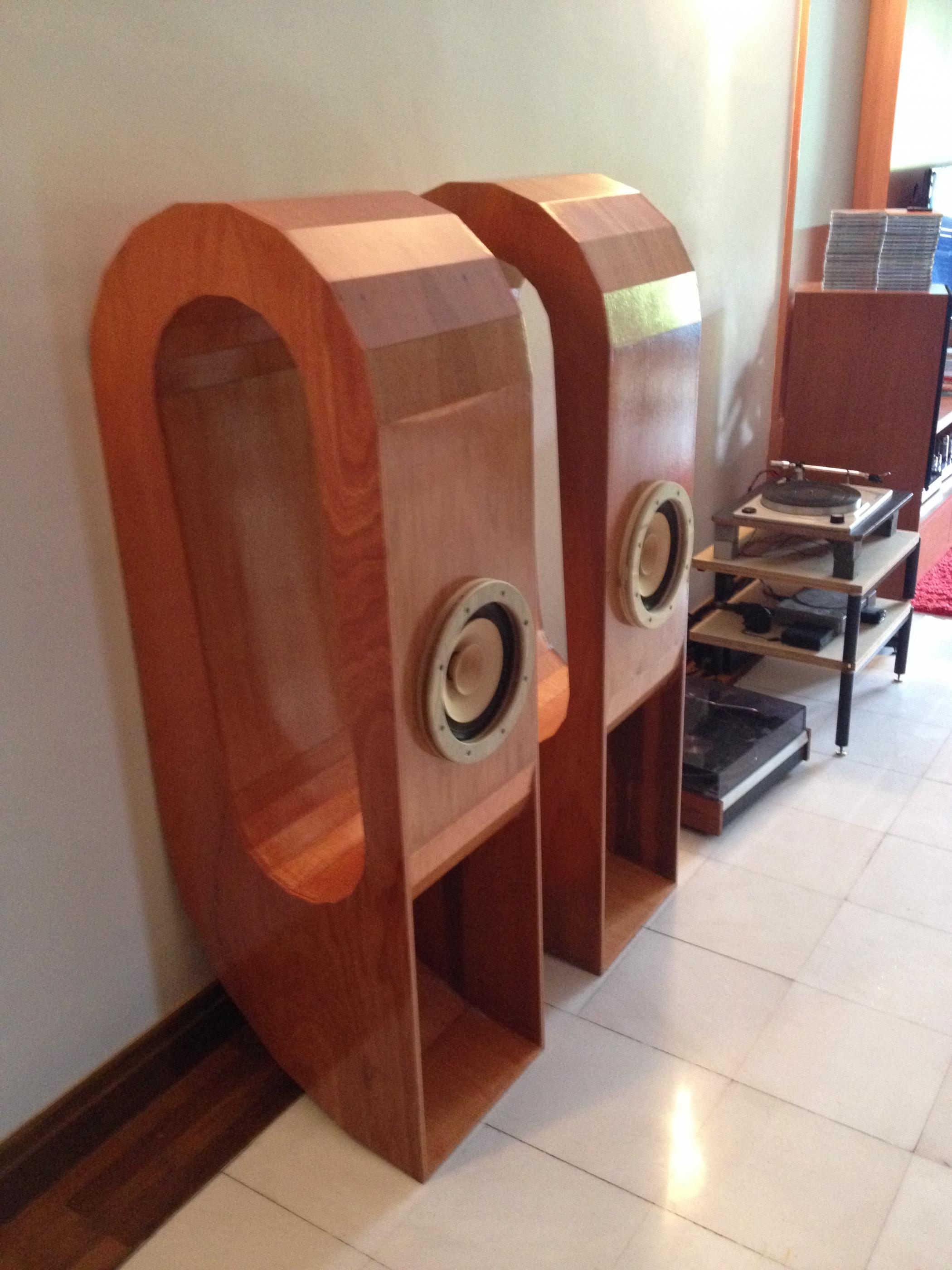

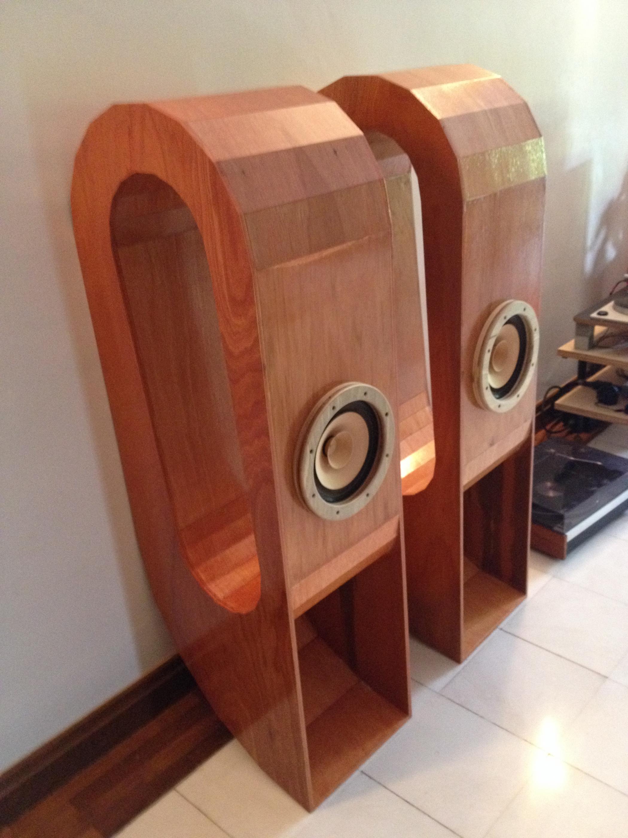

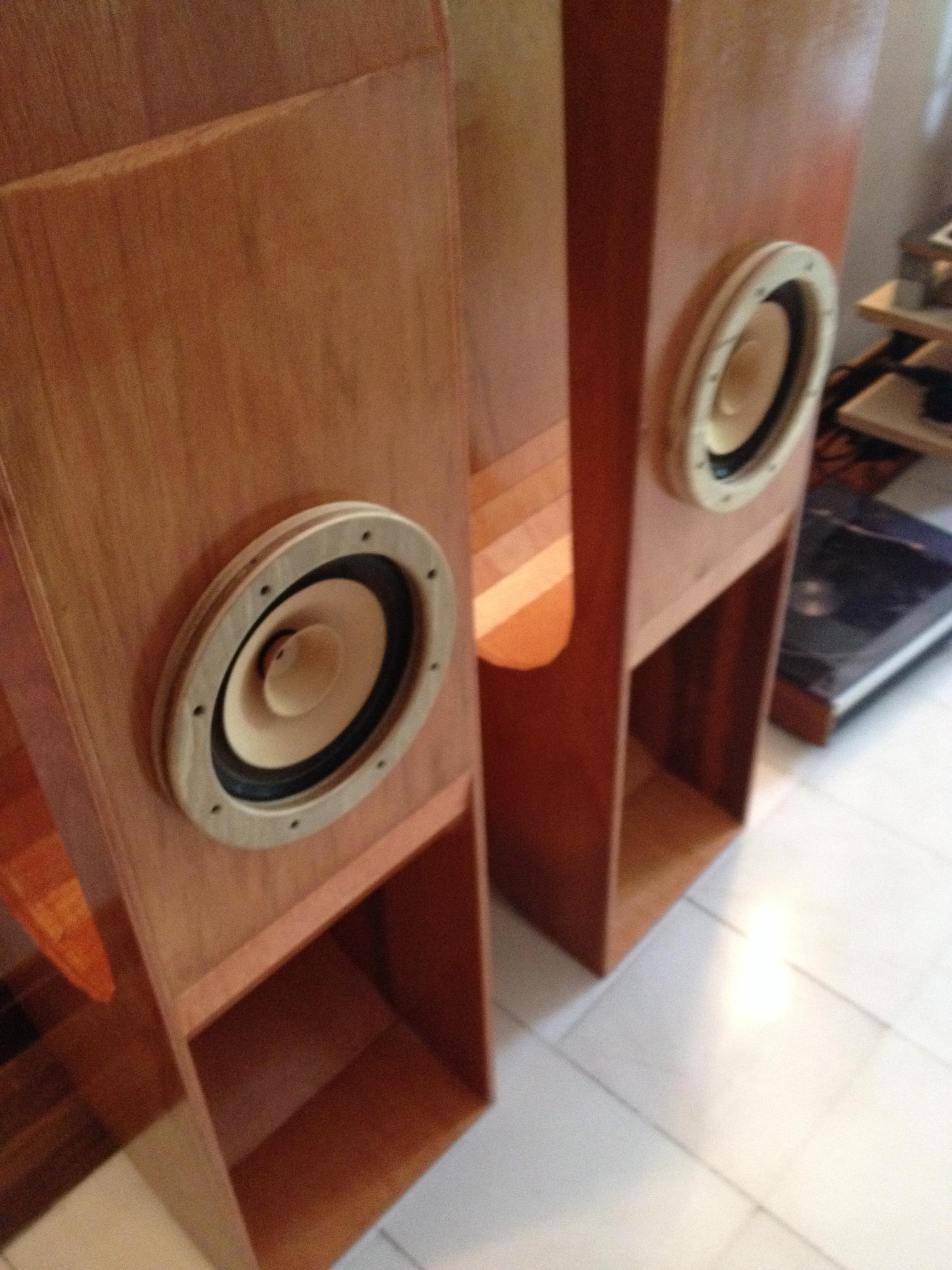

My fault for not looking at who submitted the post! Still, great looking build an nice workshop you have there.
Hi Gavin
Thank you for upload the process, I do hope you have a nice, deep and tight bass with your FE206.
Your adjustable stand inspire me, please let me know when you done.
KoHo
Great looking build there Koho.I wish I could hear it, do you have a good digital audio recorder with stereo mics? Maybe make a recording and upload some sample sound clips. I do this with all my builds so folks can get an idea when they use headphones to listen.

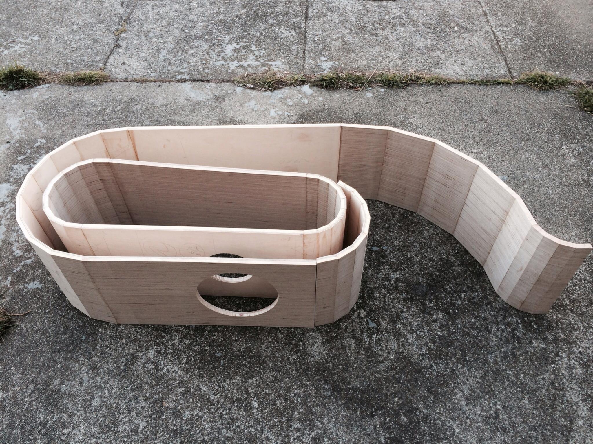

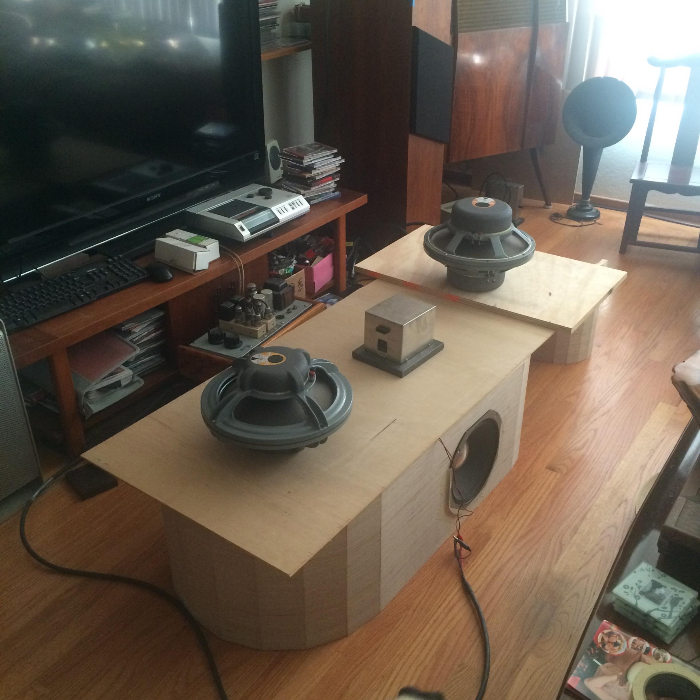

Thanks for the plan KoHo. It's actually quite simple. I might have to give this a try in my quick-and-easy foam core board. I don't have a fancy Lowther, what might you suggest as the equivalent diameter FR budget driver to use? What are the key params to try to match for driver?

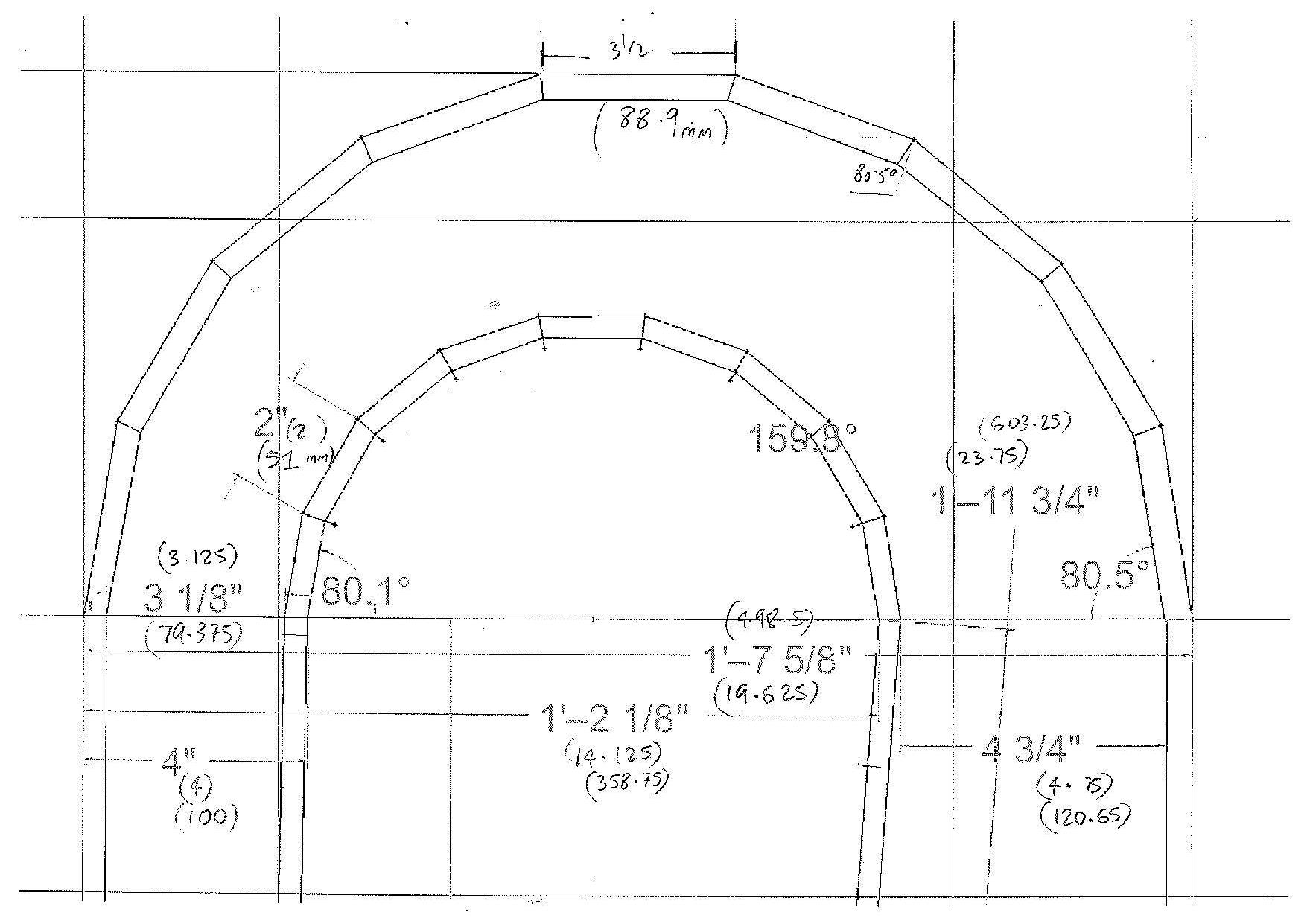

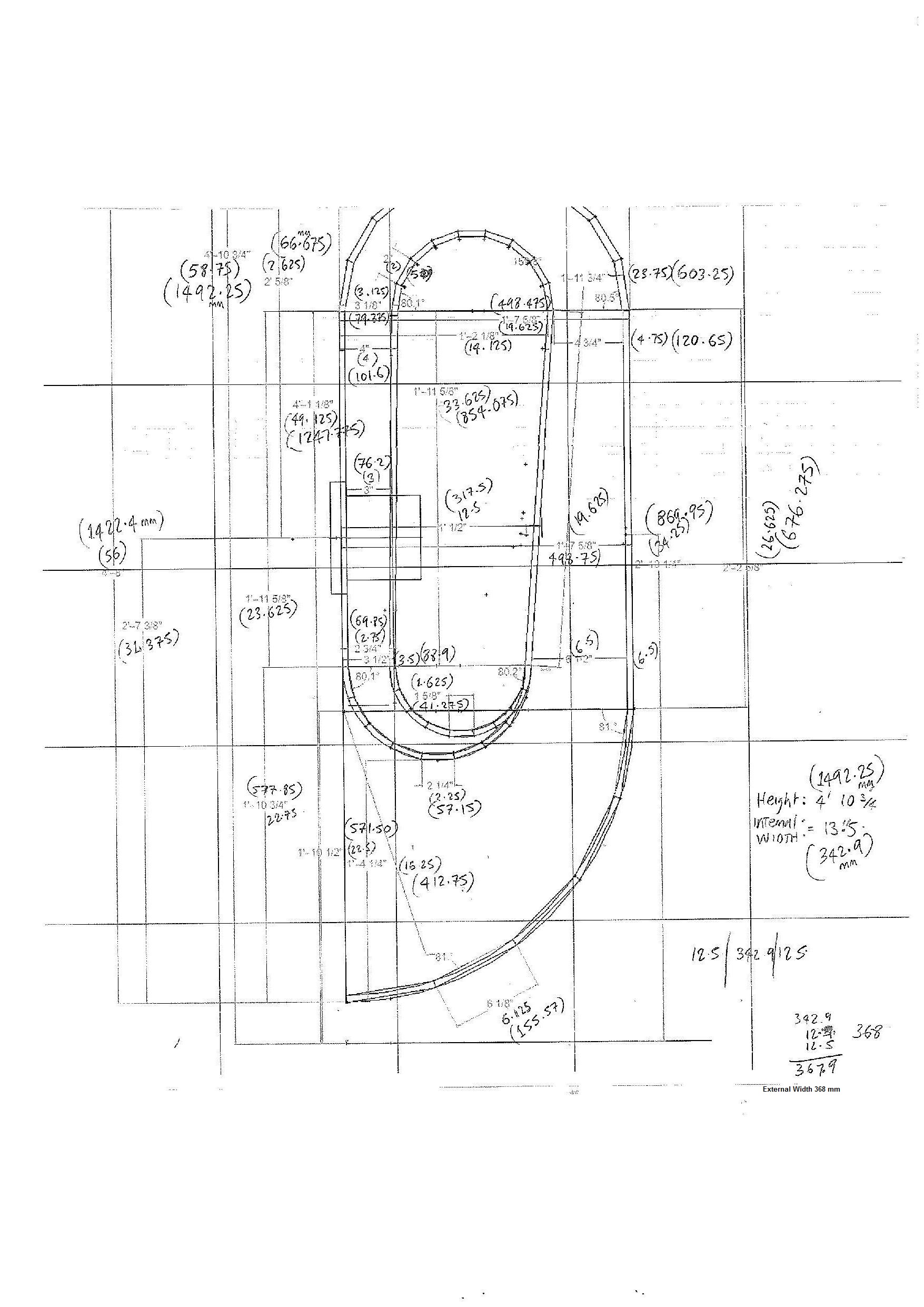

Am I right in that the newer design from post #58 is a bit narrower (13.5" vs 17") compared to the original drawing?
Anyone got any better drawings available?
The ones in post #58 is a bit hard to read...
Even better, is the drawings available in metric measurements instead of the horrible imperial measurements? 🙂
I have already started converting the measurements to mm, but the original drawings is a bit hard to read so in some places I am a bit unsure on what the numbers are actually describing.
I converted the measurements into mm and have the sketches somewhere. I will try to look for it and if I can find I will send it by direct message.

Thanks to do that, I just out of town to Canada few weeks, I can't make it.
If you don't mind just post the convert measurement to share everyone will be great!!!

Hi
I think 13.5" will good for Fostex, which high Q than my Lowther.
Hi
Thank you both for the answers! 🙂
Thanks again! 🙂
Once I start building in a couple of weeks I'll try to upload some pictures of my progress.
