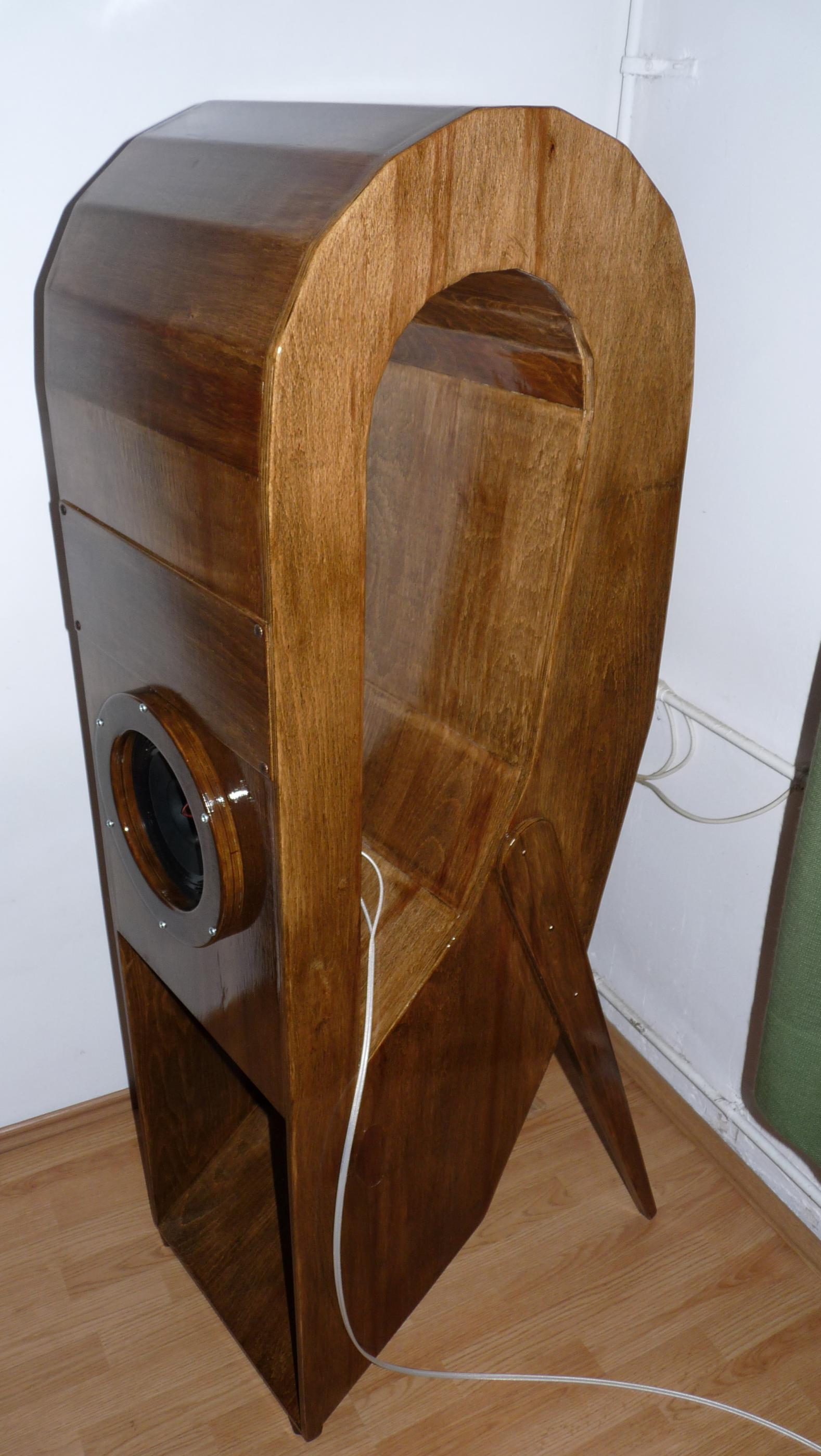

Fantastic! thank you so much for the pictures. I like that legs it gives a slimmer apperance than a box standing flat-footed on the floor.

Wow...it has finally happened that another builder would try a different driver and have it entirely inside the cab.
I'm no expert at all...why the wood surround around the driver?
How does it sound?
How does it sound?
The legs are crucial i think, to take them off the floor(like spikes to conventional speakers).I' ve intended a very small surface of contact to the floor. Those rings in front of the speakers were meant to be a kind of waveguides .
I did not measured anything, that was just my idea after reading different opinions on different forums. So, it was my conclusion.
The interesting thing is that i have listened to this speakers without floor decoupling and without the front rings and not painted ....and the difference it s huge
After finishing the sound became mature and accurate. Very dynamic , very present (with energy) in all of the ranges.
Bass is articulate and fast....yet deep enough for the majority of us. Midrange is very forward , deep in terms of stage, and with lots of details.
And now the treble...i don t think of an tweeter that could do the job better and that could integrate with the midrange that well. So, pretty damn good...
All in all ....those speakers with these "audio nirvanas" do a very good marriage...
I don't see a week spot to these speakers....highly recommended!

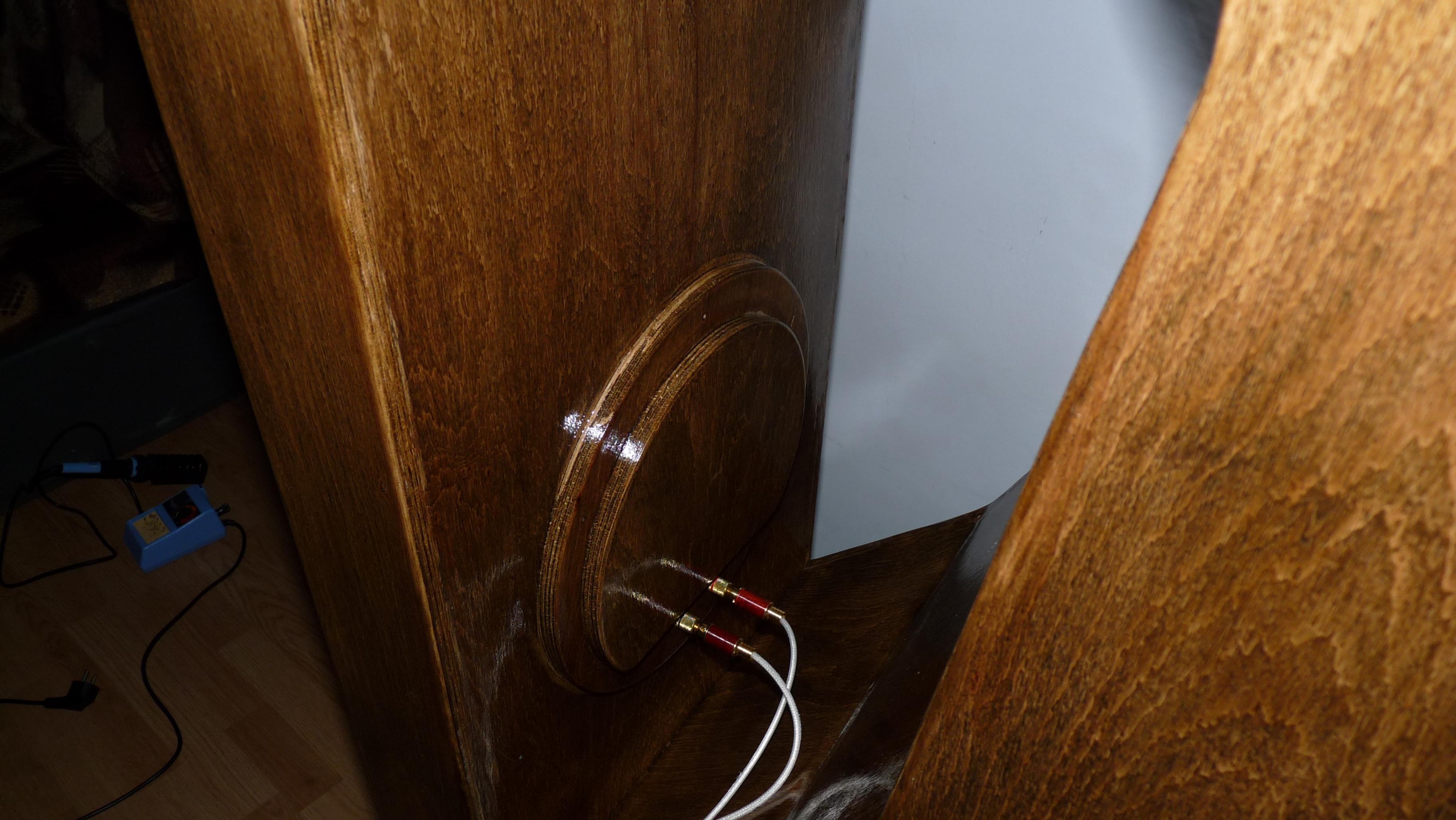

Extraordinary sound turning method!
The purpose of ring (or drive adapter) for switch different kinds of driver easily, it enhance my Lowther mid-range, like a little front loading horn help improve sound density.
And also easy to remove for sound adjustment or tuning at the throat area.

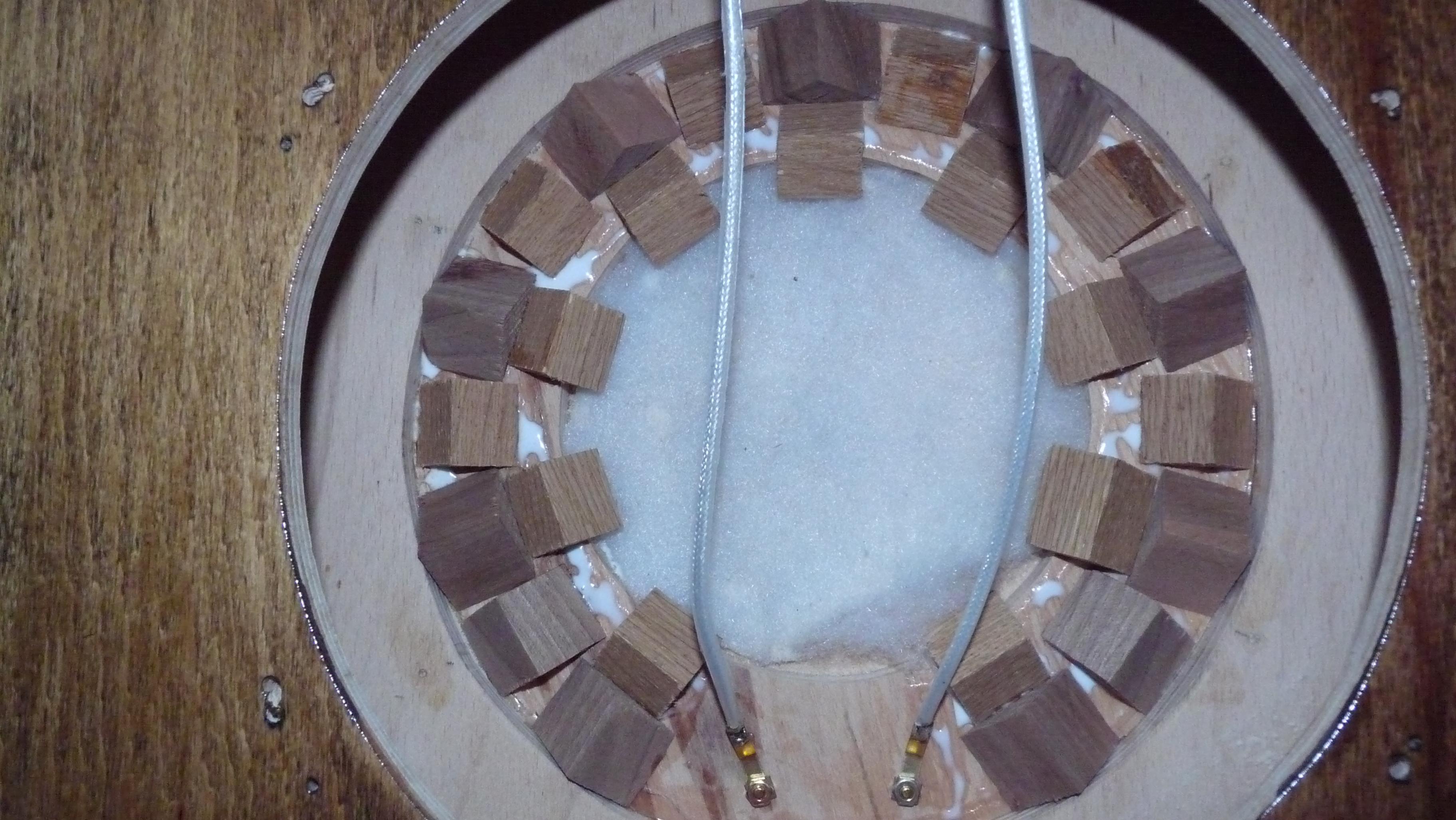

The picture it s taken from the front of the speaker...i think that fostex 206en's are a good choise for this project because audio nirvana it s made pretty much the same , and has same characteristics. I would like to try them also.
Oh I see. If the driver was in place in that photo, I would be looking directly at the cone. The foam is behind the driver.

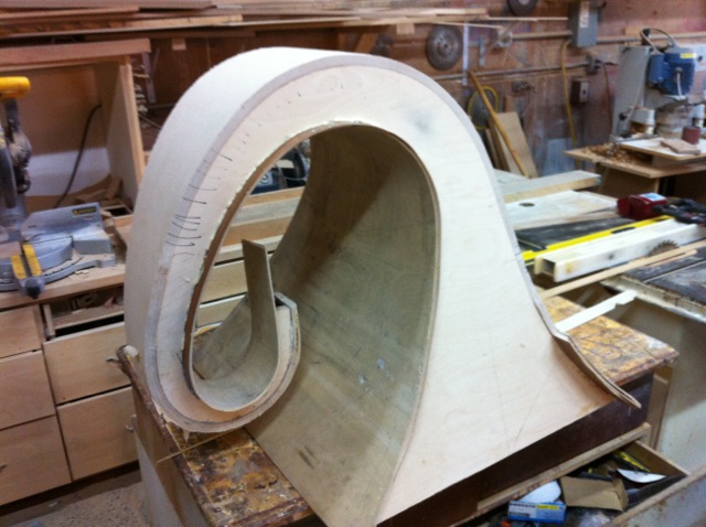

Have you thought about bent wood panels? Steam bending and kerfs could work well.

Thanks for your suggestion.

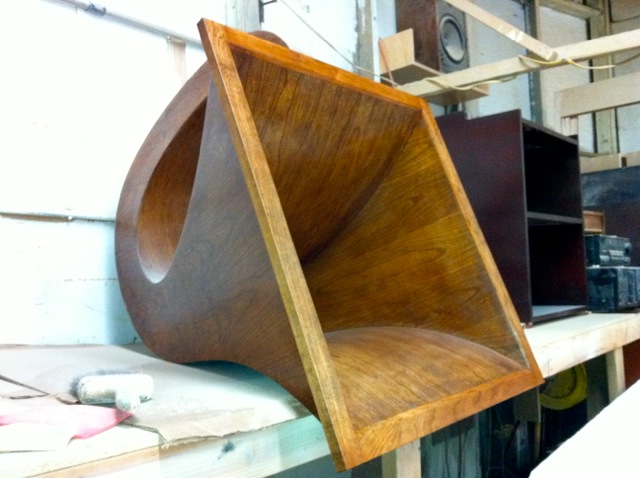

Some of my western electric 22a project about 4 years as picture show.
Bending curve have better visual effect, higher woodcraft, and smoother transmission.
By my experience, bending curve increase wood texture stiffness and harder structure, on the other hand, higher sonically resonance.
So, I think bending curve work better for front loading horn, and trend to high frequency or brighter tone.
Personally I prefer combine multi flat panel curve, the sound resonance point is much lower, the tone deeper, better used for back loading horn.
Thanks!

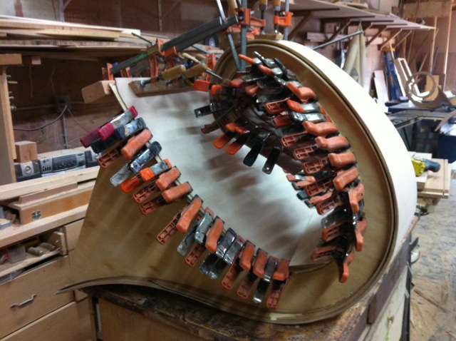

Beautiful work! Do you use bending plywood?
Thanks!

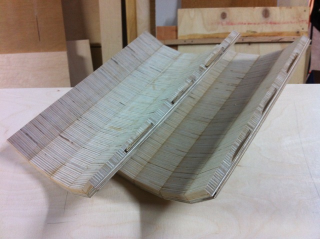

I prefer using Cut and Glue method for my new horn😀
Koho,

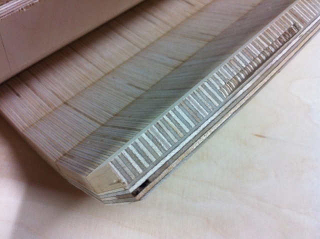

Wow! Nice work with those pieces - especially the biscuit joint slots. It looks like the wood has been saturated in some sort of resin and hardened to a plastic like material? What did you do to the plywood to get it to look like that - especially the grain direction?
X
X
Koho,
X
Thankyou!

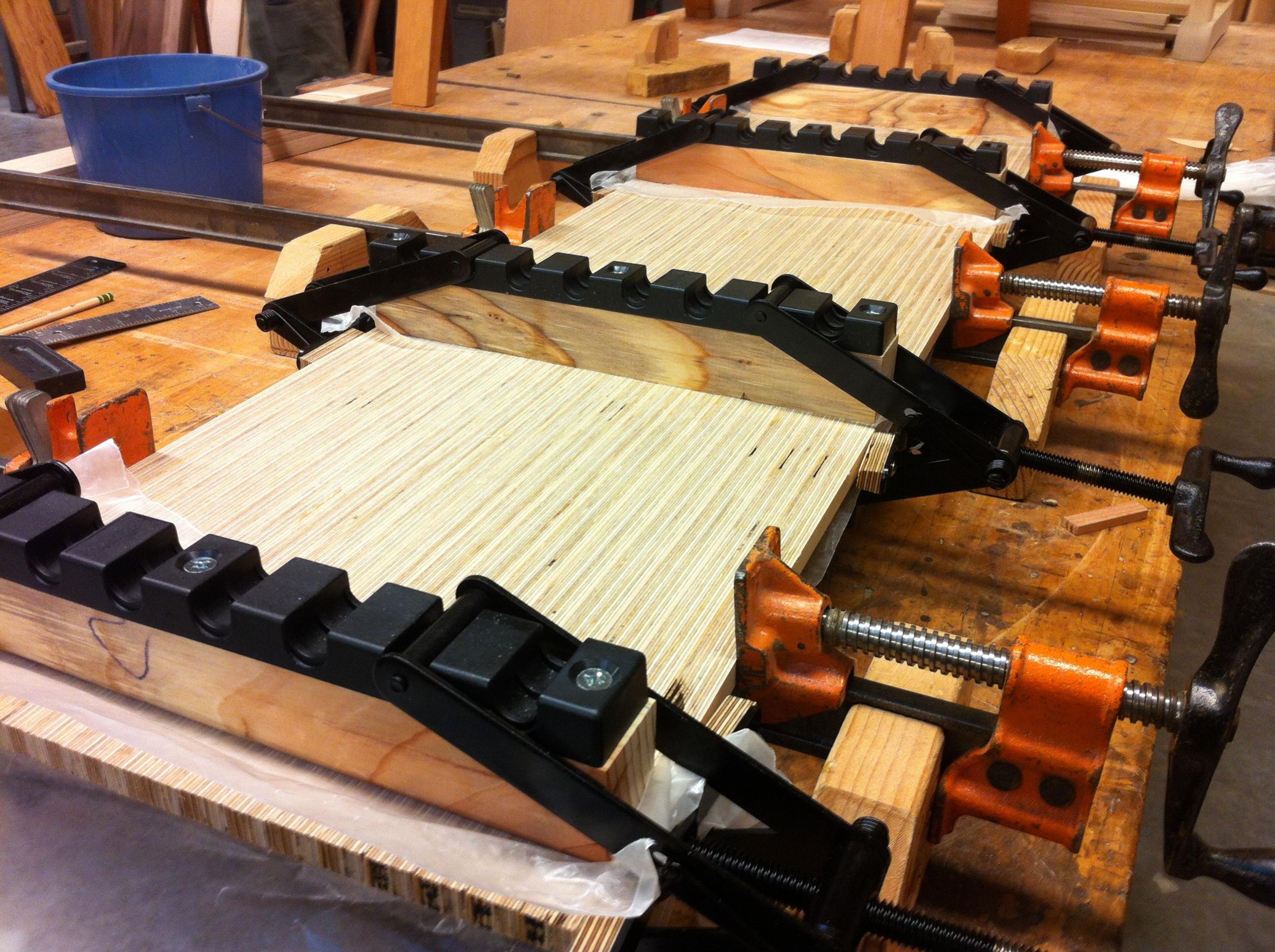

Will appy shellac on horn surface at final step.
cut plywood into 3/4 strips and put total 18 strips glue together,
I call them super-plywood😀
