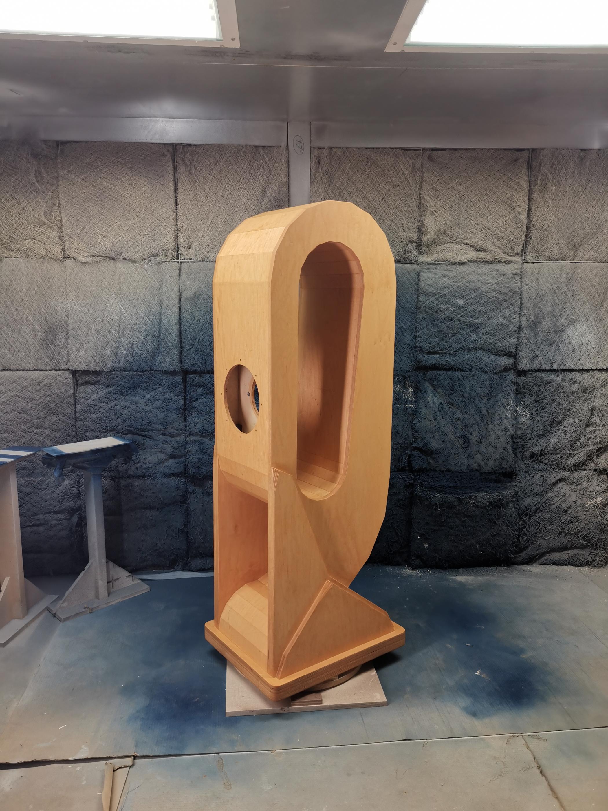

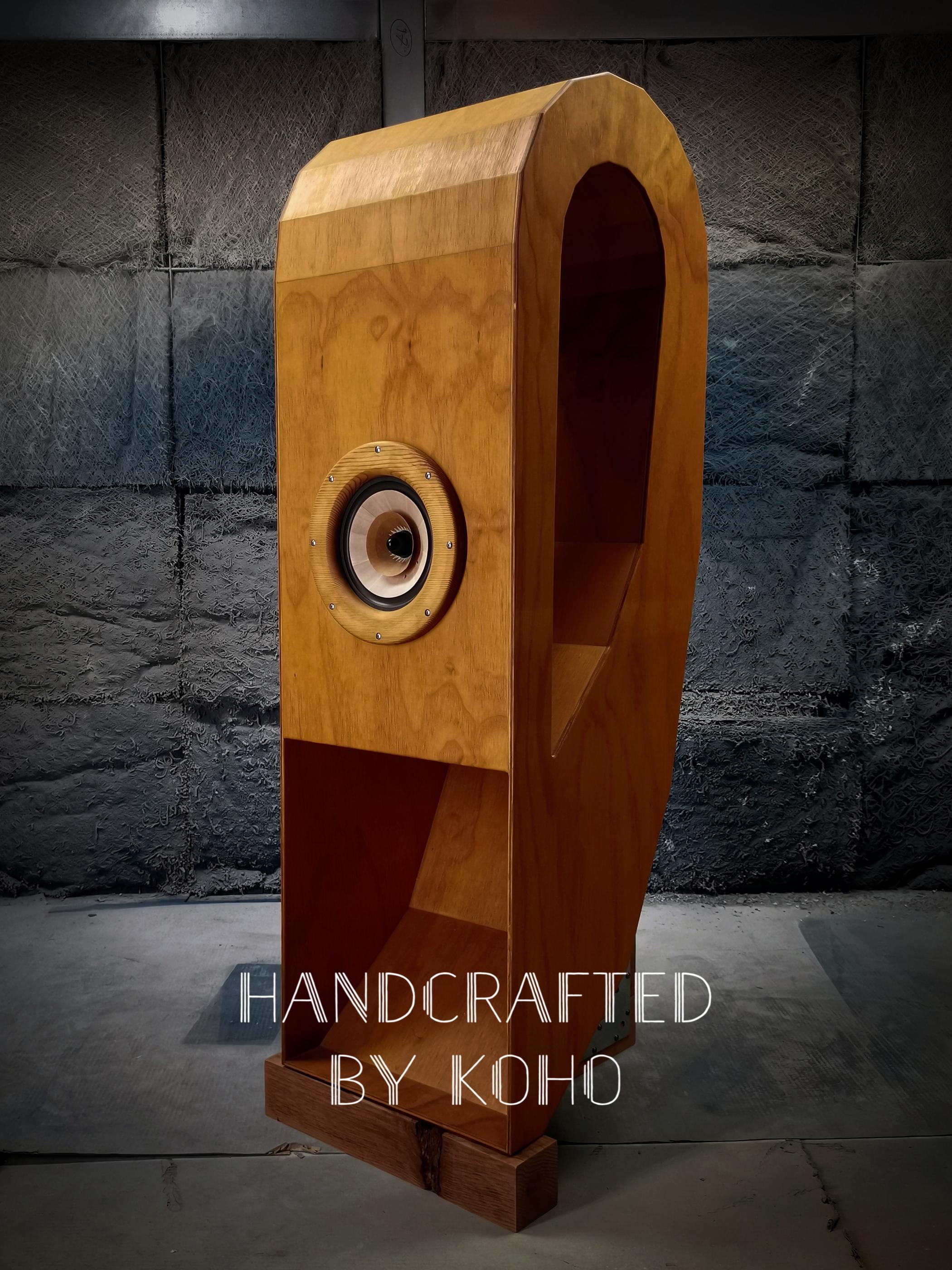

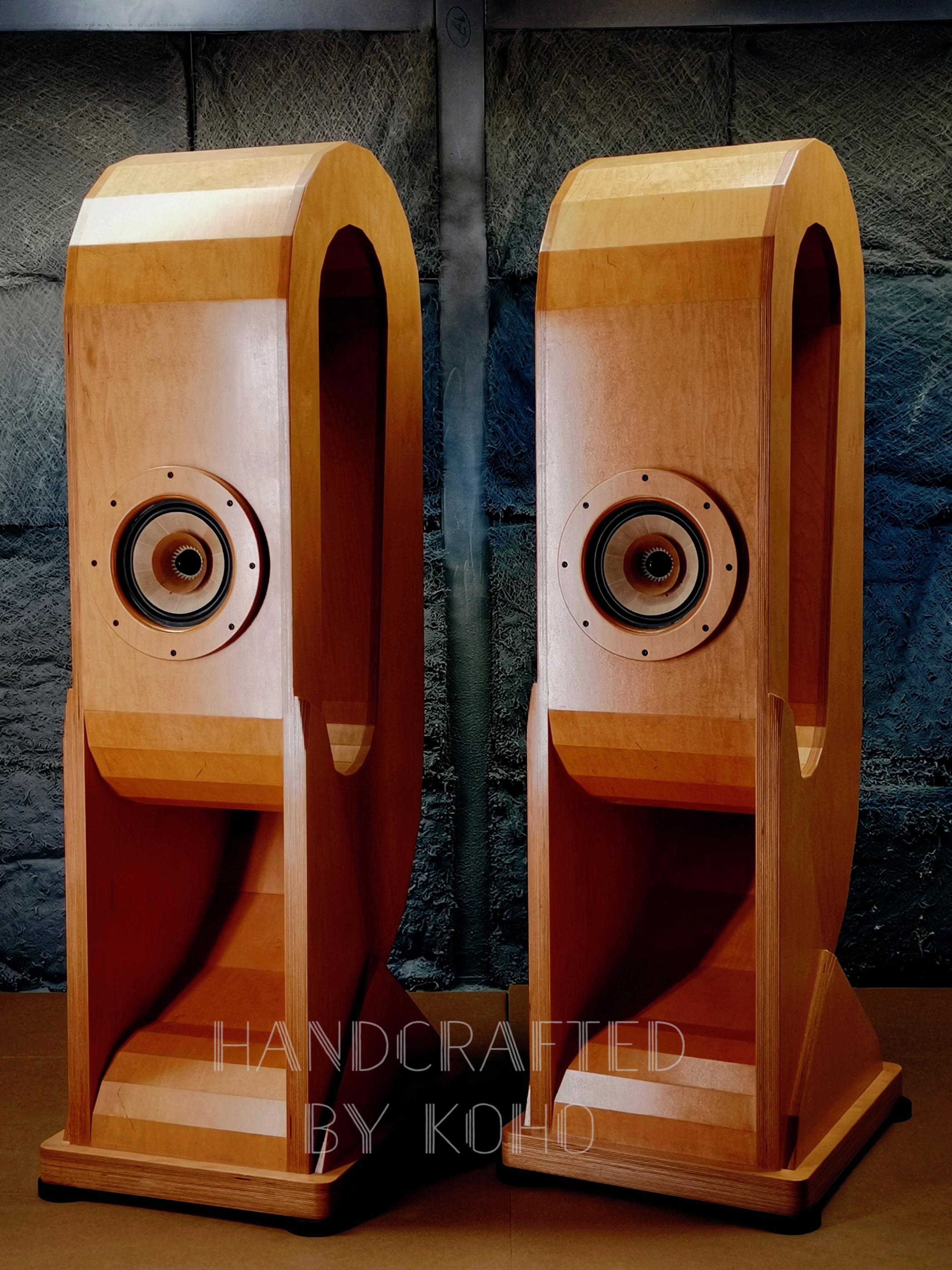

had been build last year, but some crack at sandwich panel due to the weather temperature and humidity change.
still making another with plywood

Hi KoHo, I notice you have reversed the curvature at the throat end of the folded horn?
What difference does that make, if any...?
Two things I modified
reversed the curvature at the throat,
use high quality harder multi plywood.
mid and lower frequence faster, tight and clean
and style look cool😊

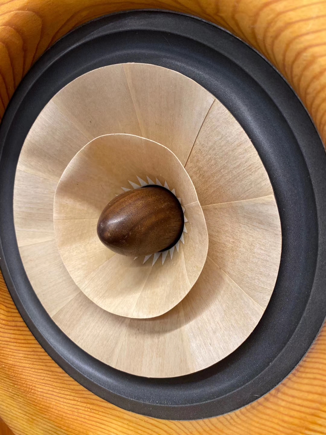

Do you have phase plugs in the FE206En??

No,i still didnt install them,but its a plan to do so.
You think its better to start with phase plugs and see what will be?

Phase plugs make a significant difference.
Adding an XO might bring more pain than joy.
There are other tricks you can do to tame the FE206 issues.
