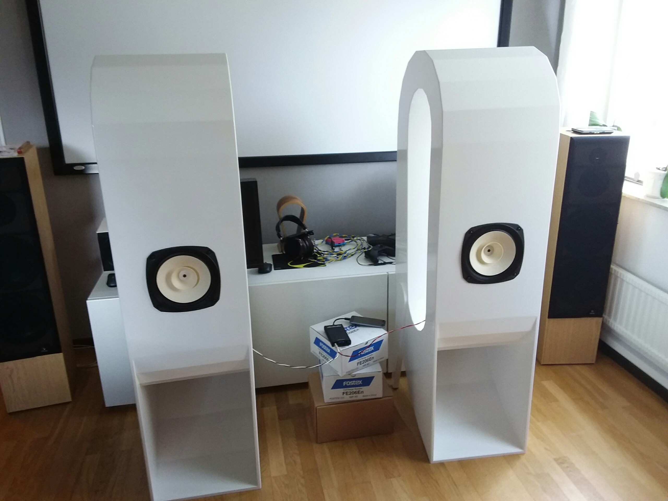

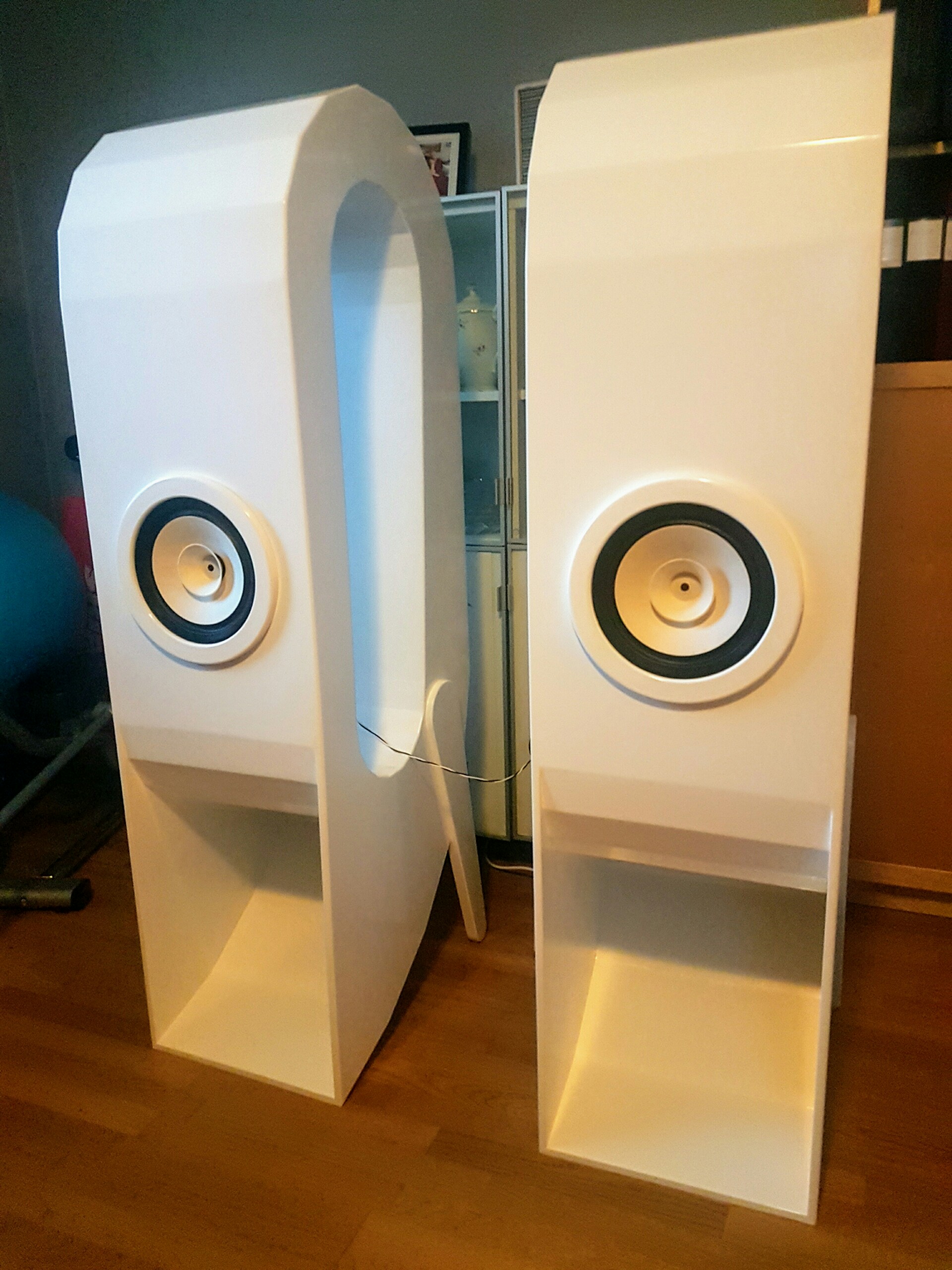

They are finally at home & playing some sweet music for me 🙂
The only remaing thing is to touch up a few scratches that my brother-in-law managed to give them when he drove them home for me, and attach the wooden rings I will have around the elements to hide the screws and metal parts of them.
I have read somewhere that the Fostex needs up to 100 hours before they start to sound really good, so I better start listening to them now!
The first song I played on them was Over The Rainbow by Israel Kamakawiwo'ole, and to my ears they already sound amazing!
A huge thanks to KoHo for sharing the drawings to these awesome horns!

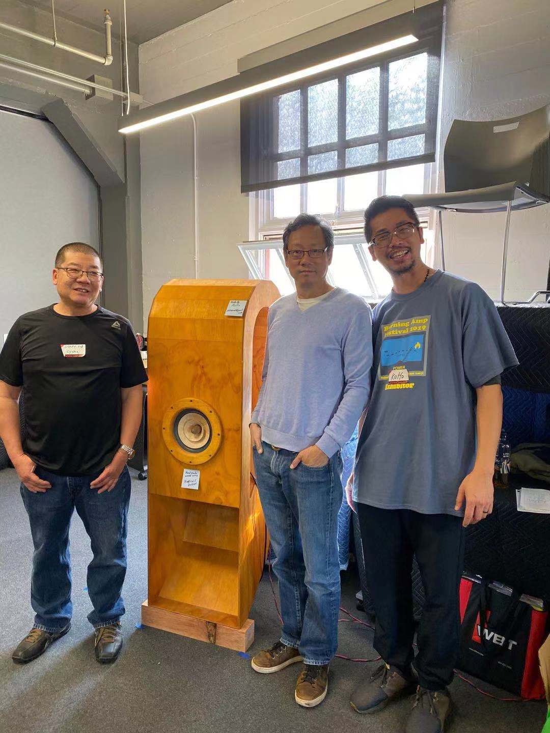

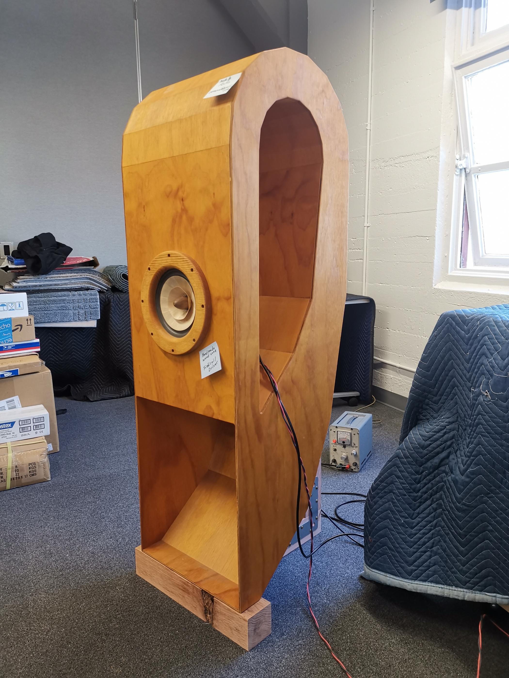

Beautiful but full Zen Acousta is floating in the air just attached by the cords.
Physical touch with the floor make horn resonate little bit differently i guess.
Yes, it's different, natural resonate.

A final update from me - I have now added the rings around the speaker elements, and the looks improved so much (at least that's what I think & my wife says) 🙂

Soft cords and not contatct with the floor are big part of Zen Acousta magic mojo.
Frequently one neglected paramenter of horns users.
Varnish, painting or natural oil can bring subtle differences to the music as well.
It's wood natural material fibres micro scale vibrations.
Violin instrument producers made lot of research about this influence.

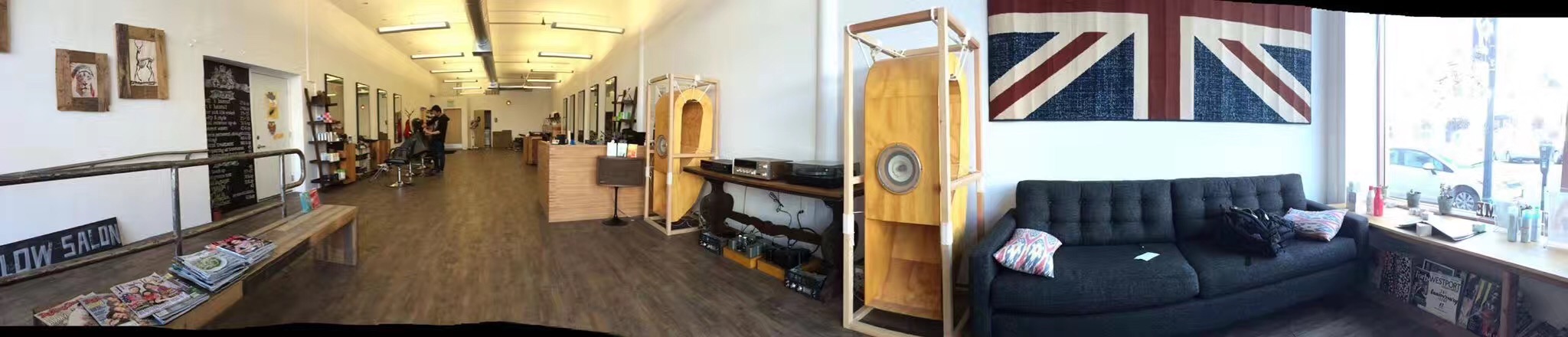

My horn now sitting at friend hair salon, some consumer asking is it violin live performance

Lucky people who visit salon and hear Your Zen Acousta.

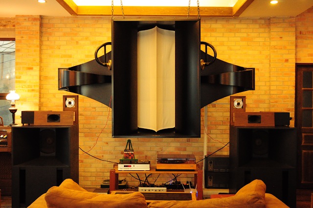

It's make me think about Audiophile coffee bar in Japan with amazing Western Electric system. I know You like it
With floating in the air WE horns all lounge bar are full of great musical emotions
Well is historical WE classic reference horns and source of inspiration
but not DIY and is made with metal.
Your wood Acousta work is more compact and Audiophile home compatible and Zen friendly
