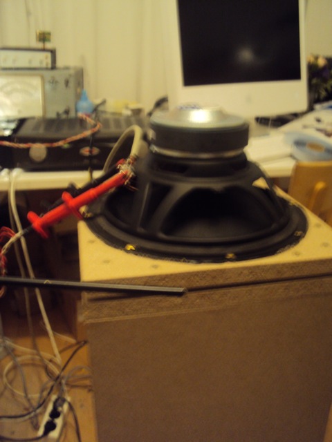

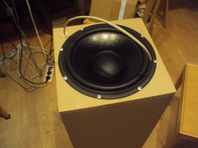

Yes, they are Peerless SLS-10 woofers.
Soon, the response was measured 2cm from the membrane of the top woofer. I used Praxis flex window option so the response is smoothed by a flexible window. I measured also in 50cm distance and that looked good too.
I build speakers with and without woofers close to the floor and also speakers that have woofers spread vertically and horizontally. There may be other reasons then the floor bounce why speakers with woofers close to the floor sound diffent. I think the floor bounce is not a big problem aurally. It ocures all the time when a natural instrument is playing. It can also be reduced somewhat by using damping material on the floor.
I measured the woofer again after 2 hours on break in. Qts is now a bit over 0.8 and fundamental resonance is at 40Hz. I think more break in will get the cabinet up to target and we are set.

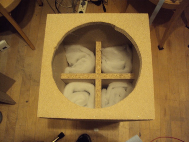

Your drivers are mounted very close to the sidewalls of your enclosure, and seeing as I've found that mounting midrange drivers too close to the speaker cabinet's walls causes standing waves to be more readily fed back through the driver's cones, I would wonder if the same would hold true with the lower frequencies of bass drivers.
The cabinet is so small that standing waves can not happen in the passband. There is only preasure. At higher frequencies the damping material is very effective. If there whould be standing waves or cabinet resonances it whould show in the impedance curve as wrincles but there are no. The cone breakup is visiible over 2kHz so the impedance curve is a good measure of resonances. It is like "looking" into the cabinet.
Thank you for your explanation. What you say makes a lot of sense, but I'm a bit stubborn sometimes and I'm still thinking that the close walls would have some type an influence on the cone. Perhaps someday I'll cobble up a pair of bass cabinets - one with close walls and one without - and do an A/B listening comparison to see for myself if there are any audible effects.
Yes, the bigger cabinet will cause you more trouble. Small box: small trouble, big box: big trouble; Peter Walker.

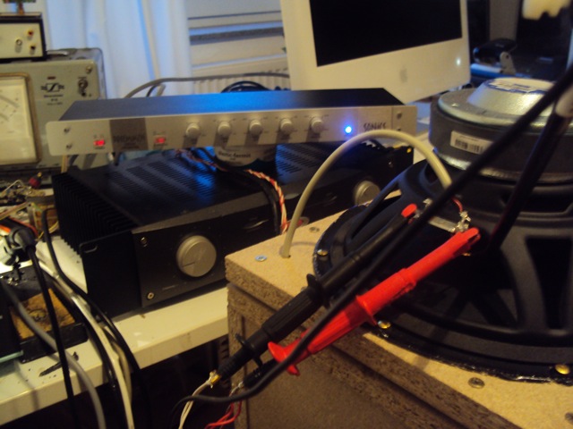

I did some more work on the ZDL woofer. i will use it with an active crossover. Amp power got cheep so did active crossovers for example from Reckhorn. A deep crossover needs big coils and caps and besides the losses those parts are not cheep so actually an active version will not be more expensive but much better performing. For the measurements shown i used a Sonics Drömmen crossover i did some yeras ago based on the Thomessen that is unfortunately not availlabe any more but there are good substitudes. See the result i got with and without EQ. Rolloff is 12B/Oct. and there is no sight of a resonance. So far for CMP behaviour of an Isobaric.
Soon, i will not win a volume contest and the EQ is optional. Remember, this is for nearfield. The woofer has decent excursion. I whould say 20mm P-P without making much noise.
