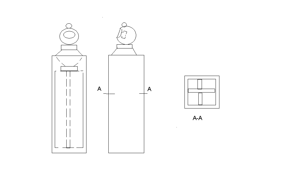

I am asembling the woofer cabinets and will publish photos soon.
Still my invitation stands to listen at my place when all is well and done.
I am coming forward well.
Later i will publish a small drawing how it will look.

Joachim, please tell us more about the construction of the TDL woofer and enclosure!
Will this creation be coming to Berkley California for an audition?

It´s a closed cabinet isobaric. Around 45 liter in volume, about 85cm high. There is a stiffening cross and the magnet of the inner woofer will be pressed against this cross.
I have some rubber sealant that i will put between the magnet and the cross. The down woofer will be screwd from inside to the top board and the upper woofer will be mounted from above. In between is a venting hole so that the woofers are pneumatically coupled. Back in the early 80th i have build my last isobaic and i foud that the volume between the woofers can cause some trouble. I found the less volume the better so i may put some suspended styrofoam between the woofers or something else. Maybe some damping material is enough. I have to find out. Putting the woffers vertically has a disadvantage because of gravitation but the woofers have a rather stiff suspension and the trapped air in the closed cabinet may help too.
This is not a commercial product so it is unlikely that it will make it to Berkeley. Shipping is rather expensive and i have to make a packaging.
Anyway, it is not that expensive to build and i may build one while i am there.
