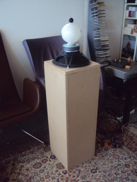

I'd be interested in seeing measurements of the midrange alone vs. measured when positioned above the woofer and box.At least here are photos of 2 mockups i made. Over 900 posts for something as unspectacular as this. Sorry, i am slow.

Looks like posts of a front gate.😀At least here are photos of 2 mockups i made. Over 900 posts for something as unspectacular as this. Sorry, i am slow.

The fishing floats could hang from the ceiling in fish nets. Kind of a nautical theme.
Or the balls could also serve as lamp bases sitting on woofer boxes that are also coffee tables.

Today i finished one Isobaric Woofer. I am happy to report that i did not run into unexpected problems. No combfiltering, no wrincles in the impedance curve even without any obstacles or damping material between the woofers. I made sure that the cabinet is airtight. I used butyl rubber strips from Mundorf. The cabinet has a stiffening cross and the internal woofer is pressed against this cross with a piece of chipboard and stiff paper.
The frequency response is rather flat untill 1kHz, much more then i need. Even a two way whould be posible with a tweeter that goes down deep enough. Ots is a bit high at 0.9 but the woofers have not being run in. I do that over night and measure again tomorrow. In room i can hear decent ouput from 32 Hz on and that is fine considering the rather small cabinet. I did a sweep from 12 to 300Hz and could not hear any rattling or such that comes directly from the Isobaric. The room resonance of my lab at 79Hz and some stuff rattling in the room was much louder then what comes from the woofer so i expect a rather clean sound.
