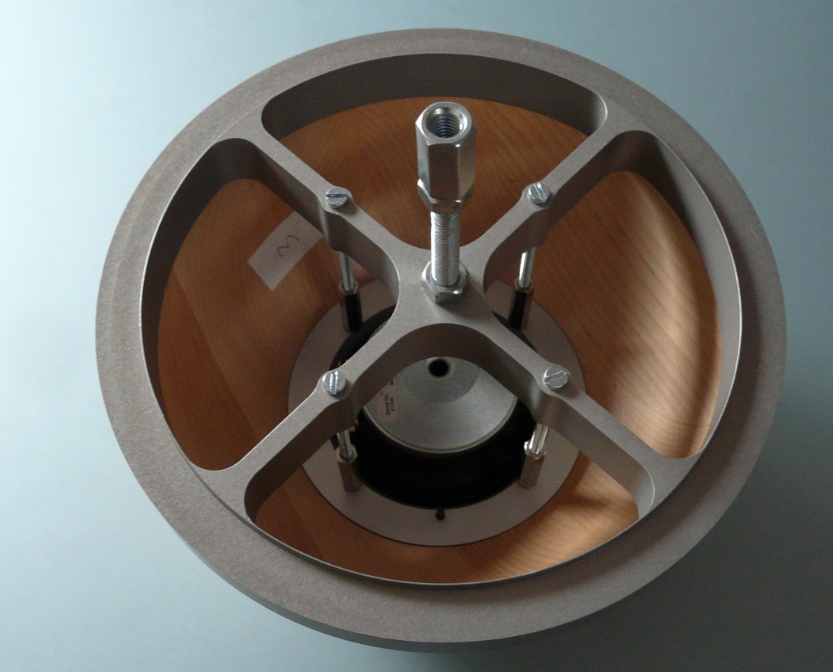

I will now put the Scan Speak drivers into the modified Ikea spheres. I have just ordered the missing screws, washers etc.

This is how it looks inside...
