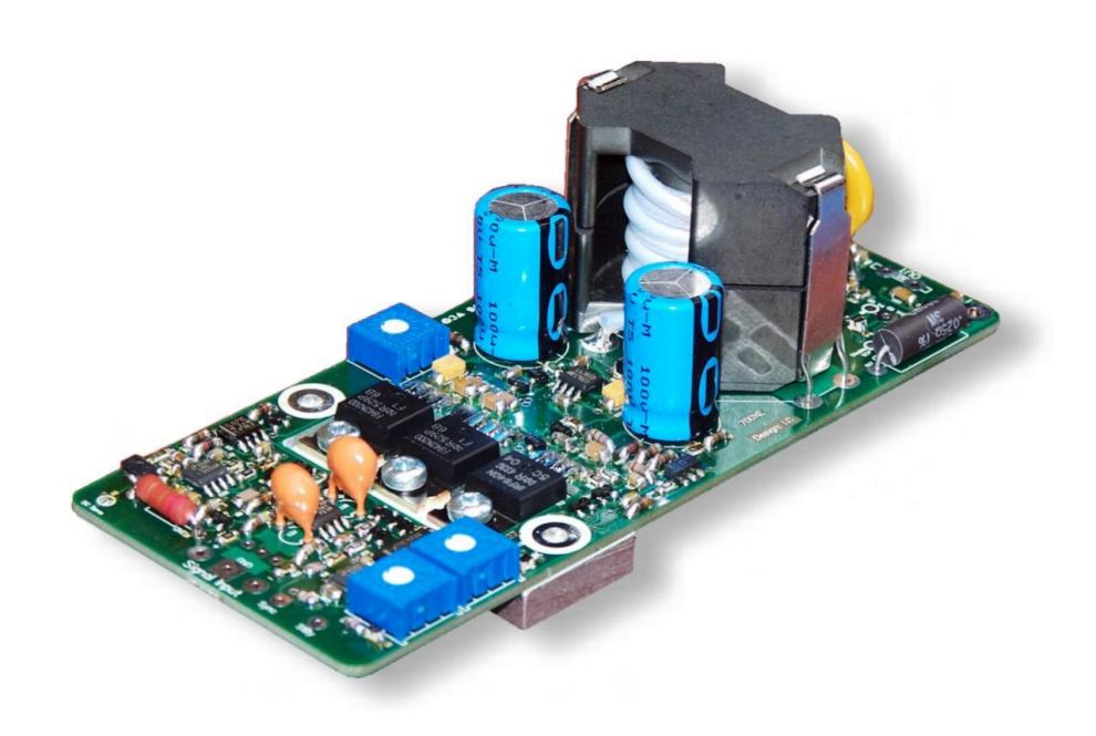

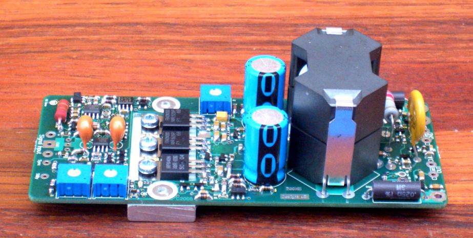

First sneak preview of the 700XE. Please see photo below.
Measurements of the new improved 700XE will also be posted soon.
I went to L C Audio head office today to check out the new XE, and my first impressions were good.
So far i can say it is very low on noise, compared with earlier ZAP's when running and also when turning on the power. Even when you have your ear in the loudspeaker you hear absolute silence.

Lars Clausen said:First sneak preview of the 700XE. Please see photo below.
Hi Lars:
The ZP700XE looks very nice and tidy indeed. 🙂
Is it as silent or more silent then you expected?
Keep us posted on your impressions ... and what developments have you had with the SMPS that you have been working on? 😀
