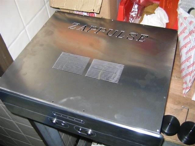

hello,
here some photos about my amp
It is not finished, i must do the treatment: anodization .
Seb
Seb

Cobra2 said:Great chassi!
Would you make me one too?
Arne K
Hi vroum90
I "second" what Cobra2 posted.
Sensational!
Re: Wow...
Thank you 😉
It take me 25 hours to do it . I will put another pictures tomorrow.
Seb
Arne K
Thank you 😉
Seb
