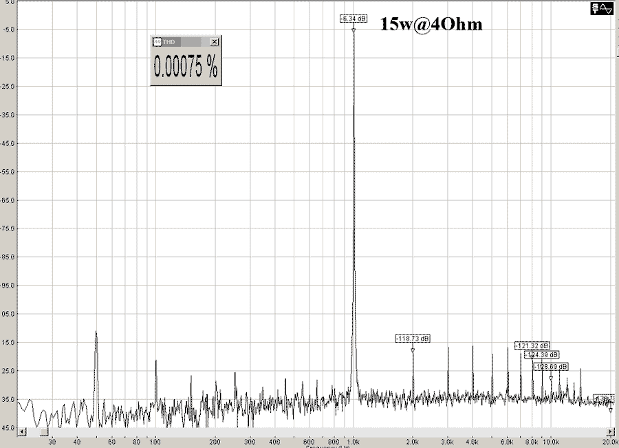

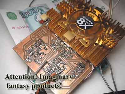

Lars, if you don't work for lcaudio anymore, so maybe "700xe" developed not by you personally? BTW, "Lowest THD in the industry!" etc, what about -3db(350W@4ohm) THD? If claimed only 1,10 or 100w level, then i'll (sure that Bruno can better else) win the "700xe" too easy (.00075%@15w/4ohm .0014%@25w THD/Freq=Flat), with the TDA8939 in the any variations - UcD or hystersis based modulator.😎
Hello Ivan.
It's true i don't work in L C Audio anymore. But i did finish the dev work on the 700XE before i left, so it's all mine 😉
About 'lowest THD in the industry' i did comparison of all the commercially available amplifiers i could find on the market, and compared with them. On this field the 700XE does have the lowest THD in the industry.
Of course i cant speak for all the imaginary fantasy products on the forum 😉 Or can you tell me where i can buy that amplifier you are referring to in your post?

Lars Clausen said:Or can you tell me where i can buy that amplifier you are referring to in your post?
In the same place where we could be buy all others imaginary fantasy products (eg "700XE") 😉 i guess in the future? 🙂)) Actually, PRO must be able to fast detect degree of the claiming realism, and they will not see something wrong here. I'm still just a DIYer, but i expect, that "700XE" will give much more THD at 350w/4ohm vs .015%@100w, and THD/FREQ will not flat. So what, .5%? Again?
