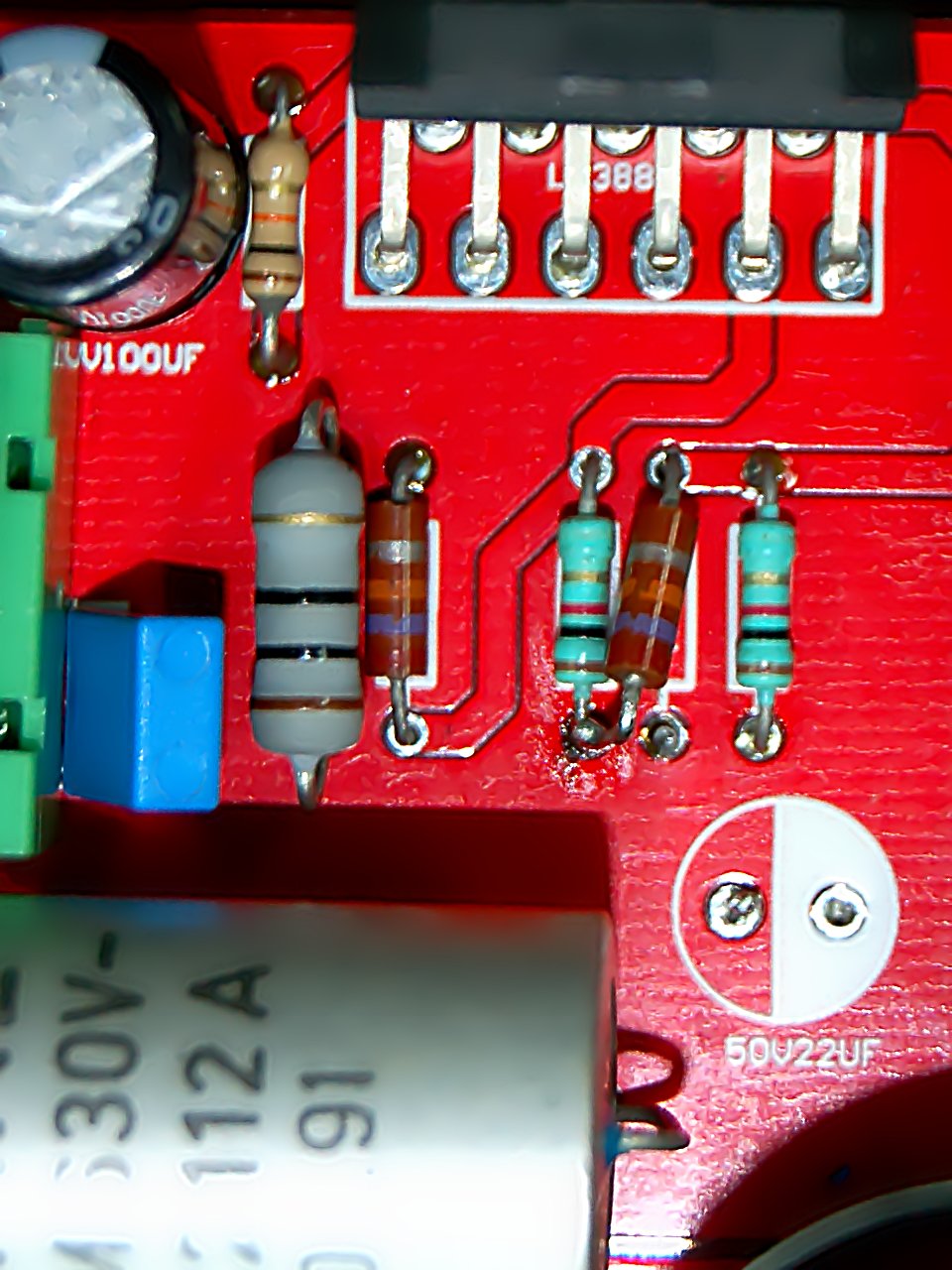

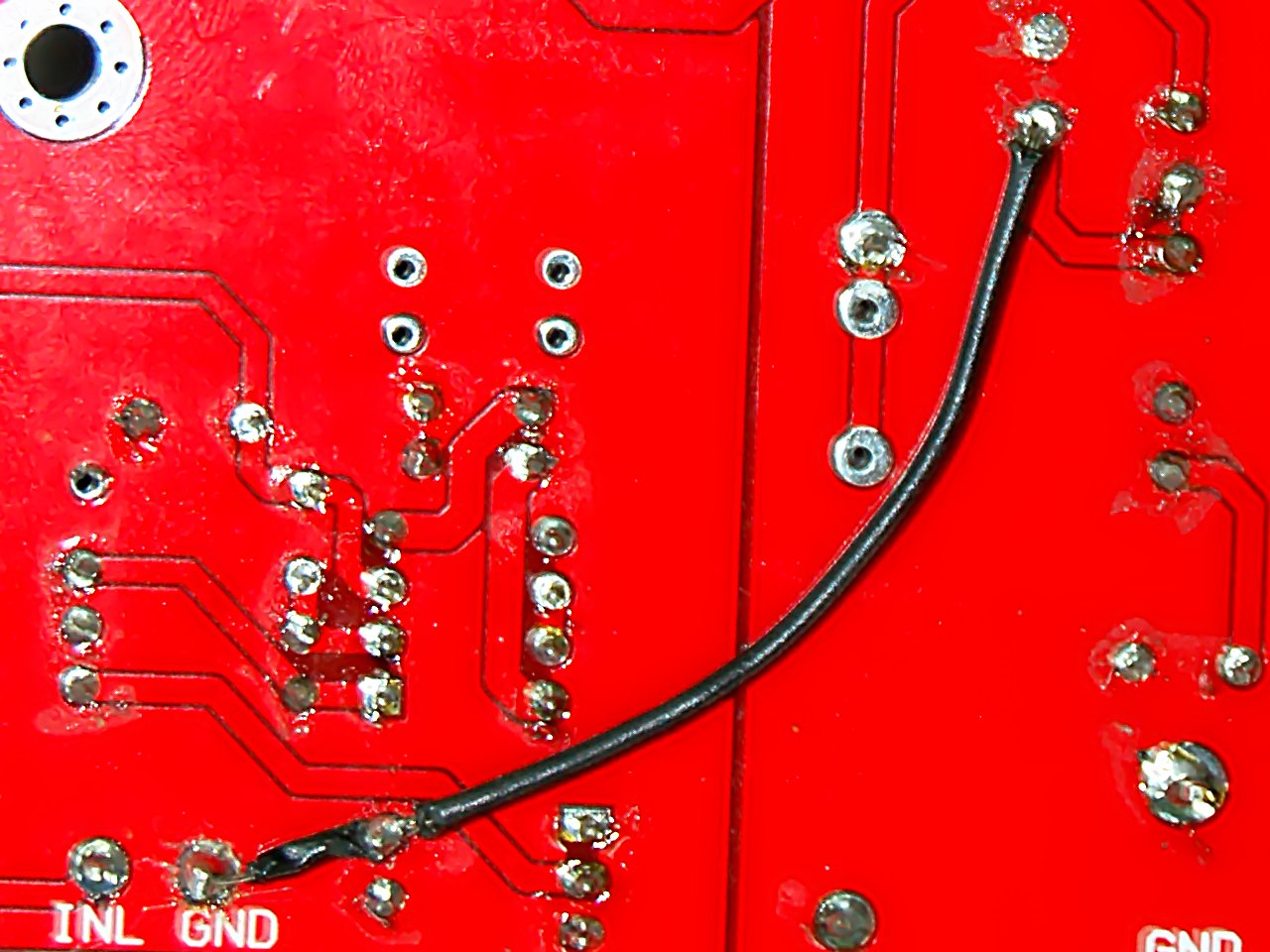

Another set of mods (yeah, I'm getting obsessed with improving this cheap amp), extending the lifted-ground concept to the LM3886 section. The aim of this mod is to greatly reduce the effect of ground bounce (in particular, the ground return current from the speakers) on the small-signal resistor-networks near the LM3886, which are grounded at two locations in the middle of the return plane. This mod lifts those two grounds and jumpers it to the previously-created lifted ground of the NE5532 preamp/buffer.
Caution: this mod will increase the output offset at the LM3886 output, which I measured to be between 100 mV - 200 mV. If this bothers you, *stop right here* and don't attempt this mod!
Pre-requisite: The previous lifted-ground mod for the NE5532 preamp/buffer.
1) Remove the DC-blocking capacitor in the voltage-series feedback network of the LM3886. This is shown to be 22 uF, 50V on the silkscreen.
2) Lift the grounded end of the input shunt resistor (22k or 27k as the case may be) and bridge it to the adjacent 1k resistor of the voltage-series feedback network. This node is the newly-created lifted-ground for the LM3886.
3) Jumper the lifted-ground of the LM3886 to the lifted ground of the NE5532 with an insulated piece of hook-up wire on the solder side of the board.
The pictures attached below show the mods for one channel:
