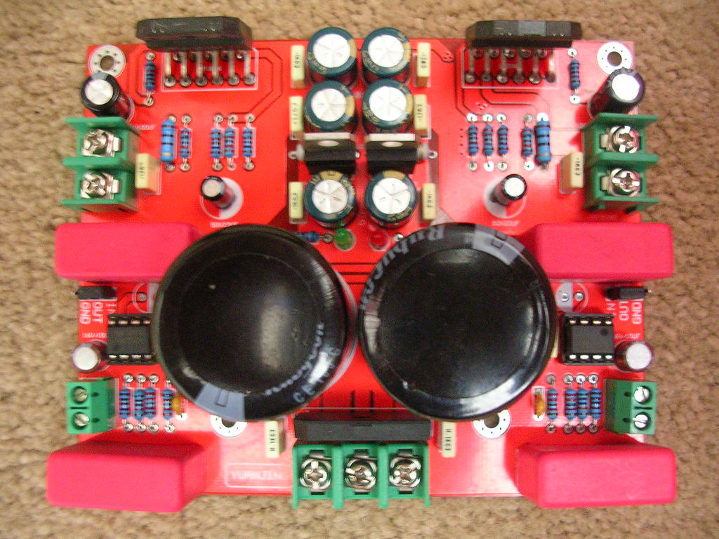

I have one of those Yuanjing 3886 Gainclones from ebay. Some things I have noticed from it's component's. On those 10000uF capacitors reads Rubycon USR 105C, but as USR series is 85C only, they seem to be fakes. Also couldn't find Wima MKP4 1.8uF from datasheet, only 1.5uF and 2.2uF, so they are probably also fakes. Makes you wonder if there are more fake parts in it. Haven't try amp yet, as I don't have PSU for it.
I did notice some were fakes so I guess the ic's are also, but it sounds very good. Unfortunatly the real companies are losing revenue and the amp might not last long!

I think that many of these super cheap units are assembled using faked components (ie falsely branded) and recycled parts.

There are a lot of people talking about fakes, but my first gainclone was built about 2 years ago and still going strong. The Yuanjing has been running full pelt for a couple of weeks and sounds great. All the parts look real and perform superbly. I hope the goldmund is the same. I tend to think it will be.

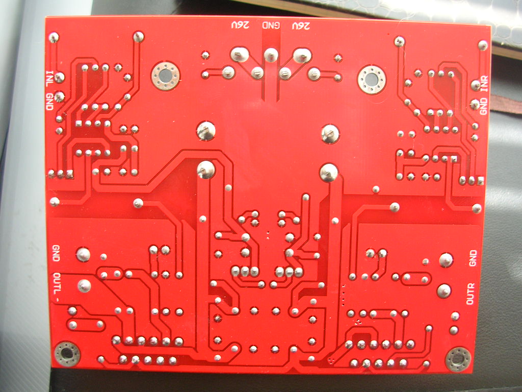

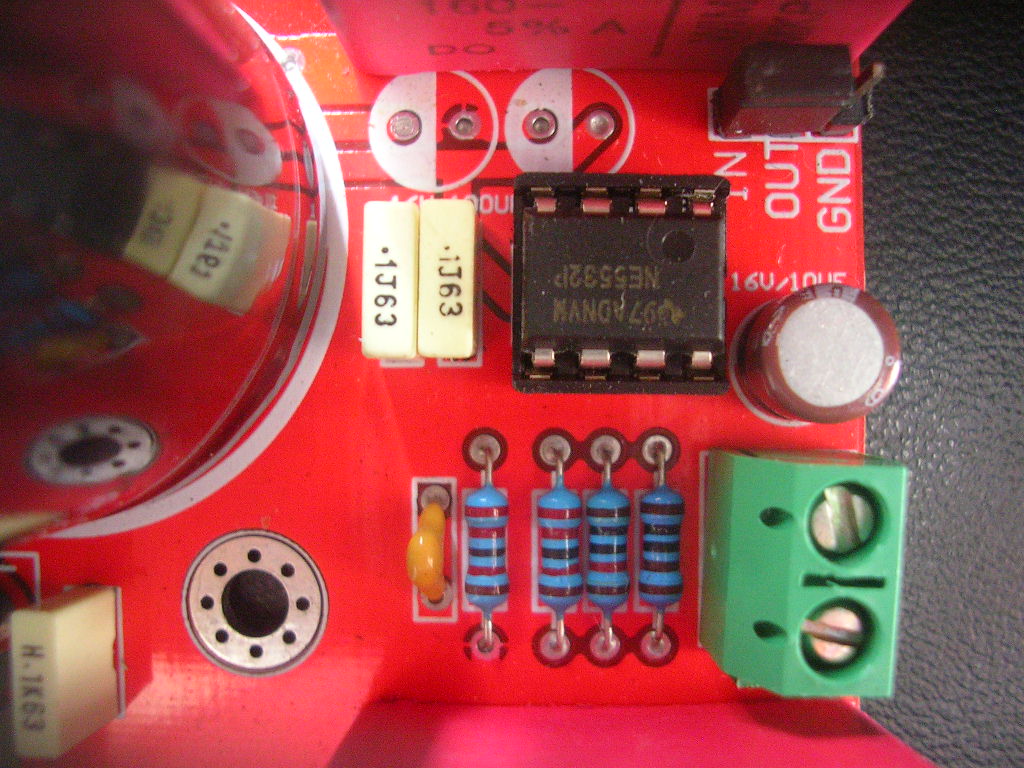

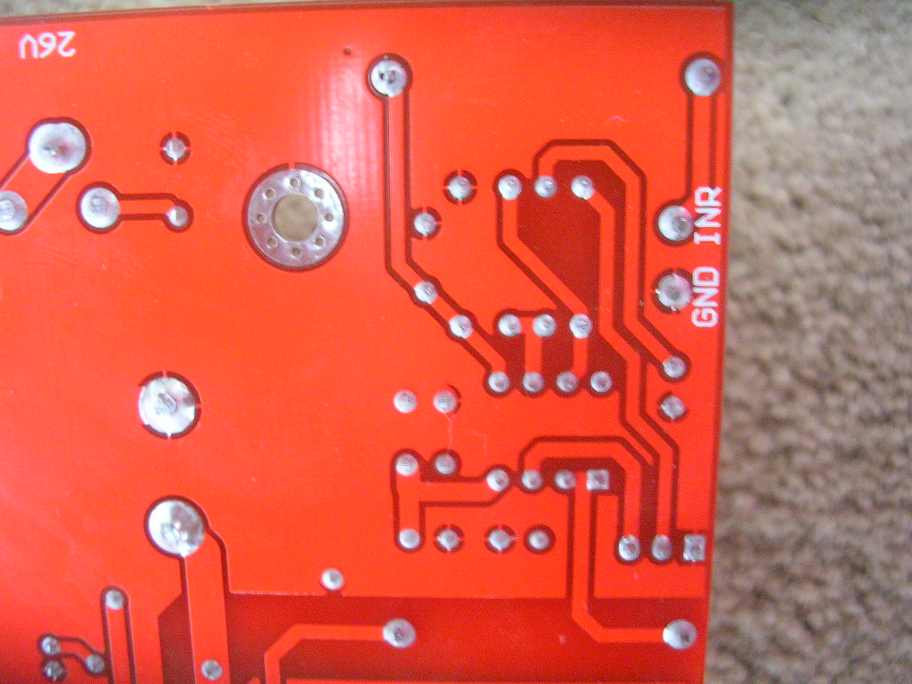

Further to your previous mod suggestions (that applied to pdb version) I have uploaded some photos of the ready built module.It would be great if you could offer similar advice eg ground lift for this amp.Reasons why would be appreciated so we can all learn!
Thanks for the pics - I compared it closely with mine, and they're very similar near the NE5532 socket. The placement and orientation of some components has changed, but the circuit is logically identical.
Here are the mods to the input buffer:
1) Locate the 22k resistor between the non-inv input and ground (this is next to the small RF suppression cap). Disconnect it on the ground side and diagonally bridge it over the adjacent 22k resistor, and connect it to the 10k resistor (exactly as I posted earlier).
2) (optional) Instead of 22k resistors, use 47k for both the input side and the adjacent feedback resistor. That changes the gain of the input stage to 5.7 from 3.2, which I found more useful for certain signal sources, including portable MP3 players and the like.
3) The orientation of the 10uF DC-blocking cap on the NFB side has changed - this is probably what led to the confusion (it has been rotated by 90 degrees). Remove the cap, and replace it with a 10 ohm, 1W resistor (metal oxide or whatever may be lying around - the value isn't critical, anywhere from 2.2 to 22 ohms should work. Try to use the same value for both channels).
Here is the critical part: This ground-lift resistor is mounted vertically. One lead is going to be bent over, and the resistor will fit into the same footprint as the cap that was removed. ** This bent (exposed) lead will face the input connector on your board **. That is, the exposed lead will connect to the trace that leads to the 10k resistor in the feedback network.
The exposed lead is the lifted ground, and both the input resistor from the non-inv input, as well as the 10k resistor from the inv input of the the op-amp are grounded at this net. Check your soldering carefully when this done.
4) The shielded ground of the shielded cable from RCA input socket (at the cabinet) is removed from the ground of the (adjacent) input connector and attached (soldered) to the exposed lead of the 10 ohm ground-loop breaker (lifted ground).
(This is a kludge, but it can't be helped. There's no way to route the newly-created lifted-ground to the adjacent input connector - the ground on the input connector is connected to the ground plane on both sides of the PCB. Maybe you could remove the input connector and painstakingly separate the ground pad from the ground plane with an Exacto knife on *both* sides of the PCB, and then put a small jumper between the lifted-ground and the ground pad on the input connector. I'll leave that to you - it's messy because of a large copper area between the pad and the ground plane on the solder side.)
That should do it - check and re-check all joints carefully for shorts and continuity before powering on.

Be carefull as these boards do vary, attempted the linuxguru mods (post #34) resulting in a horrendous screeching hum and one knackered speaker!(Boards are cheap ................................speakers expensive!)Thanks for the pics - I compared it closely with mine, and they're very similar near the NE5532 socket. The placement and orientation of some components has changed, but the circuit is logically identical.
