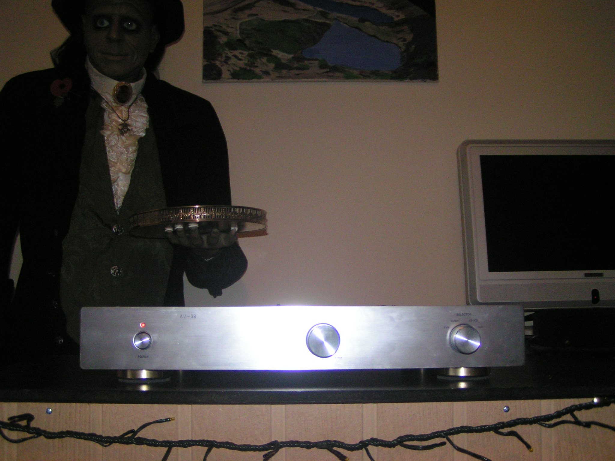

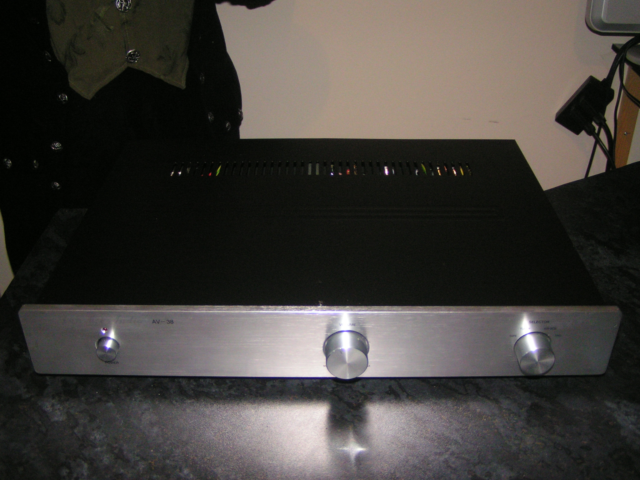

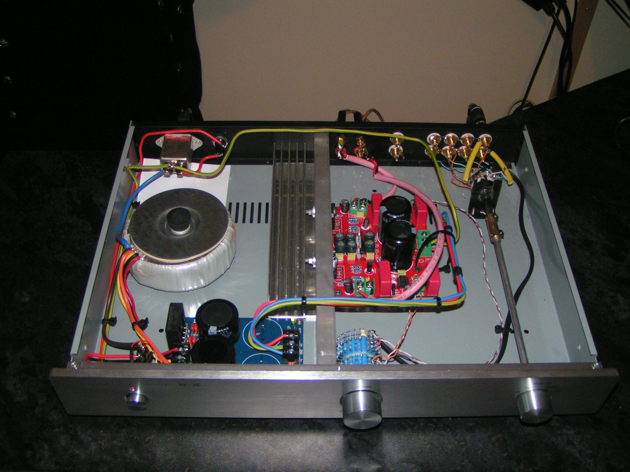

Iv'e bought a nice case from Hong Kong. It cost almost £80 but it is very nice. Pre-drilled with lettering and nice quality RCAs and knobs. I have to buy and sell on ebay to earn the money to make my own. I'm 61 and retired early so I have plenty of time but no cash. Same old story... I just sold a Naim Nait 3 and am about to sell a John Shearne (rare British amp, in case you don't know) and a Creek T43 tuner. Iv'e decided to go digital with the tuner as I seem to have poor reception for analogue. Barry

Thanks for sharing photos. Nice amp.
Good idea with the additional filter caps. I guess you had a reason for doing this?
The same chassis is on it's way to me, except that I ordered the 80mm AV-228 version.
Did you perform the mods proprosed by Linuxguru?
Which opamp did you use?
How does it sound?
