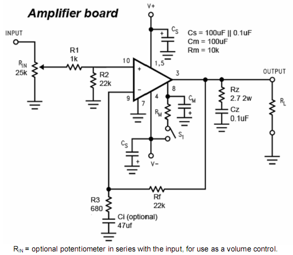

OK - I guess you removed the DC blocking cap and bridged the resistor to the adjacent resistor as well? .
Ughh! Am I being dense? Again, I know I'm not an expert on this stuff, but is there any way you can be more specific? When you refer to the "DC blocking cap" are you refering to the WIMA on the input or the cap to ground in the feedback loop? And when you say "bridged the resistor to the adjacent resistor" which resistors are you refering to? Any way you can reference them on the below diagram?
Sorry if this stuff is obvious to you. I'm usually not one that has problems figuring this stuff out on my own, but I think I've done what is recommended and still have a very noisy amp.
Thanks much!!!
I apologize - I should have been more specific.
DC blocking cap: Ci (cap to ground in the feedback loop) - remove it.
bridged resistor: disconnect R2 from ground, and connect it to the junction of R3 and Ci on the schematic. This node is the newly-created lifted ground on the chipamp side.
Jumper the lifted ground: connect the junction of R3 and Ci to the lifted-ground on the op-amp side, with a piece of hook-up wire. The op-amp lifted ground is isolated from the ground plane by the ground-loop breaker, i.e. the 10 ohm resistor from the first mod.

Now I'm really starting to feel like an idiot. You've now outlined what I should do so thoroughly that I can't imagine how I could mess it up, but somehow I did. My drawing below is what I "think" you have told me to do, but somehow I think I'm missing something.
Everything is correct, except the value of R3 in your drawing. It stays the same as before - 680 ohms in your drawing (1k on the Yuanjing board), not 10 ohms as you have shown (which would make the gain of the LM3886 too high).
With 10 ohms at R3, the closed-loop gain of the LM3886 would be ~2200, which would drive it into clipping with signal levels as low as 10s of mVs. 680 ohms to 2.2k is a reasonable range of values for R3.

Hi Linux,
why are you recommending a DC block on the input and no DC block on the NFB.
I call this mixed AC & DC coupling and often advise against it.
Please explain.
It may not be the optimal circuit for the LM3886, but it's the simplest way to mod this board without cutting traces, isolating pads, etc. The main objective is to somehow quieten the input and feedback signal ground for the LM3886, by isolating it from the speaker return currents in the ground plane, which can generate 10s to 100s of mVs of ground bounce, depending on the resistance of the ground plane and the width of the plane (which is not uniform).
The downside to it is higher output offset voltage, but it is bounded by the closed-loop gain x input offset, and turns out to be ~100 mV on my board.
In the op-amp section, the mixed coupling doesn't matter because the output of the op-amp is at any rate AC coupled to the LM3886. That DC blocking capacitor (between the NE5532 and LM3886) is probably needed, because otherwise the output offset of the opamp is also going to be amplified by the LM3886 (actually, I need to measure and check if this is going to be an issue - if it's small enough, I'll dispense with the DC blocking cap between the op-amp and LM3886).
Edit: With the LT1213 as the pre/buffer, the output offset of the op-amp measures to be 26 mV, referenced to the input shield ground, for both channels. That's a bit too high to pass on to the LM3886 (26 mV x 28 (gain) = 0.728 V).
