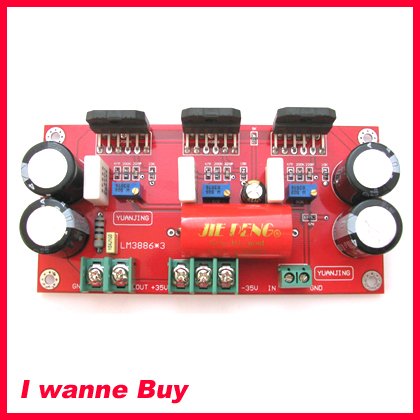

I got my 3X 3886 Yuanjing amp board in the mail Saturday. looks reasonably well built. haven't powered it up yet. the input ground is the same as the power and speaker ground plane so i will try that 10 ohm resistor mod. board looks reasonable. plenty of room to mod. the input DC cap area on the board has multiple solder holes for various sizes of capacitors so that could be changed. looks to have some sort of film cap stock Jie Deng brand. I intend to use this for a bass guitar practice amp so i wont be as critical about it. but seems like a good price if it works.
Zc
Zc
A friend of mine bought a pair of these Yuanjing 3X boards for a high power stereo and he is very pleased with them. A question for Linuxguru. The 27k and 680ohm resistors I fitted were vishay 1W metal film. Are these OK. They are all I had in my cupboard.
Those should be fine, if you can fit them in the space provided - it's a tight fit. Also, be careful when desoldering components on this board - the copper looks like it might delaminate easily with excess heat, unlike the red Yuanjing boards, which are very sturdy in this respect.
This will probably limit some of the experimental mods on this board - I'll await the second board before attempting the more ambitious mods.
