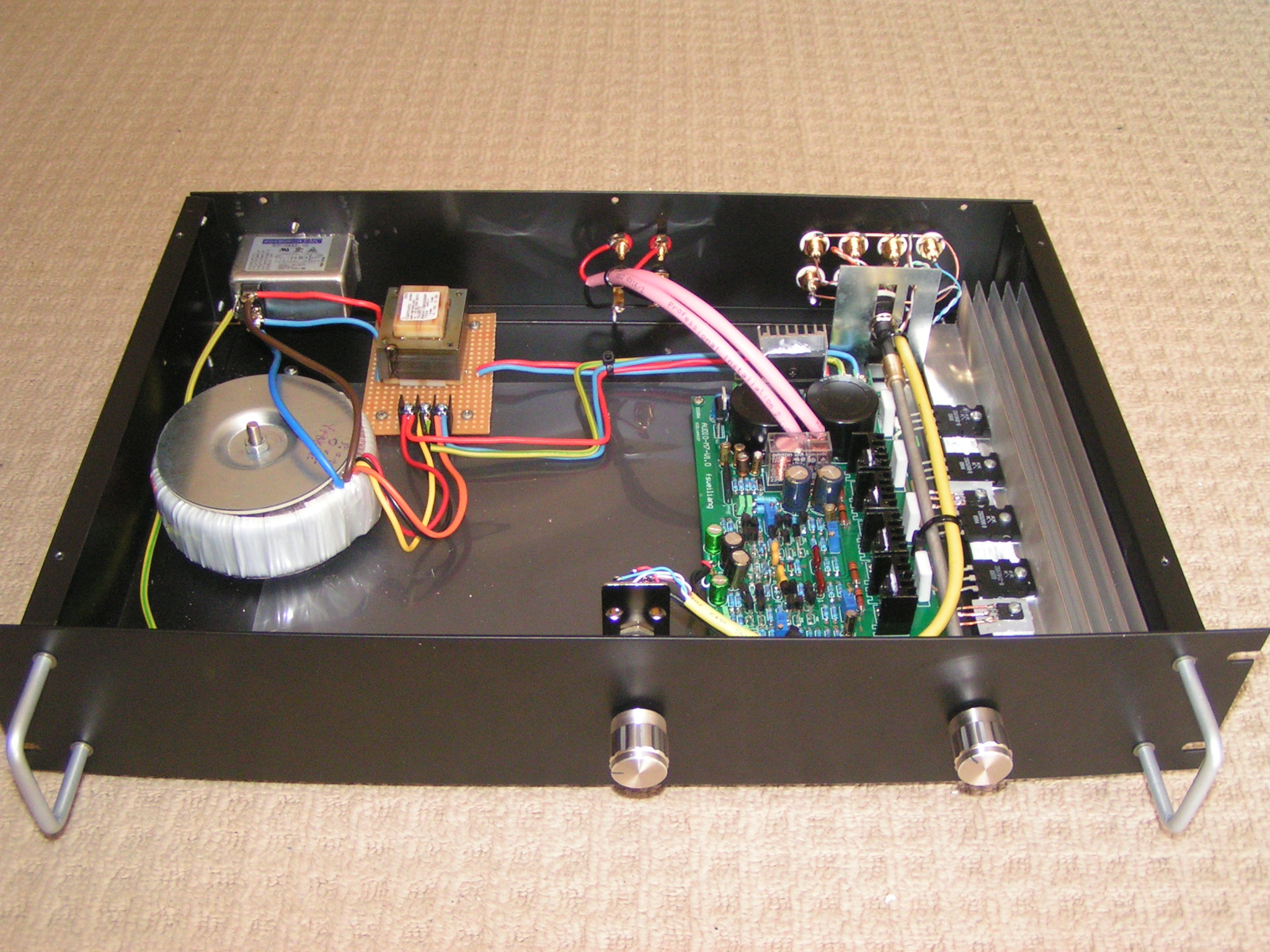

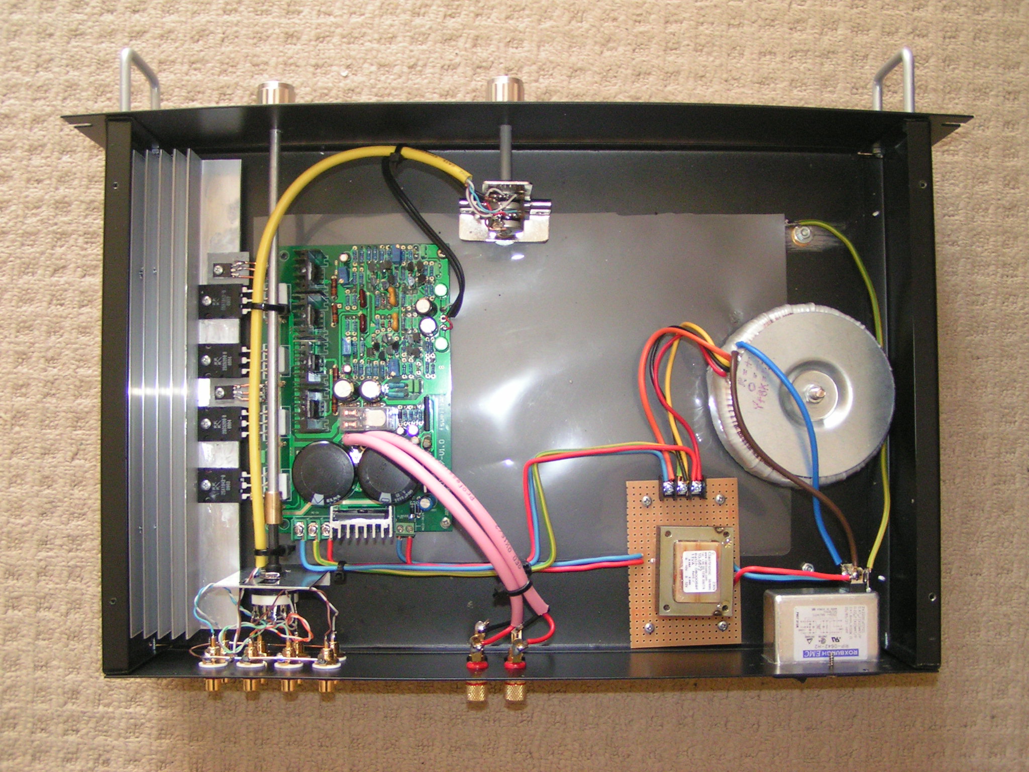

I have finished the Goldmund amp and after leaving it on for a few days to check heat dissipation it sounds great. I'm going to try to download the pictures.😀

I had a hum, but it went altogether when I earthed the volume control. I'm waiting to fit a pre-amp, but it sounds so good I wonder if i'll bother. Like linuxguru, at first it didn't sound much better than the yuanjing amp but as it bedded in it improved a lot. It is certainly the best amp I have ever made. It is hooked up to a Audiolab cd8000, Roksan dac,and Linn speakers.
Barry - that looks really neat and nicely assembled in that EBay rack case. I've created a new thread at Solid State for all matters related to the Goldmund/Symasym kit, to avoid confusing the readers of this thread who may be looking for info related to the Yuanjing and related gainclones.

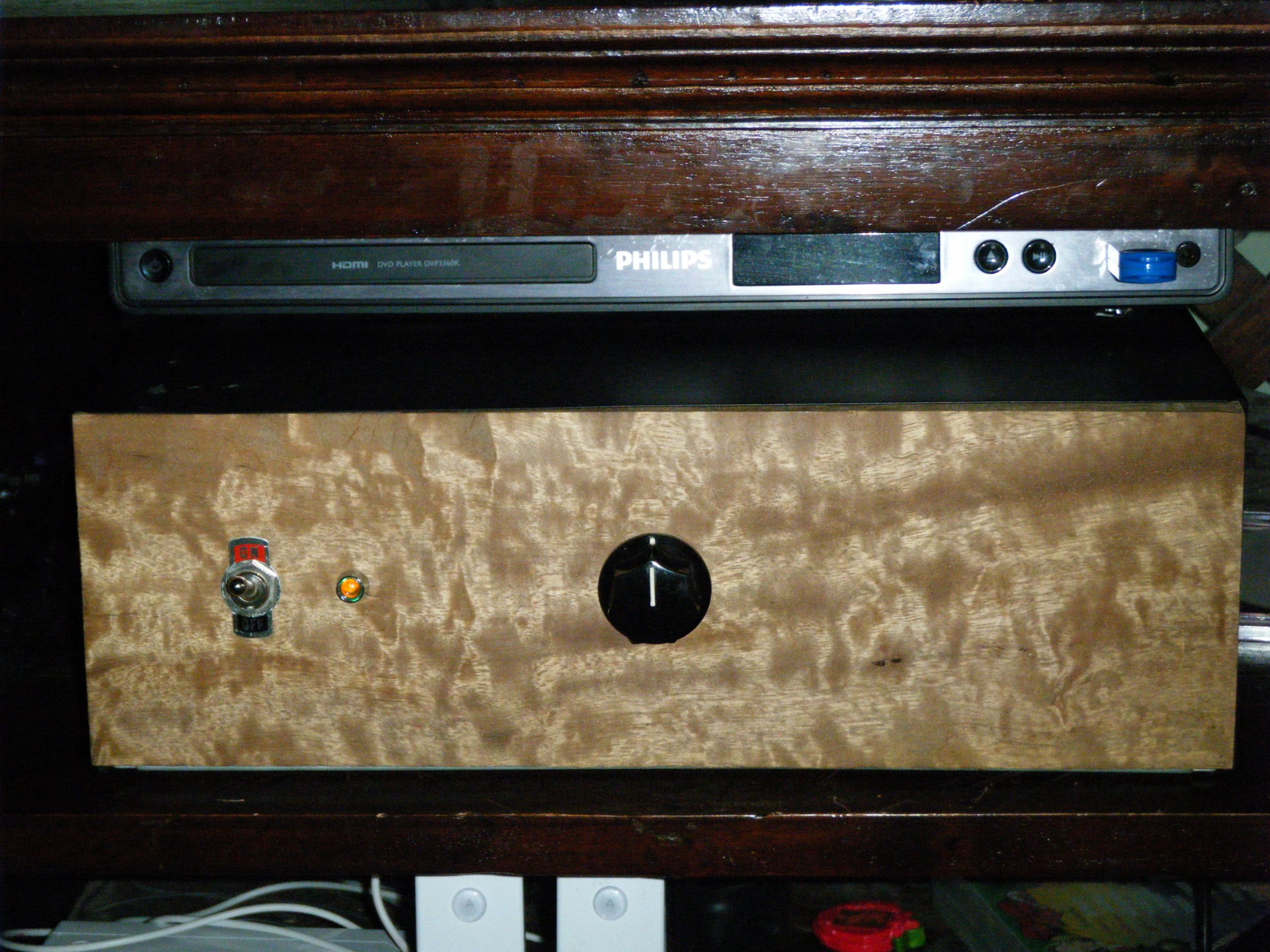

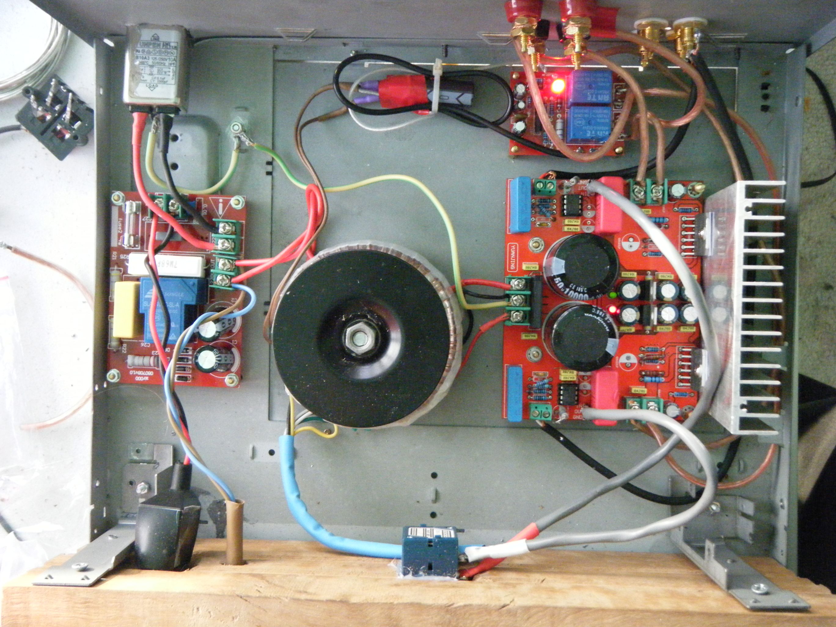

Finally got my case finished so here are some photos.
Ebay spec MK1 amp featuring Yuanjing 3886 board.
Speaker protect and soft start boards ,Alps blue pot and retro style controls all in a $10 tip shop tape deck case with home made front.
Torroid from old midi system to be upgraded as only running on 15v secondaries though still loud enough!
