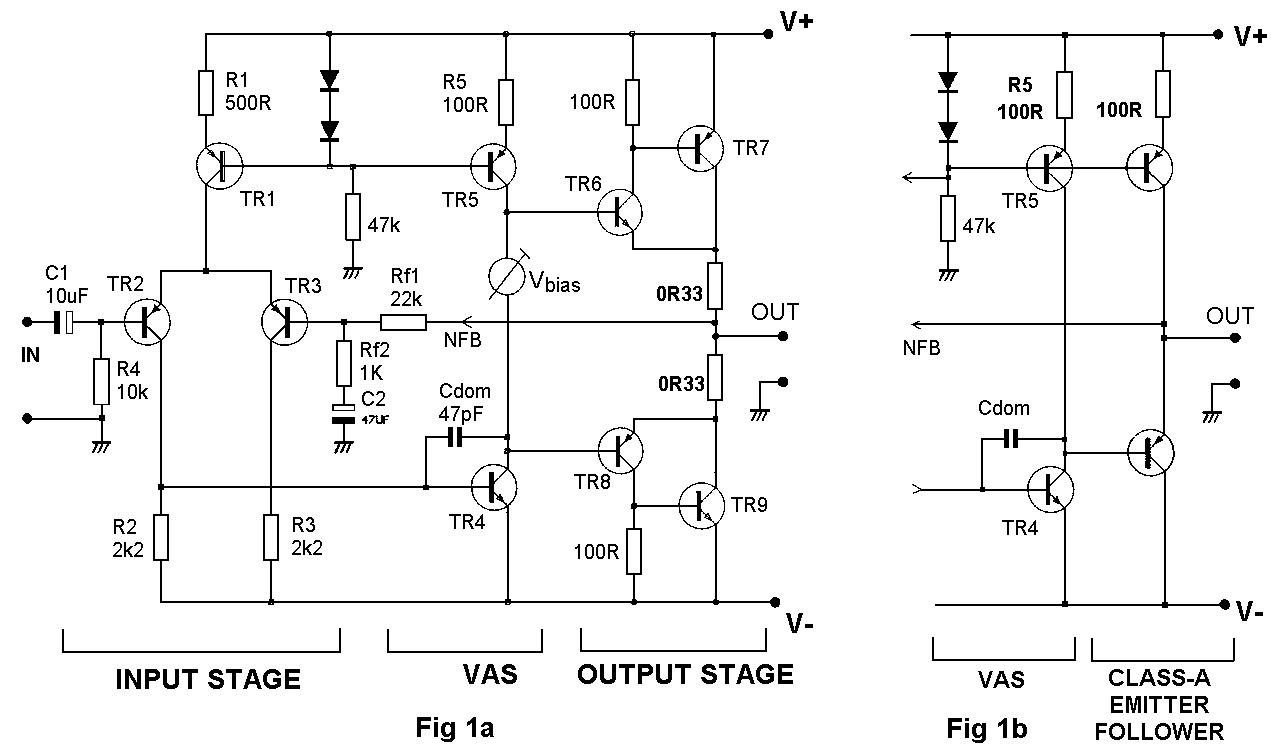

I was tried to designing blameless amplifier (Lin topology). First, I want highest slew rate as possible. Then I tried to make lowest THD at 20 kHz. And I want high PSRR, too. Like you said, everything must be compromise and I did not want to go too complex. I like the way it sound, although at high frequency CFA topology is my favorite.

I design the blameless with high slew rate (around 90V/uS with +-44V DC power supply), I want compare it with amplifier with current on demand input. Is slew rate the most importance specification?
My blameless THD at 71W/8Ohm, 20kHz -> 0.000287% and PSRR at 100Hz -> 118 dB on simulation. I will verify it if I get better sound card with ARTA software.
What do you think?

Let us be quite clear. The Blameless amplifier is not a "standard Lin configuration". The Lin amplifier was 2-stage, The Blameless amplifier is 3-stage.

Doug, with all respect, I am confused. On your website you say:Let us be quite clear. The Blameless amplifier is not a "standard Lin configuration". The Lin amplifier was 2-stage, The Blameless amplifier is 3-stage.
Distortion In Power Amplifiers
"Fig 1a shows the generic Lin power amplifier circuit, with the now universal differential input stage, representing something like 98% of the amplifiers ever built. It is the obvious starting point for amplifier investigation. [1] Fig 3 shows its distortion plot; there are two distortion regimes. Below 1 kHz THD is low at 0.002% but not zero, the noise floor being 0.0006% approx. Above 1 kHz, THD quadruples with each octave and reaches 0.5% before 20 kHz.
The basic topology is a transconductance amplifier (voltage- difference input, current output) driving a transimpedance (current-to- voltage converter) Voltage Amplifier Stage, followed by a unity-gain power buffer. The voltage at the VAS transistor base is typically only a couple of millivolts, and is of little interest in itself; it is the current passed from the input stage to the VAS that counts. This topology has many advantages, including simple compensation."
Fig 1a
So the Lin amplifier in Fig 1a has an input stage, VAS and output stage - looks like 3 stages to me. In fact, the same 3 stages as in a Blameless amplifier. Hence my confusion.
