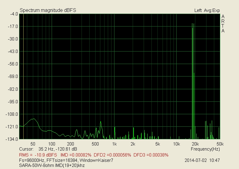

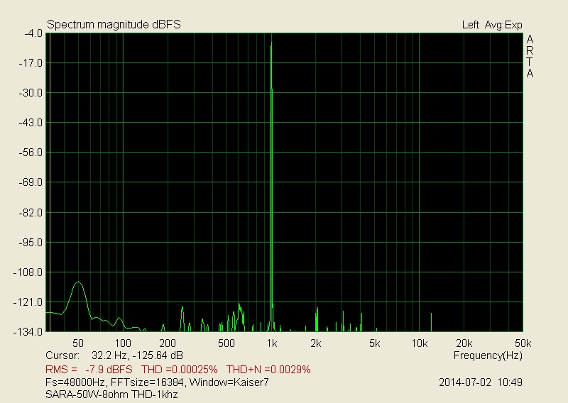

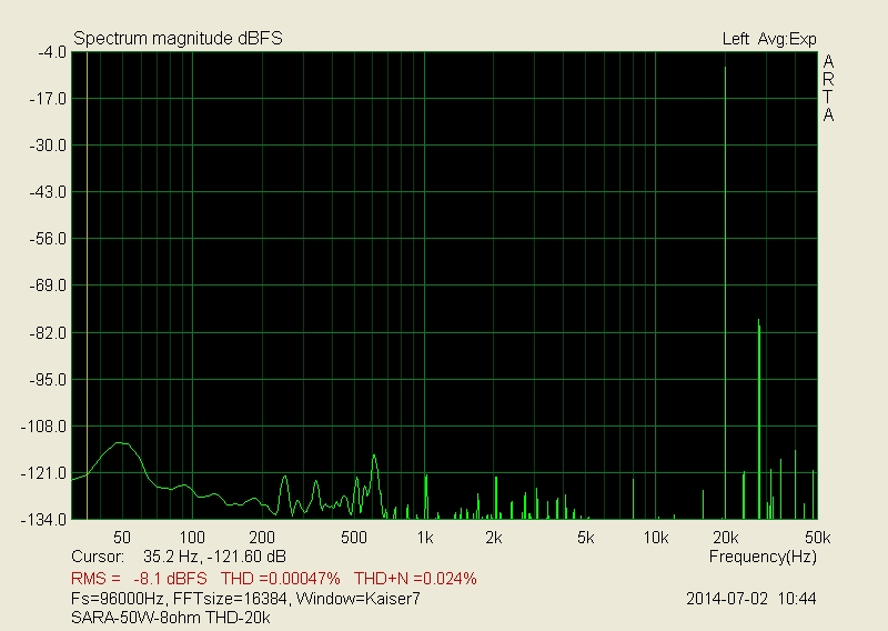

SARA amplifier , my design, push-pull VAS. 2x100W in 8 ohm
The 20kHz THD measurement has some problem - what does produce the ~ -80dB signal around 30kHz?
