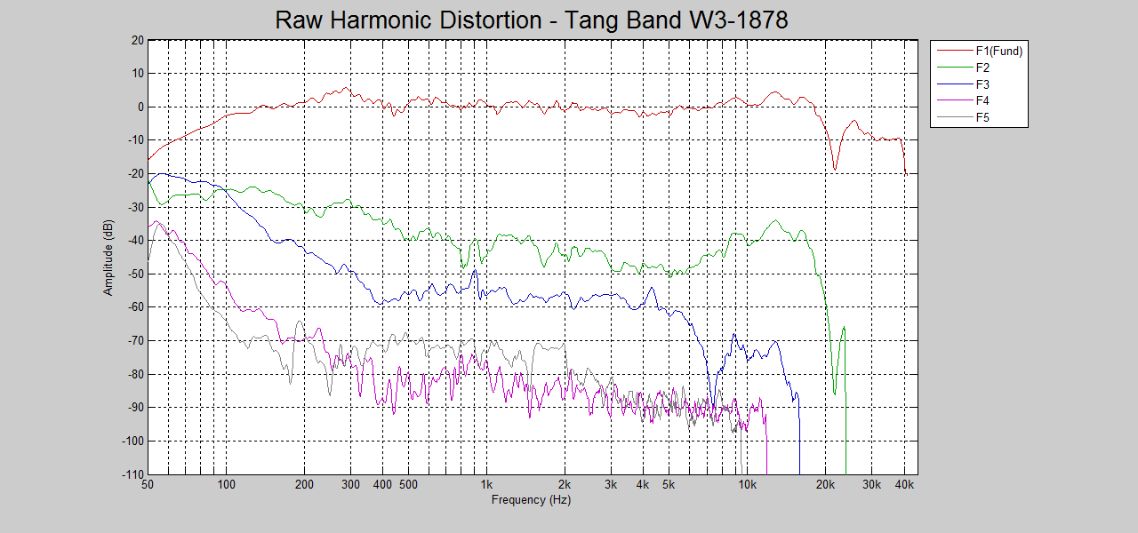

Does Clio lie? (..if anything it's often a bit more "harsh" than reality.)
Still, could be cherry-picked. (..and yeah, could well be a TB employee.)
Here is Tim's results with the 3" (and I'm expecting the lower-end of this 4" to be better, it is a larger driver after all):
Since Geddes posted his distortion experiment results i pay little attention to measured distortion. Not duplicated yet, but it points to the drunk looking for his keys under the streetlight (in the nite) and answers when asked if he lost his keys there he says no, but i can see here kinda thing.
If that is the case, Clio may not lie but it doesn’t tell us anything.

Those LMS graphs are the ones supplied with the drivers, when you order directly from TB, so yeah, those are in-house measurements... to be taken with a grain of salt.

And not to bolster Planet’s position, but yes.......many of the most popular, iconic and beloved speakers over the decades of hi fi have measured horribly!.....and yet?
In my case though, LOL....they matter as I need a flat response. I need reasonably low harmonic distortion as an identifier of where and when power compression begins....but I don’t fret it over the entire frequency spectrum.....outside of the 500-10k passband, HD becomes almost a meaningless measure on it’s own. I get a kick outta guys discounting a driver because of a breakup mode at 20k that propagates as HD at 15k.......other that some 13 year old fledging audiophile, NOBODY is gonna detect that
