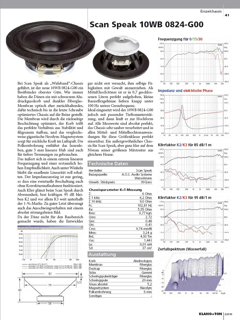

and more recent:
Note that all are on test baffles that are overall much larger and not prone to diffraction problems typical for common monitor boxes. This is where the excellent linearity of the driver can be disadvantageous when looking for a driver that will have a flat response on a more common loudspeaker baffle when used broad-band and specifically NOT wanting electronic compensation.
ScanSpeak 10F/8424G00 | HiFiCompass
ScanSpeak 10F/4424G00 | HiFiCompass
5F8422T01-10F8414G10
