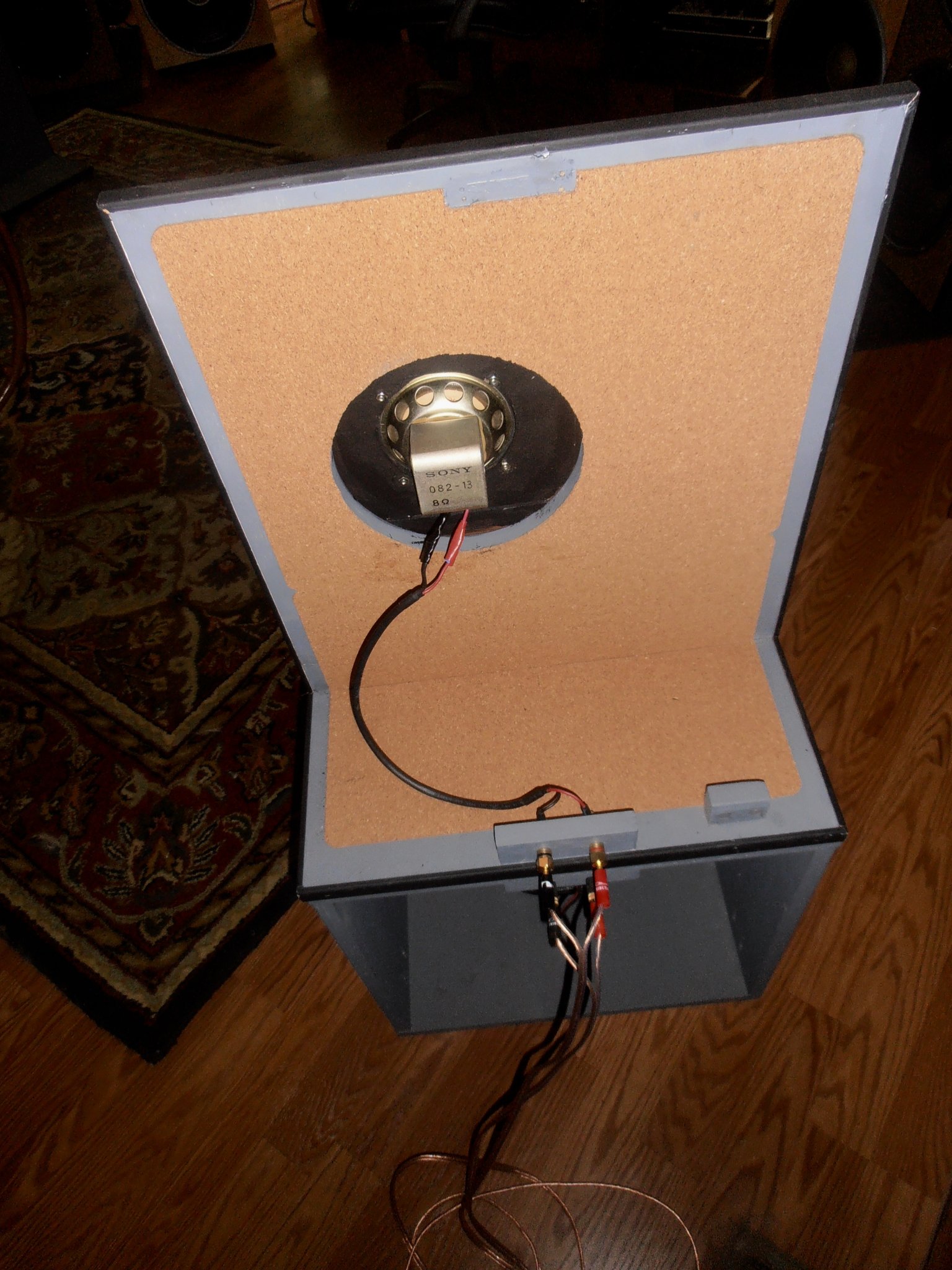

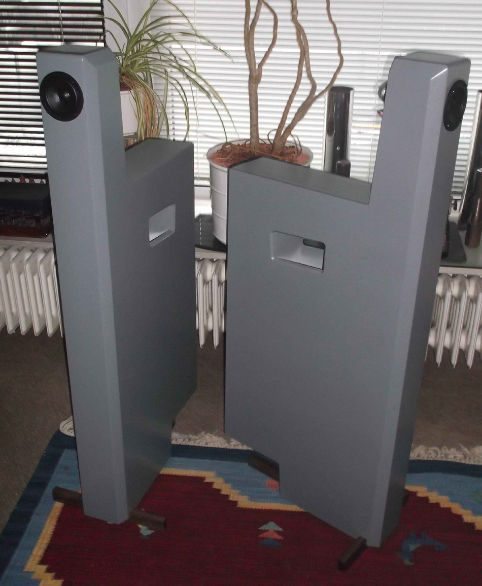

One of my favorites is the Coral Holey Basket. They were used in TOTL Sony reel to reel tape recorders. Excellent in open baffles with bass support as well as in Frugel-Horn Mk3s.

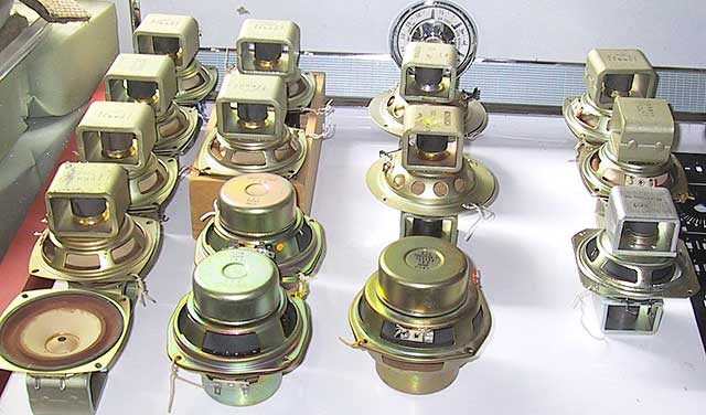

The class of 4” drivers that the Holey Basket Coral comes from was well populated at the time. At one point i had over 20 distinct examples. This driver is now represented by the FE103 and likely the best example ithe FE103 SOL. The Foster driver was the most common IME (Admirals sold a zillion of them in NA.
The Coral and the much rarer Atomix are considered best of breed, but the Corls tend to suffer from stiff surround syndrome. A 16Ω version (2 of them) come in one small Monarch enclosure as well as the SOny source. There is also a related 5” whih is very good.
dave

Do those other drivers have alnico motors like the CHB's?
