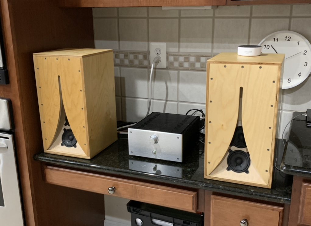

I agree that 3FE25 are wonderful. I and even the rest of the family, listen to them daily probably more than any other driver as they are in the 0.53x Karlsonators in the kitchen. I use parallel 16ohm 3FE25’s for some incredibly sensitive 8ohm speakers. They definitely deserve recognition for great smooth sound with nice reach, low distortion, and unbeatable value.
Here they are - the most popular speaker in the house.
Amp is Hugh Dean’s superb sounding Deltic 65w Class AB.
