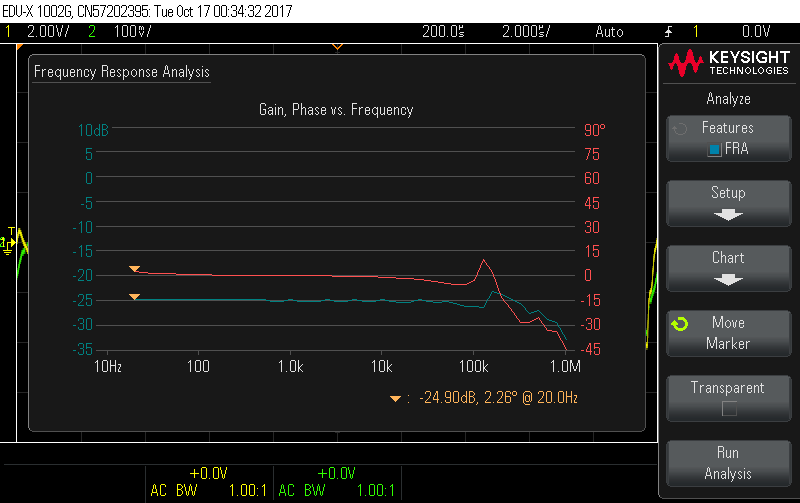

Hey there. I ordered parts to build an experimental CCS to deliver DC current to the primary for the measurement purposes, they should arrive in a week.
I have everything else - low THD SS amplifier, and THD measurement using EMU0404.
I also managed to wind the second transformer. Still haven't measured it for the "OPT curse, that means a secondary layer with a turn less or more. It happened when I wound my first transformer and even if I measured more than 20 transformers afterwards with flawless results, it still gives me chills. 😀

If someone insists, I can measure the THD without DC current, but this is not realistic.
