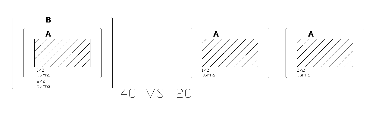

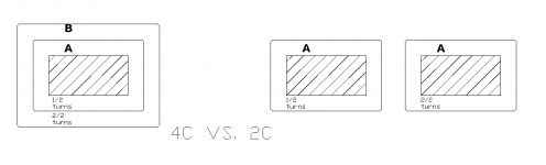

I think I have already answered several times to your last question: if you have 1920x2=3840 turns on a 2C transformer with a core area A then I only need 2716 with a double core are I get the same inductance, less copper loss and equivalent high frequency performance. If use the same core area with 2C you loose the advantage of size and get worse high frequency performance. If you keep the 1/2 core area and have 2715 turns then your low freuqency performance is A LOT worse. No escape. The shell type transformer is more common for a reason.....
But why? You're just giving a statement, but I need an explanation for that. Or measurements?
Why would, knowing that
The surface area, Ac = 2AC = 4AC
4AC has one bobbin, B with turns Nb
2AC has two bobbins B1 and B2, where the turns Nb1+Nb2=Nb
The core material is the same
The magnetic path length is the same
Why should I need (41%) more to reach the same inductance from 4AC to 2AC? What is the reason? What is the theory behind it?
One good reason the shell type is more common is because there is only one bobbin needed and it's more economical.
The magnetic path is the same
The inductance is directly proportional to both square turns and core area.
So if you want the same L having 1/2 core area and the same airgap you need more turns: the square of 1.41 is about 2. This is just a gross figure which doesn't take into account other things. Changing the air gap is not generally possible to match it especially when it gets too small. This certainly true for DIY.
However, as the winding volume of the single bobbin for the 4C core is the practically the same as the two bobbins together of the 2C core with 1/2 area and the shorter average turn lenght is not enough to compensate, it is sure the efficiency will be worse for the 2AC if you want the same L, Bmax not reaching saturation, the same DC current, the same high frequency performance.
If you try to get the same efficiency it will be worse in others areas. For example you minimize the space for insulators simplifying the geometry high frequency performance is worse!
If use a bigger 2C core to match the core area it will be worse for the same geometry at high frequency and it is unlikely that with a more complicated geometry (that will require more insulation) it will have the same high frequency performance and maintain the same copper loss at the same time! The latter circumstance will likely depend on the specific case.
Assuming that is possible, why should I do something more complicated if I can get the same same result with less troubles??
The only reason I would do that is I have 2C cores for free and don't look into the horse mouth....
So you make your transformer and I will make mine and will see. Otherwise it ends here.
Okay!
BUT from the beginning I am trying to say that 2C and 4C will have the SAME core area. 🙁🙁 Why are you insisting on 1/2 core area?!
This is just a gross figure which doesn't take into account other things. For example, the induction is inversely proportional to core area and turns and so in this respect you need actually 2X turns to match the same Bac if you want to maintain the same airgap.
Yes!
Why mentioning 1/2 again? The 4C area will be the same as 2C. Do you want a CAD drawing?
At last we're talking. 2C is finally equal to 4C. Check post 12, where I explained that a single bobbin will have more surface area for the same windings, compared to the splitting into two separate bobbins.
I would suggest that you learn how a transformer works in all aspects otherwise I think I will win easy....🙂
