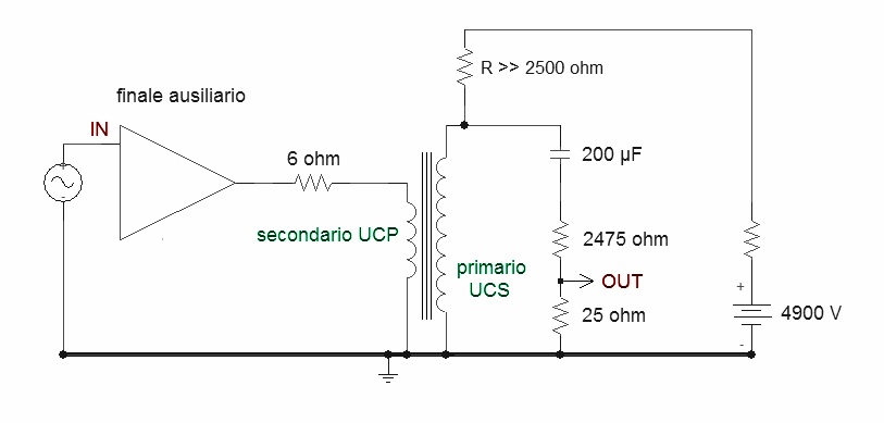

to 50AE
please use the test set as described on my old post about LITZ trafo ( where I am still running, Hardly!!!).
It is a smart way to test fine the trafos.
You need a good ss amp, 30-50 watt max
You can omit the Ia bias, for now

Thank you for suggesting your method. But there is no way I want to test my transformer without Ia. We're testing a transformer for a classic SE application, so there must be current through the primary.
There's no way I can have a 4kV power supply either. A CCS sounds like a much better idea.
In my opinion you can test the stuff without Ia first to understand the high frequencies that are impacted not so so heavy by L but parasitic.
For bass without current you can understand the face.
We are check a new method to get the bias current with a better method.
The test on primary winding is more important with a large swing .
Walter
Walter
