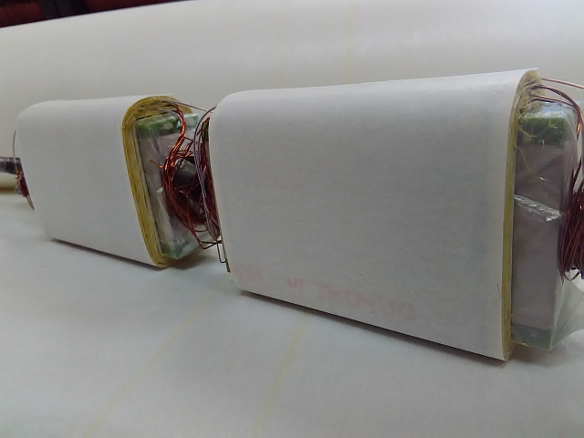

I officially began the winding of the transformer and I'm halfway there. The problem is, the winding machine is busy again for choke winding. It will have to wait at least another week.
The impedance ratio, neglecting the reflected ohmic resistances is 3020R/8R
The driver won't be practically swinging 200Vrms but 180Vrms into the primary, but I used this value for headroom.
Btot = 0,763dc + 0,796 = 1,56T at 20Hz, 200Vrms ; L=18Hpri, ; Ia = 120mA

Your math is correct. 🙂 2720 turns, because the core cross section turned out to be slightly larger -> 10,4cm2. I forgot mentioning that, my apologies.
Thanks. The P/S used is a 0.15mm "sandwich" of Nomex/Mylar/Nomex.

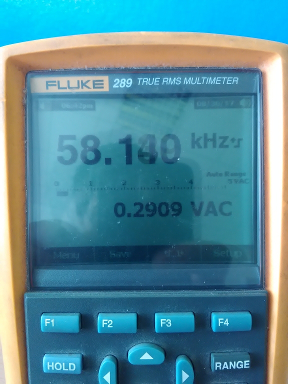

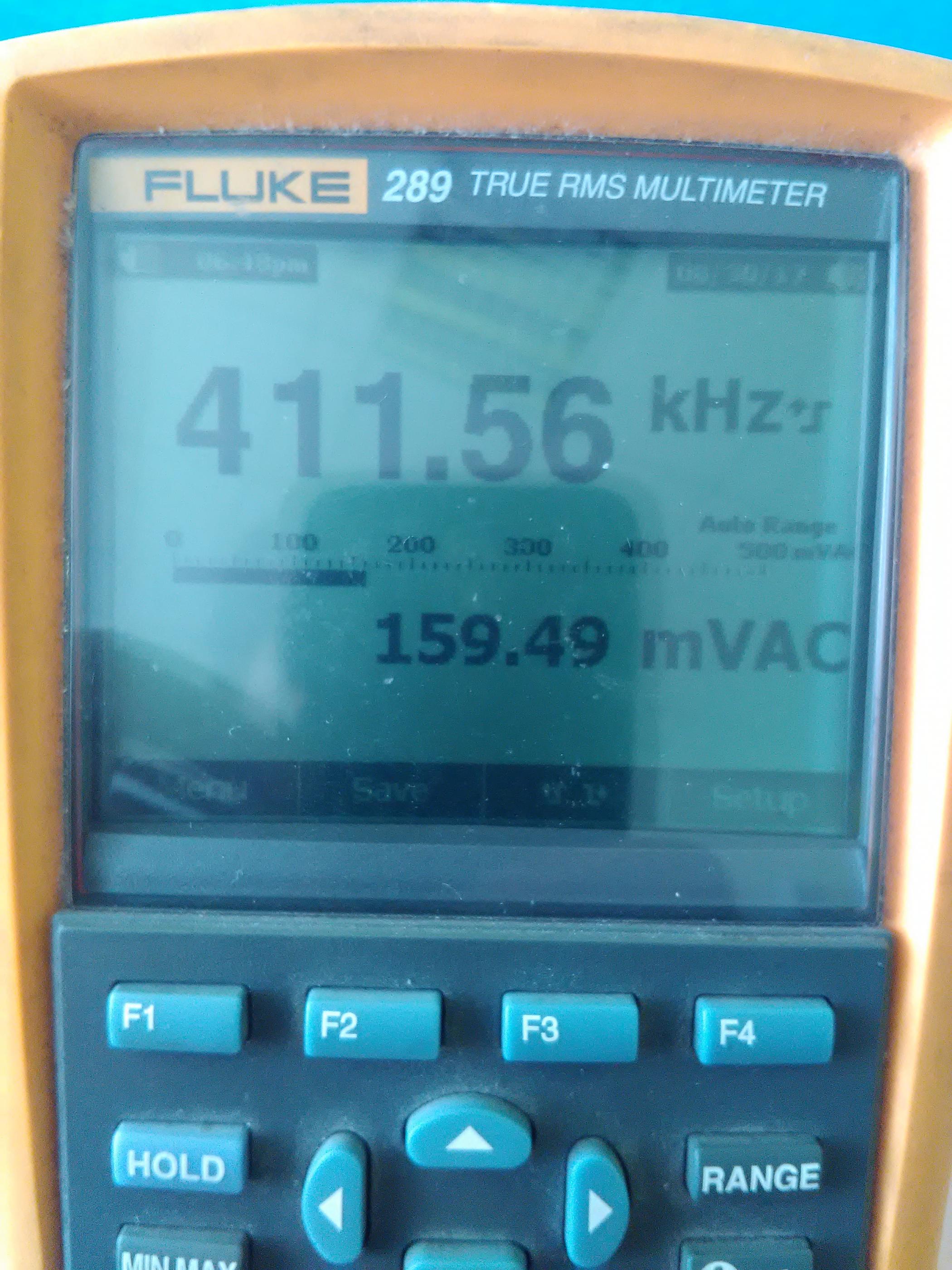

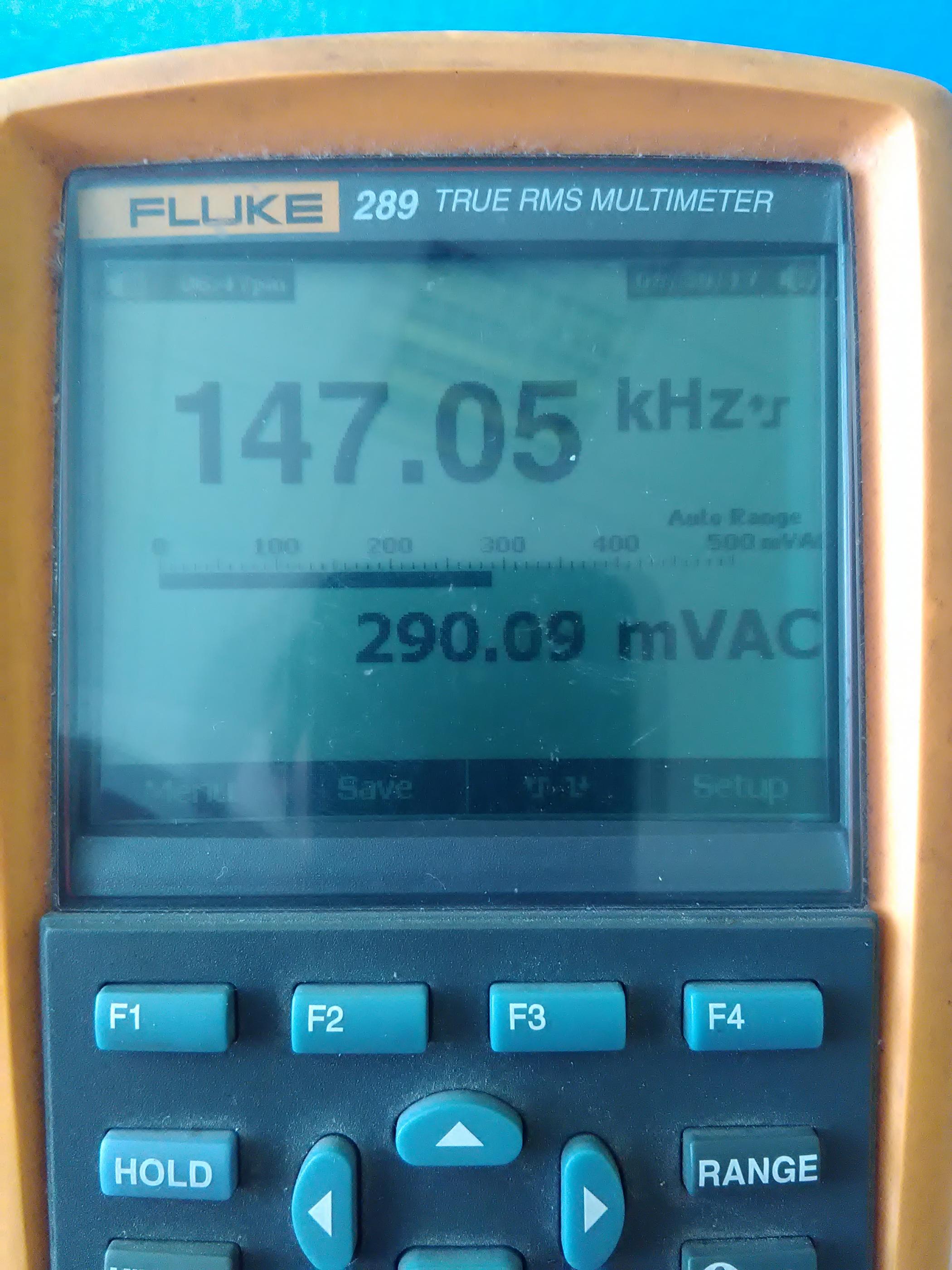

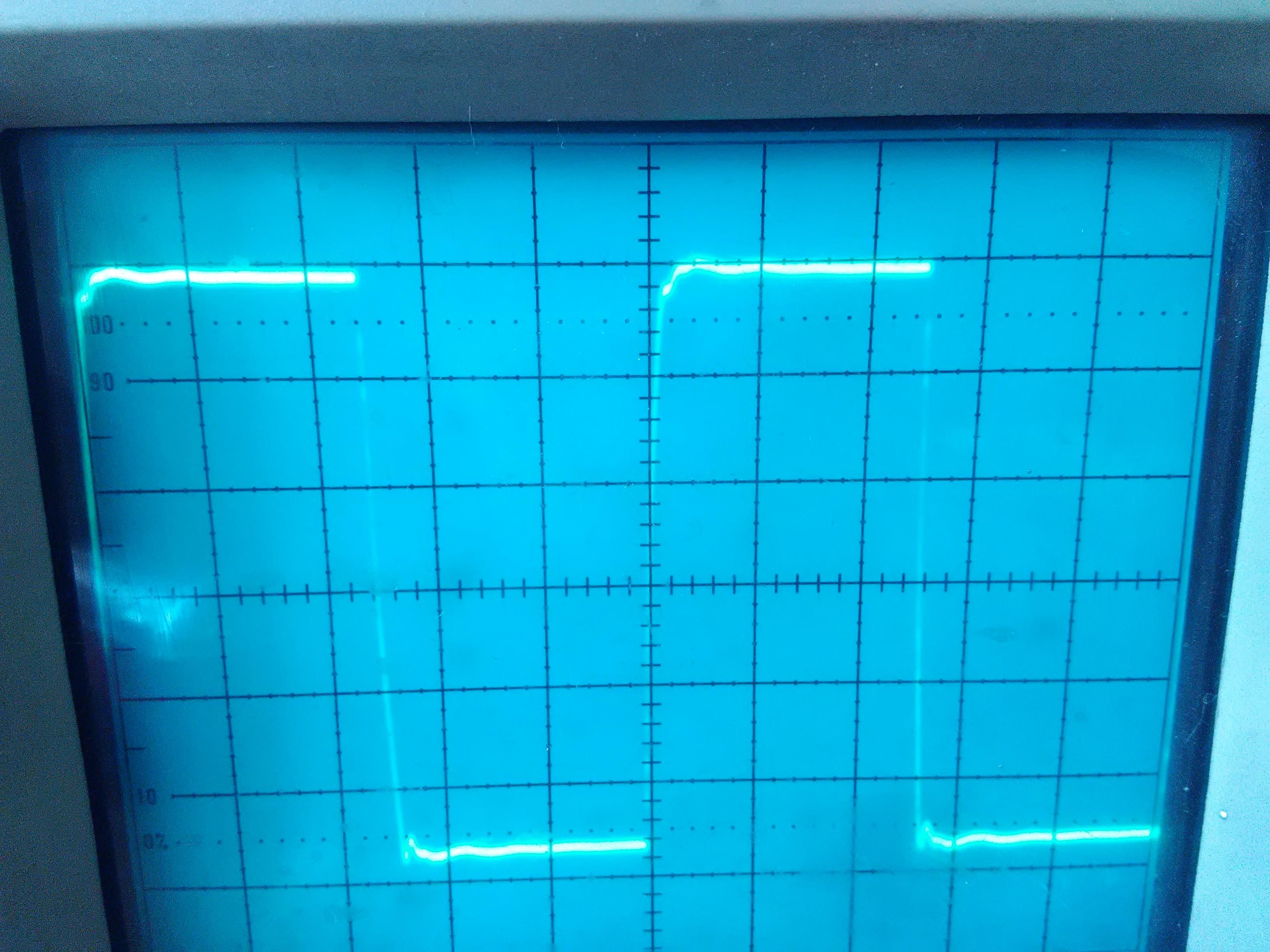

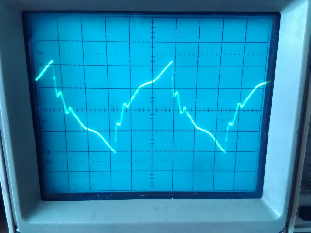

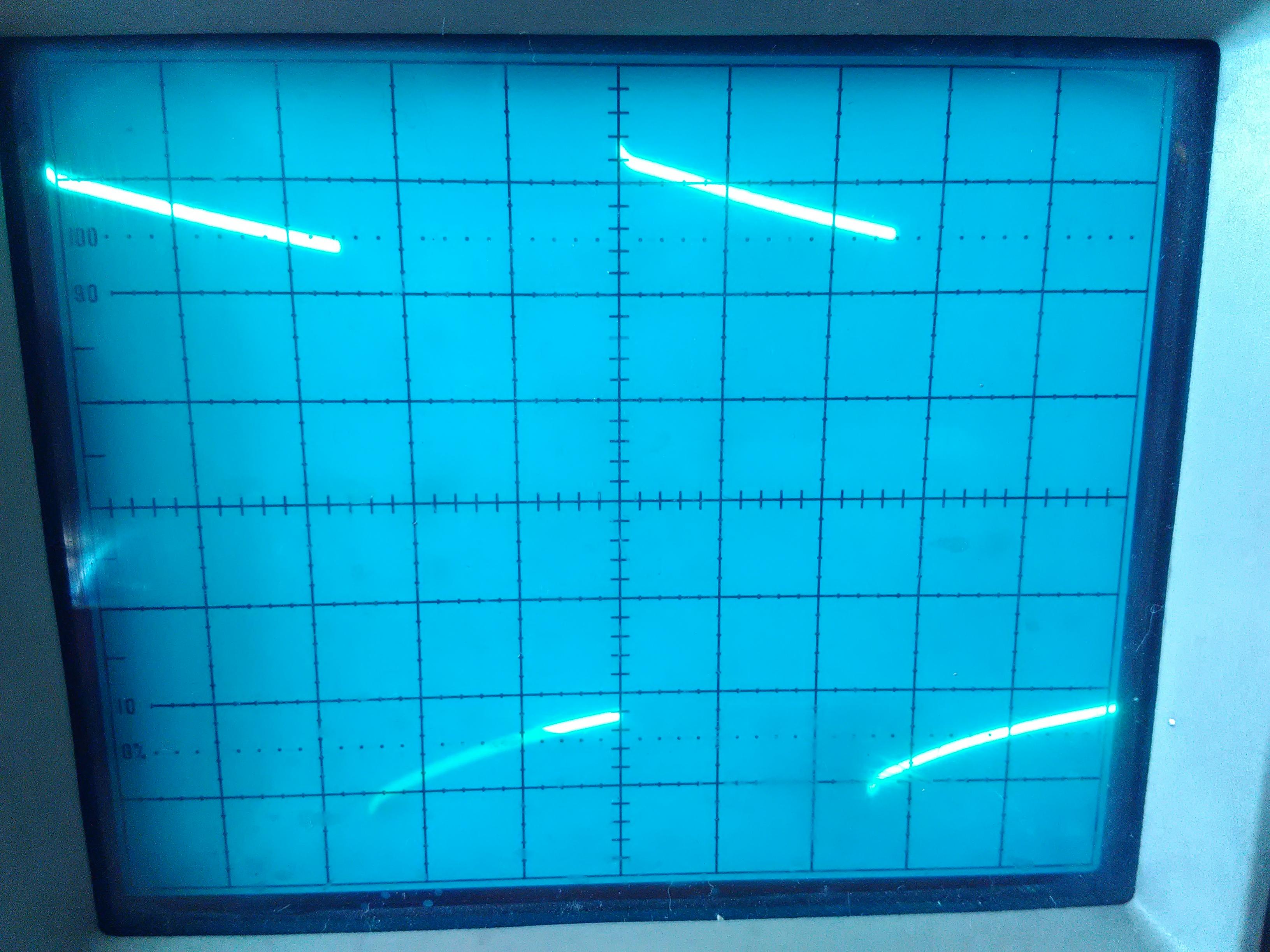

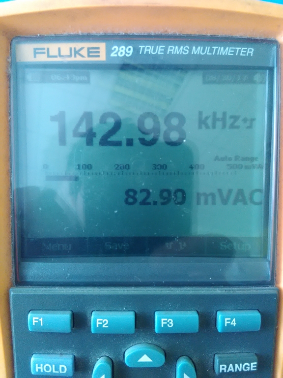

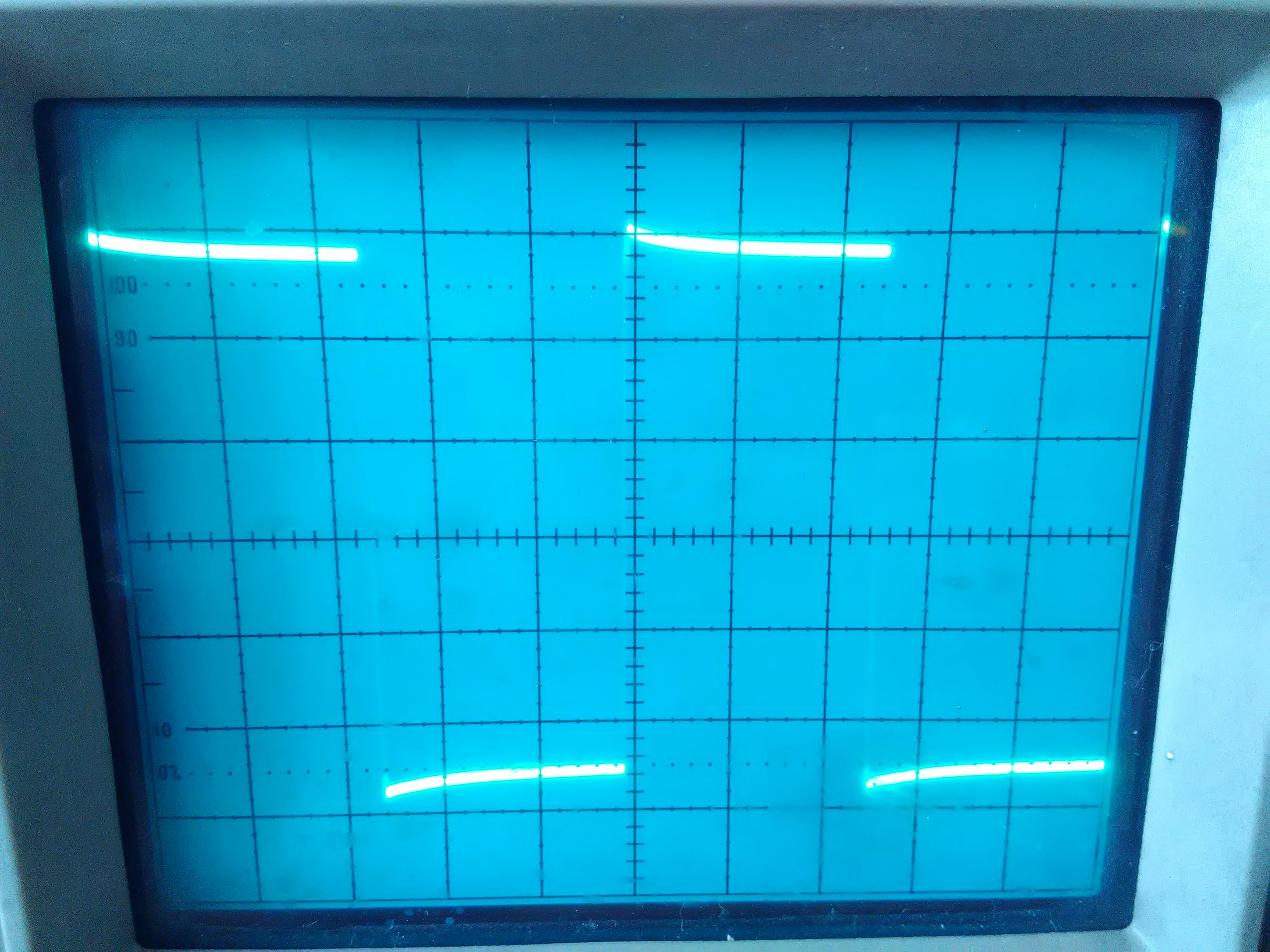

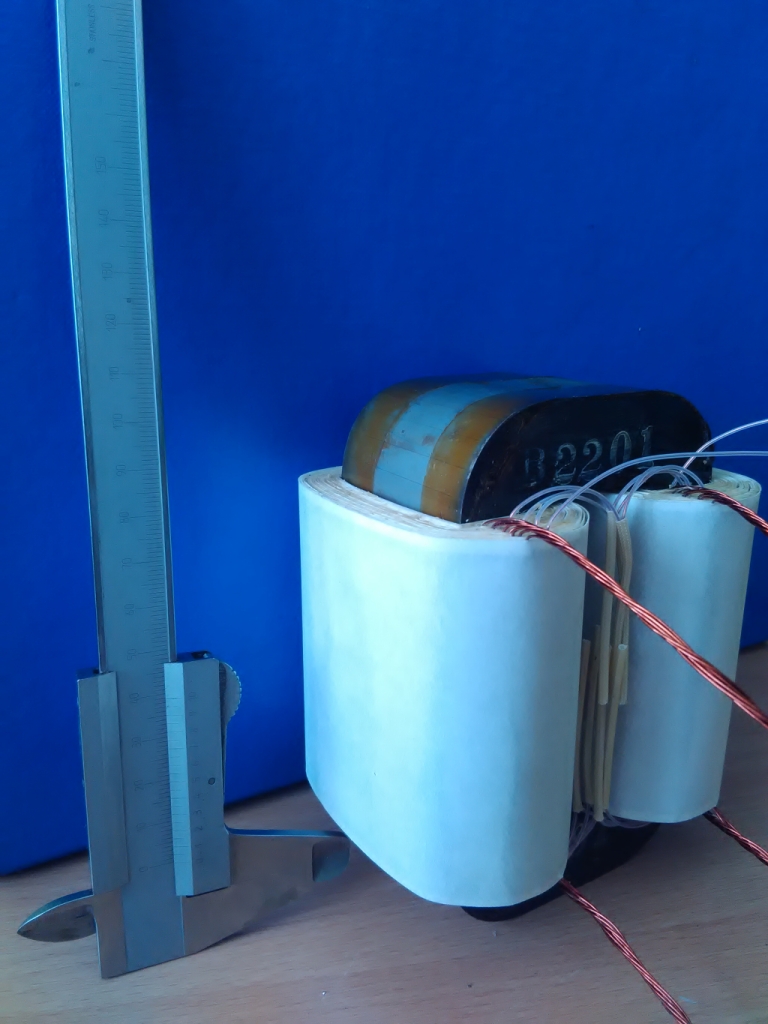

Hello there,

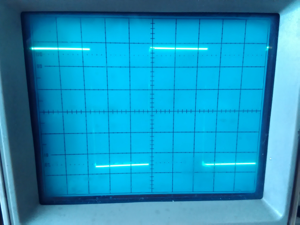

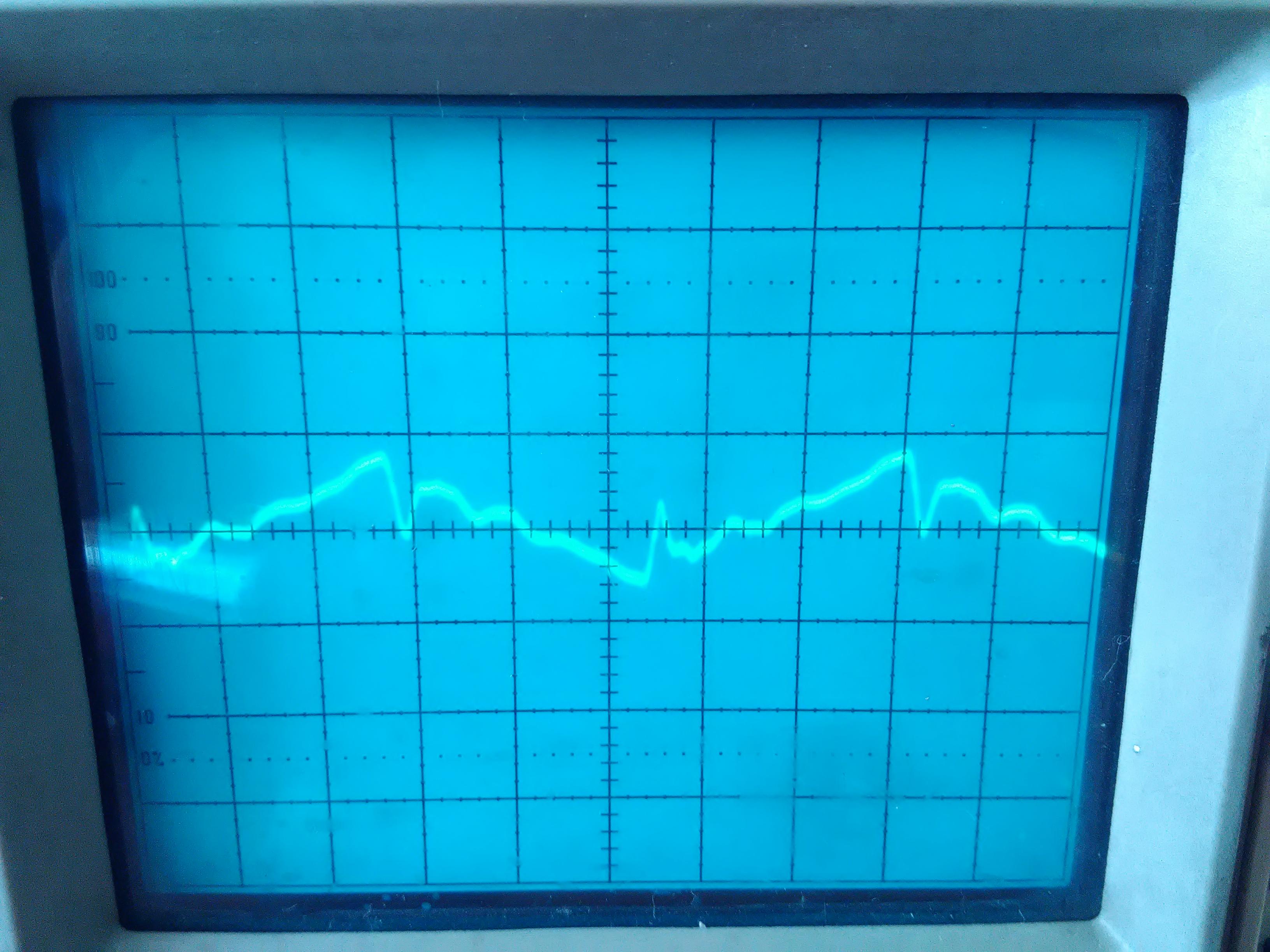

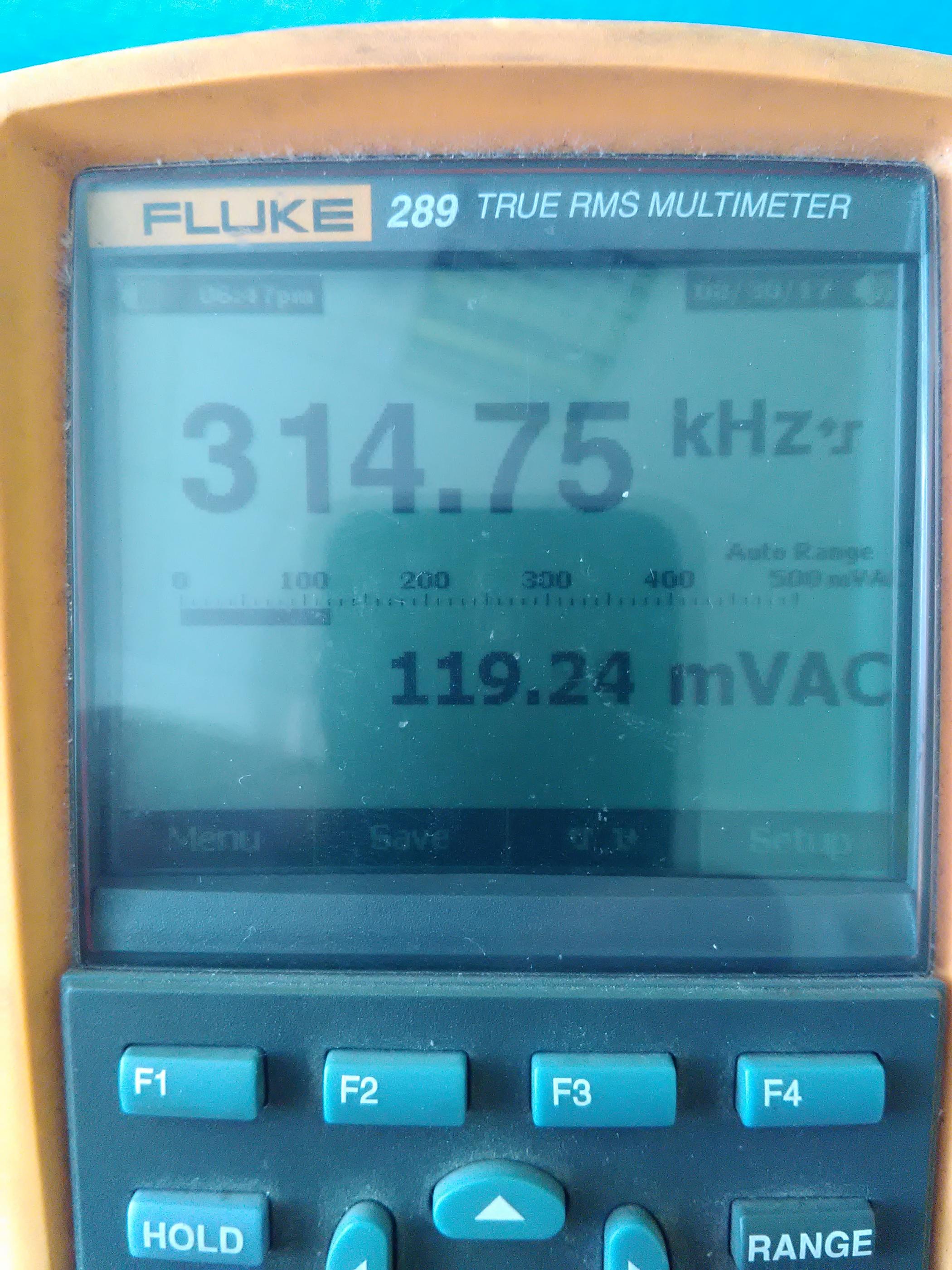

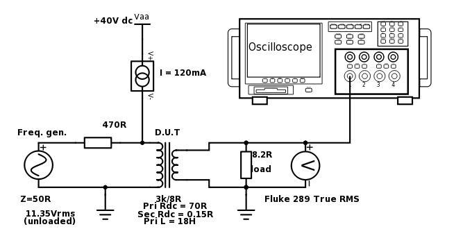

The machine was free to use for a few days and I managed to finish my transformer. In the same day, I only managed to do simple measurements, such as HF response, HF oscillograms, FR response at a low amplitude under load.
As promised, I will also perform THD tests under 200V RMS at the frequencies of 30Hz, 1kHz and 20kHz, but it will have to wait a bit too. I'm busy with work and I also have to build the measurement jig too.
The transformer's simple description is the following: Z ratio = 3k/8R
Pri turns = 2720
Sec turns = 140
Rdc pri = 70R
Rdc sec = 0.15R
L pri = 18H
Ia = 120mA
Core = 10.4cm2 GOSS

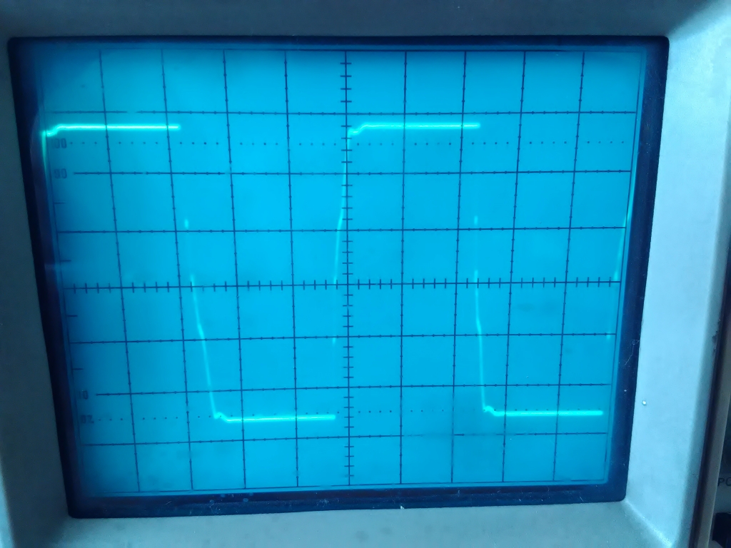

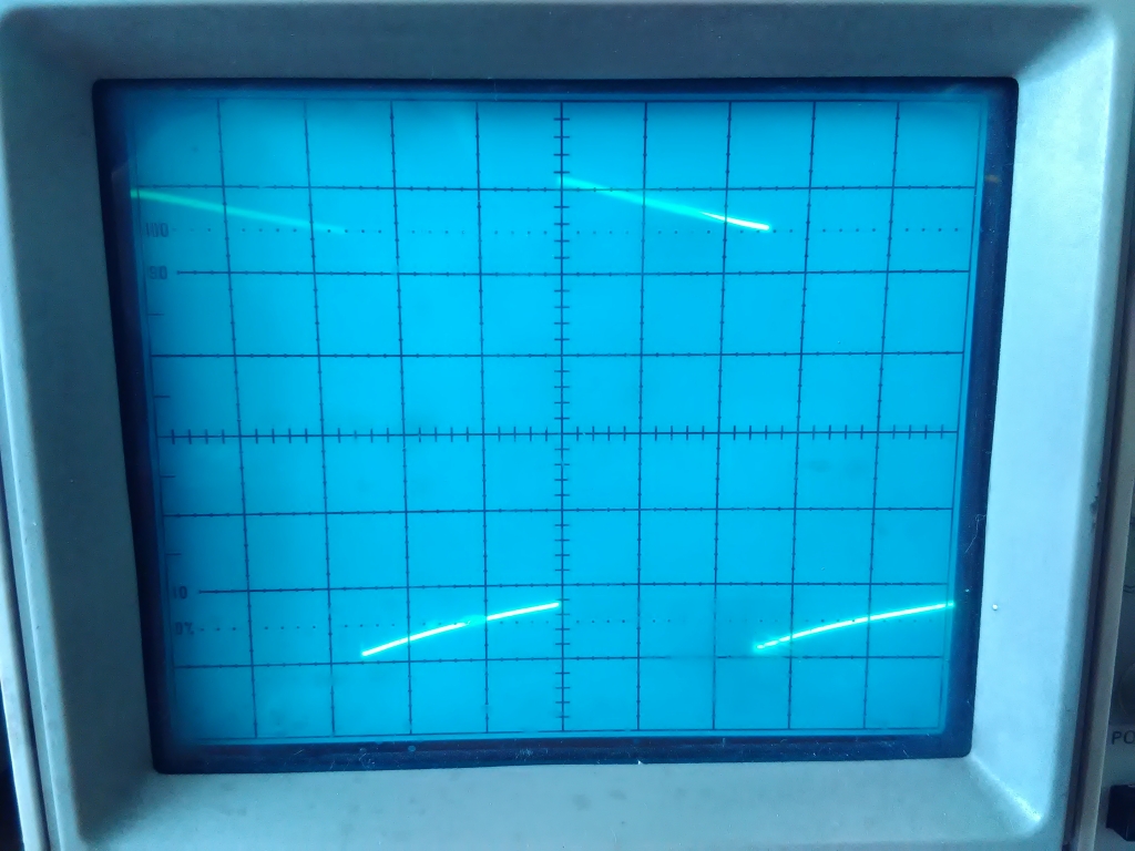

This are the conditions under which the measurements are done: The testing jig has an included current source at 120mA . The driving impedance is 520R.
Oscillograms of square waves:
First: 100Hz
Second: 1kHz
Third: 10kHz
Forth: 100kHz

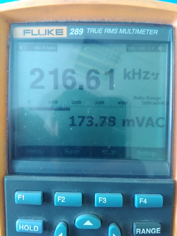

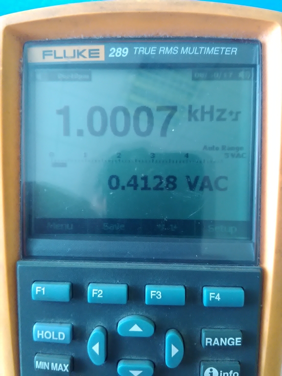

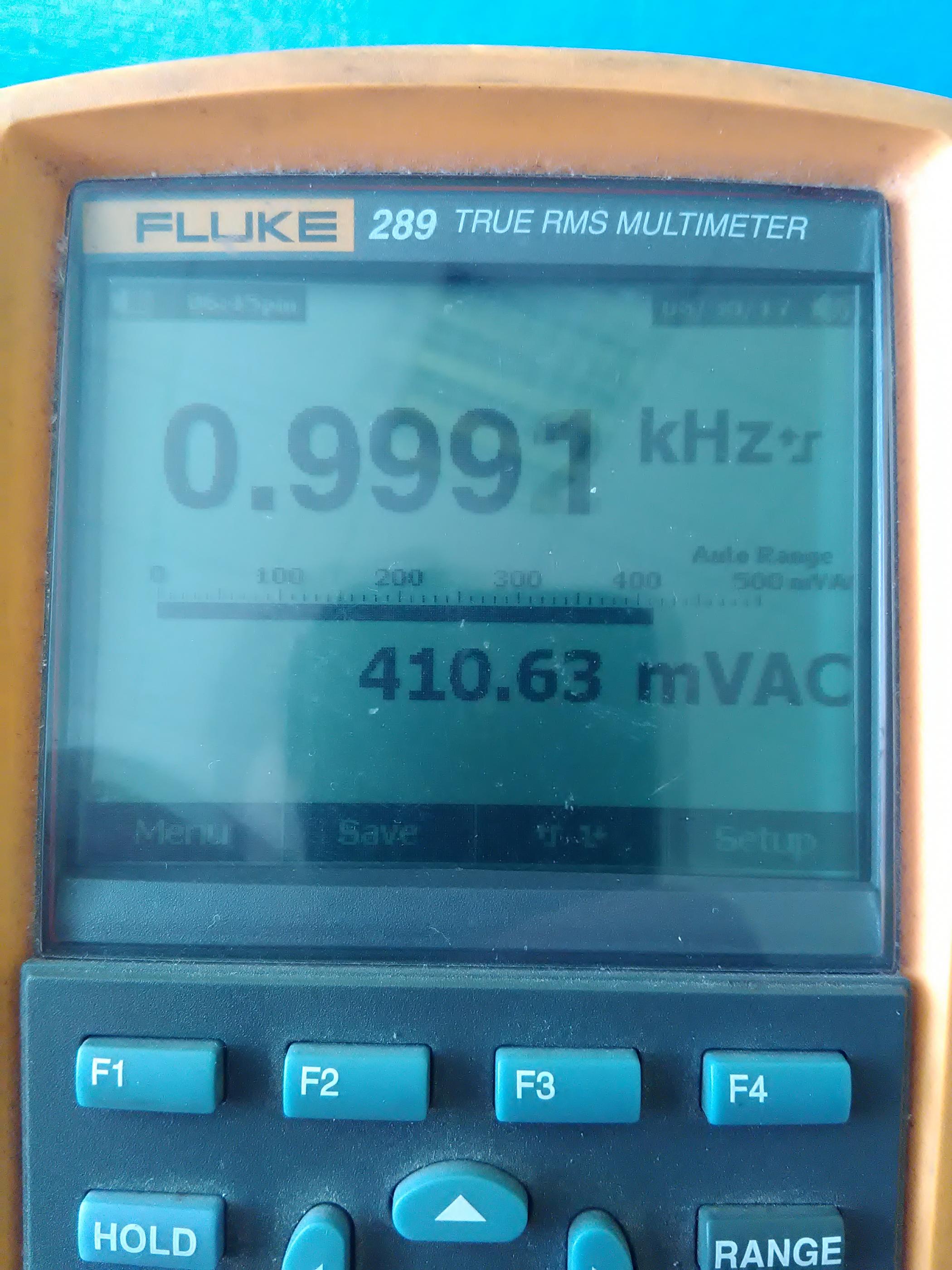

Measured voltage amplitude across the secondary in the following order:
First: 1kHz reference value
Second: -3dB point in the HF region
Third: First resonance
Fourth: Second resonance

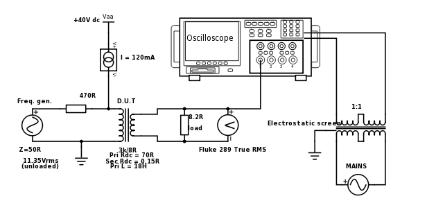

Following up -> -> Measurements with a floating secondary. 🙂
First: 100Hz
Second: 1kHz
Third: 10kHz
Forth: 100kHz

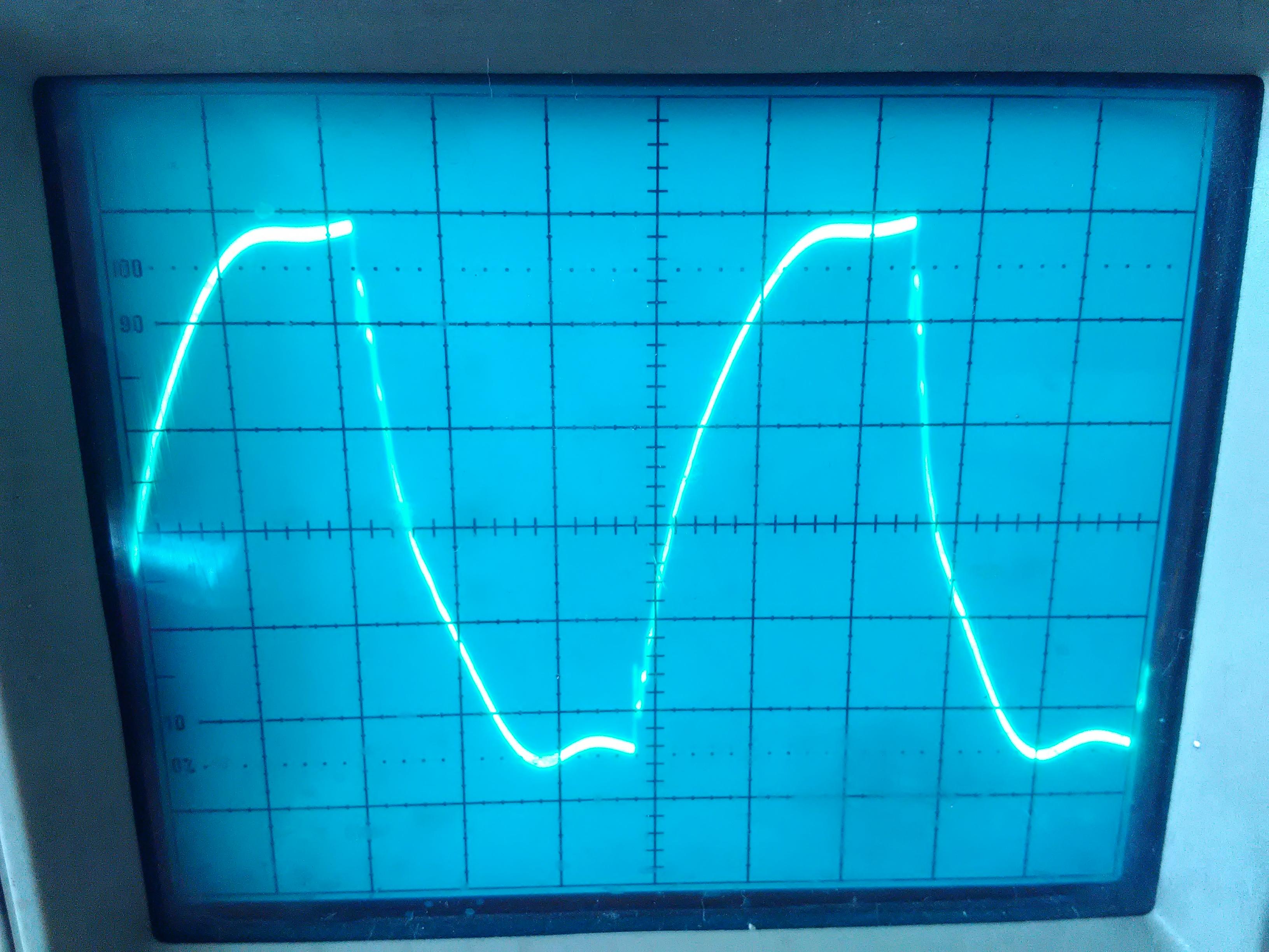

This time, the same measurements are done with the secondary floating. This is done by powering the oscilloscope through a 1:1 isolation transformer with an earthed electrostatic screen.
First: 100Hz
Second: 1kHz
Third: 10kHz
Fourth: 100kHz
Fifth: 1MHz
First: 100Hz
Second: 1kHz
Third: 10kHz
Fourth: 100kHz
Fifth: 1MHz
