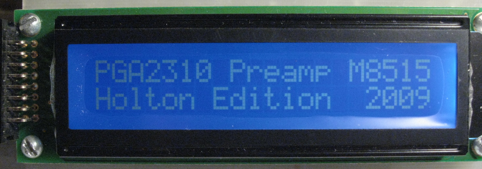

Wait : for atmega16 you must program a second fusebit : Disable Jtag !Today I connected boards and turned power on. Well, I have some problems.
First of all, I reversed A and K on LCD backlight, so it must be corrected (my post #55 in this thread).
Then, pushbutton for on/off can't turn off until backlight is on.

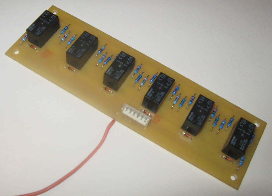

Third, and most important, is that only three of six relays for volume work. I checked resistor, transistor and relay chains, all six of them are working properly, I just don't get enough voltage from pins to open transistor.
I programmed chip with internal 8MHz clock, but I have delay between steps for volume aprox. 1 second, and for input select aprox. 2 seconds. Is it OK?
Tommorow I'll reprogramm chip and, if it still doesn't work properly, I have to try with another mega16. I used all precautions against static electricity, I just don't belive that I damaged it.
And like magic everithing will be working !
The rest off relay are on JTAG lines of MCU and to work as I/O port the JTAG must be disable .
Then : the soft is write in the way as after power on you cannot power off again but after minutes !

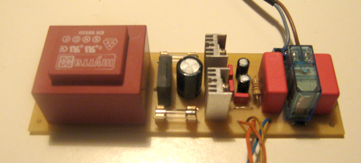

I have now everything done except of pthe power supply. Hopefully today evening, so we're going shoulder by shoulder, dobrivoje! 🙂

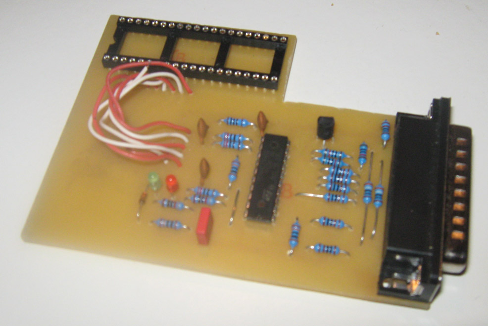

I already wrote that I do not want to hurry, I read all 41 pages of Romanian forum, I knew what i have to do. So, how I did it wrong?
I called my friend Milan to help me about programming. He is expert, but he works with PIC controllers. We downloaded Bascom and realized that it's too complex, then downloaded AVR ISP, which is simple for work. We adjusted everything like it should be, including JTAG disabled and internal clock of 8MHz. It was done in just a few minutes, no problems at all.
What happened? We didn't know that each step must be programmed separately, so we just put program in EEPROM, and nothing else. Today we saw that internal clock is 1MHz and JTAG enabled. We reprogrammed controller and now it works like Swiss clock.

What does it mean -each step? What steps? Explain pls. a bit more, I'm just about to face the same issues 🙂We didn't know that each step must be programmed separately, so we just put program in EEPROM, and nothing else.
@ Vikt0r
Short answer:
Open AVR-ISP, load Danzup's software and adjust fuses and lockbits, then open Device, use Program for EEPROM, Fuses and Lockbits separately.
Then use verify and that's it. Good luck🙂.

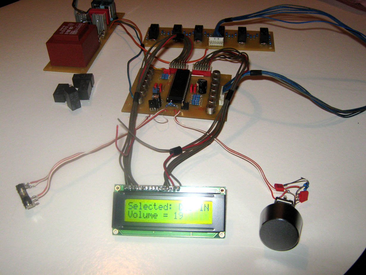

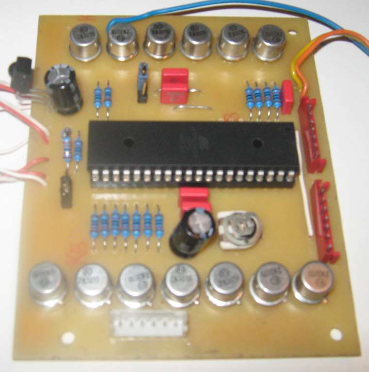

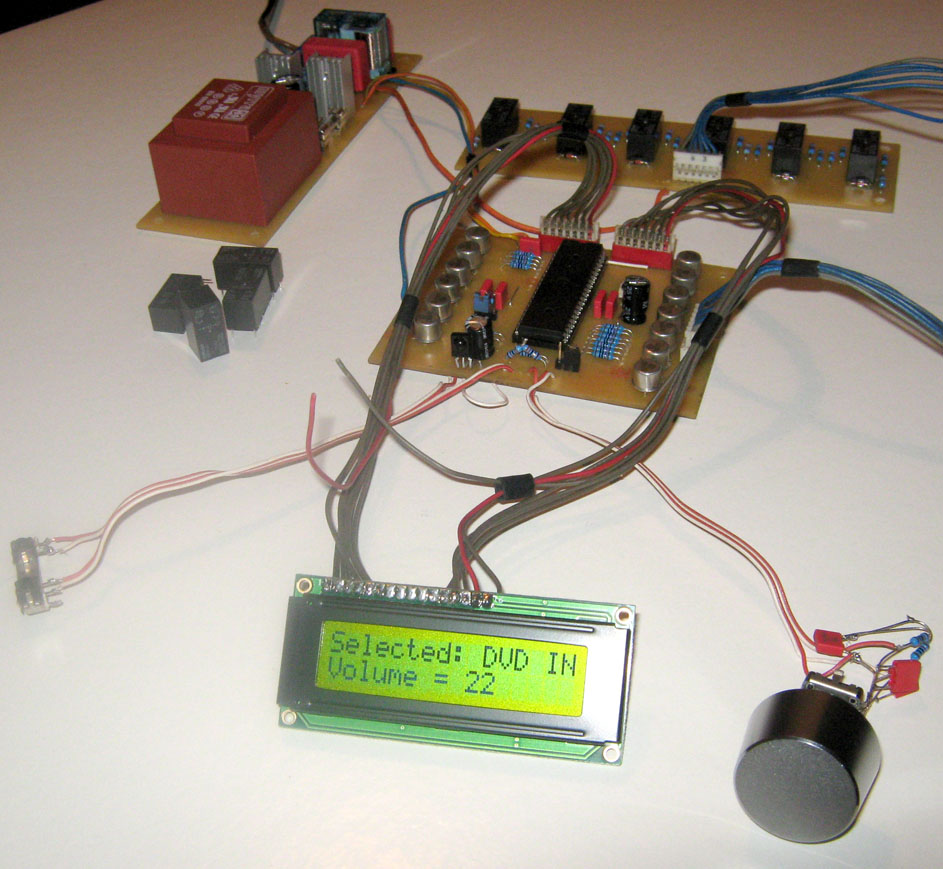

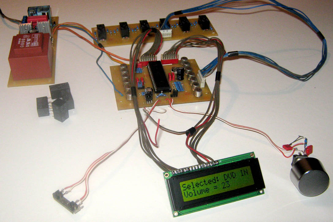

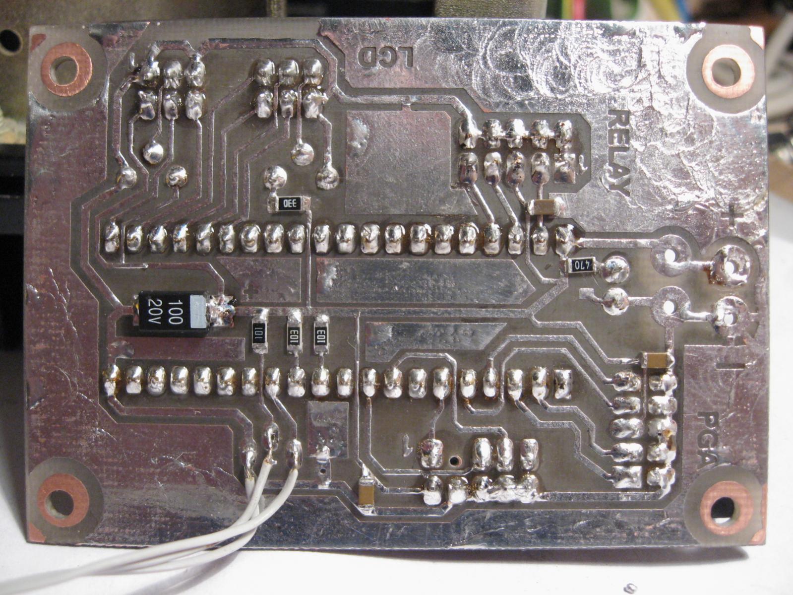

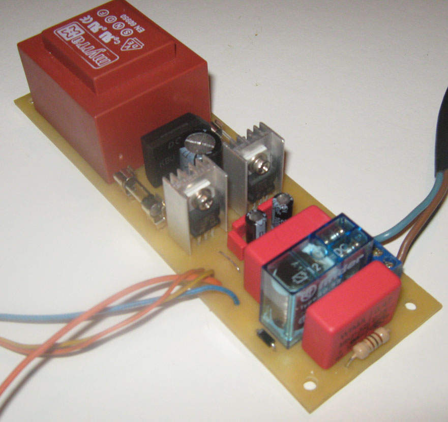

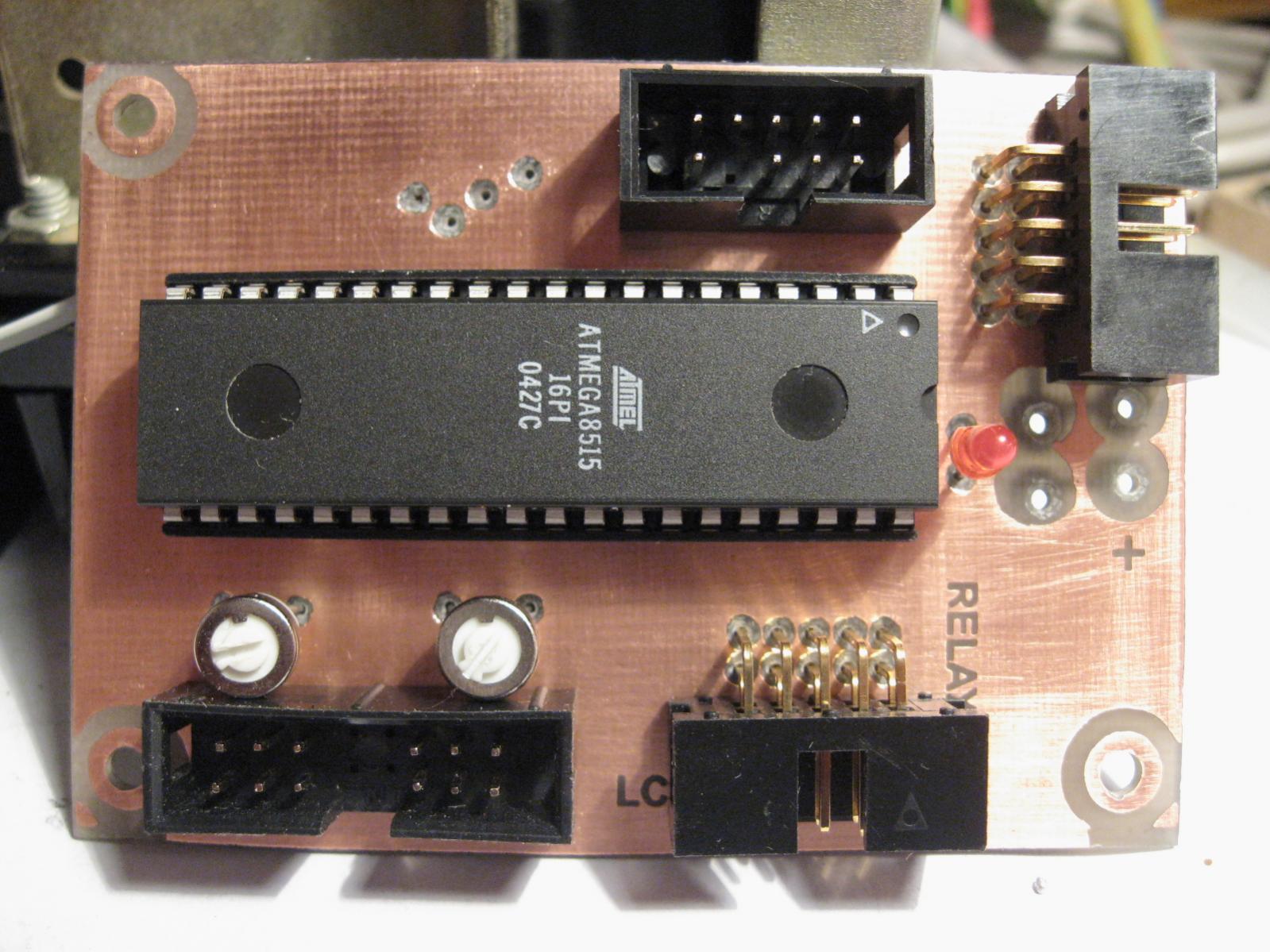

I promised some pictures. Here they are.
What I didn't finish is input board (you can imagine it when you see some relays), because I still don't know how my preamp will look like. Options are one enclosue or two separated (one for audio and one for supply/control). The same reason is for front plate.
Connectors and cables are from old TV's, DVD's and PC's. I'll change them in final version.

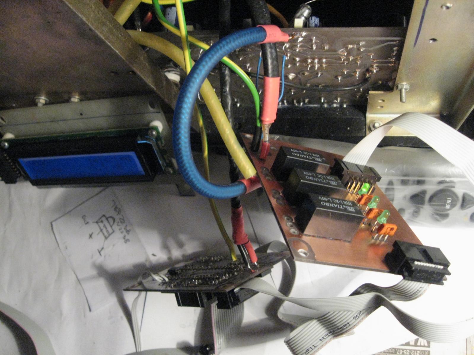

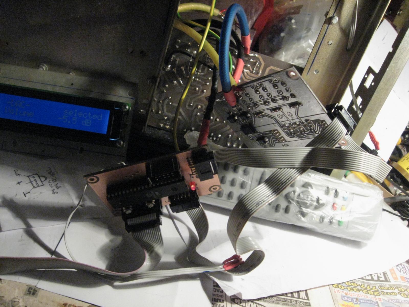

Well, looking at your pictures I remeber the tale about the turtle and the rabbit, where the rabbit was so proud of his speed, that did not notice the hard-working turtle and it reached the finish line 🙂
You work is GREAT, especially I like your PSU, which ashames mine (made on a perfboard) - I wouldn't even show up. 🙂 Oh, and my programmer...well, it looks MUCH simpler 😀 However, I did not try it yet 🙂

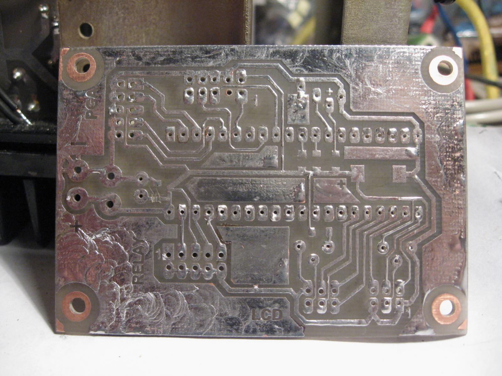

Would you please show some shots of your solder sides..?
P.S. Your project makes me crying - as I have nowhere to source those wonderful rotary encoders... 🙁

@ Vikt0r
1. Don't belive in fairy tales. You are too old for them. Life learned us that rabbit IS faster than turtle.
2. Actually, my PSU is a copy of alex.mm PCB from post #1 of this thread. I just added trafo and replaced some components to fit on one half of Euro format (160x50).
3. Hmmm... I tried to hide solder side of my PCB's. Usually, when I develop foto sensitive laquer, I use permanent marker and straighten all lines and pads. Then I have to wait 24h before etching. I wasn't patient, I wanted results fast and made a mistake. So I had to solder all copper. Looks ugly, but works. The other reason is that I didn't wash flux yet. Now it's too late for pictures, I'll send them tomorrow, maybe in the evening, because I have a lot of obligations.
4. Don't cry. In Serbia you can nowhere buy any rotary encoder. This one is from defective (late, dead) amplified DVD player. I got it from (guess who?) my friend Milan. It would be much better if I could find encoder with pushbutton and there connect select command. It means that you can select input and adjust volume with only one button, by pressing and rotating it.

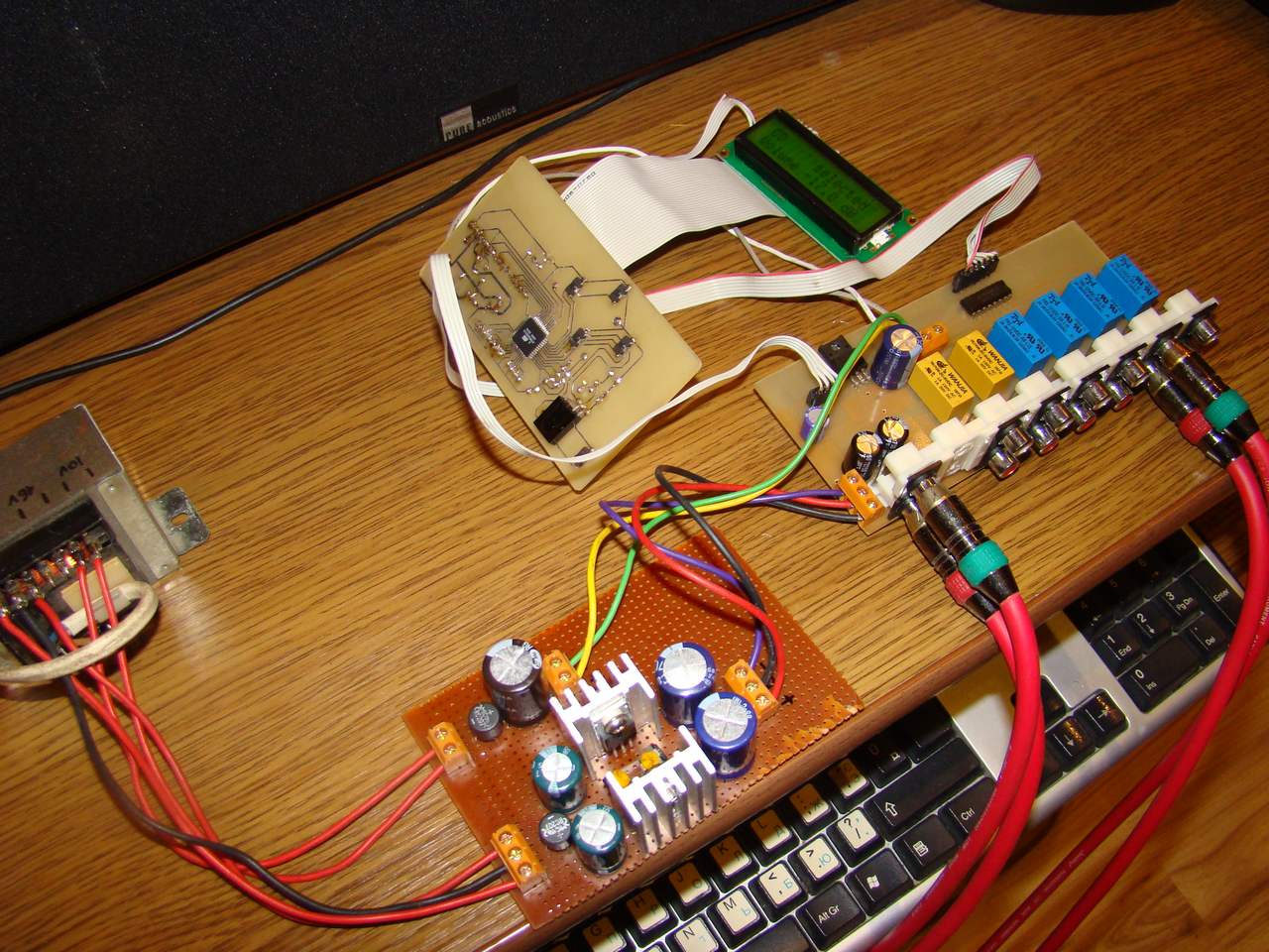

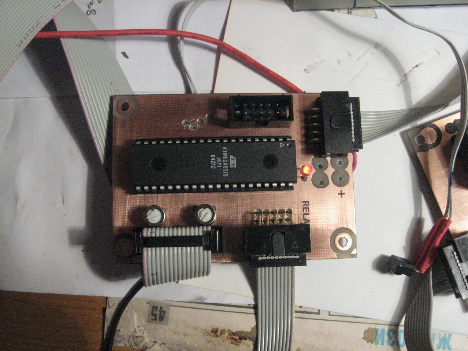

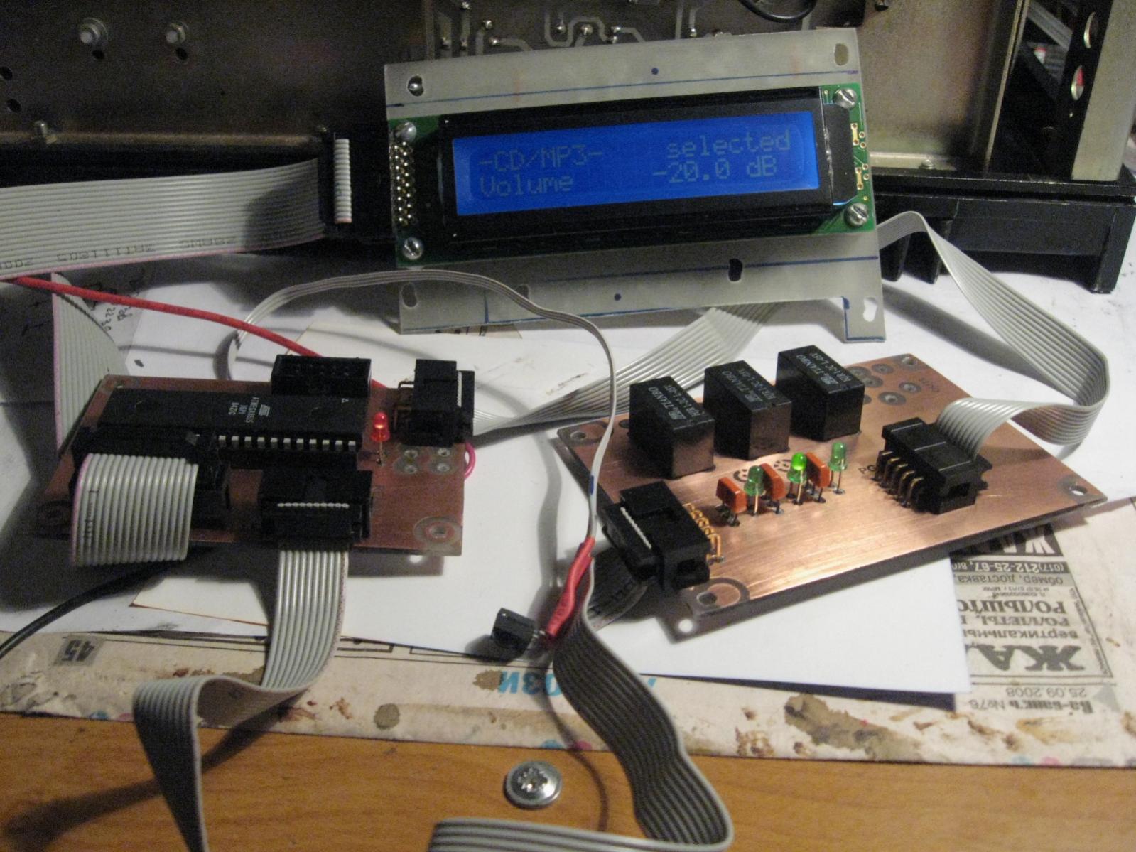

Okay, I owe this... 🙂 Here is how my gear looks like, so far, before it get's into enclosure.

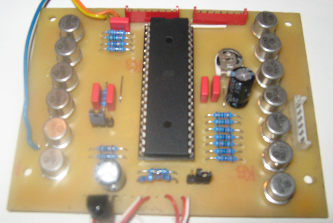

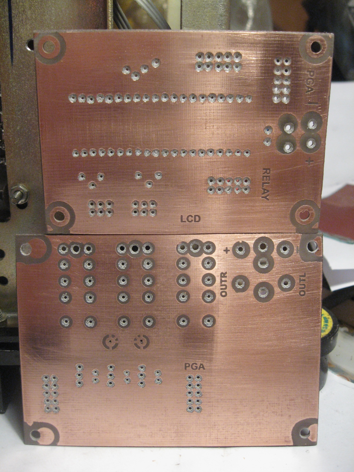

PCB renewal
I remade my version of PGA2310 Volume Control PCB. I decided to make separated PCBs - one PCB for digital part and for analog the other one. All parts from old PCB were unsoldered and soldered again on brand new PCBs. My PGA2310 successfully pass 4th solder/unsolder cycle and now all work perfect!
I changed source code a little bit: on/off feature was removed and some screens were modified.
And some photoes...
And some photoes...
3 more photoes
