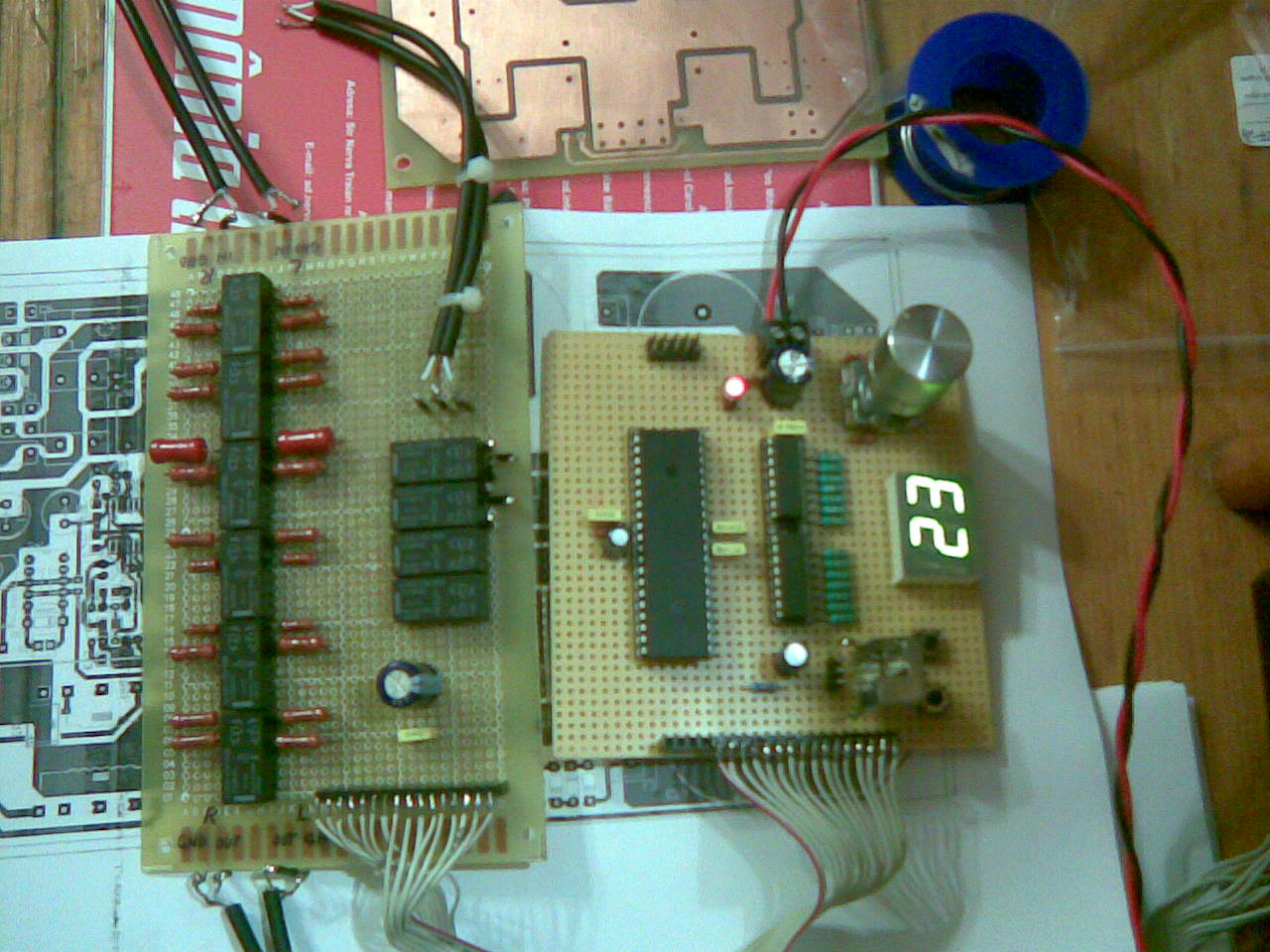

let me say that the majority of my project was realised on perfboard as it was more speedy that way .
All the PCB for different project was not made by me , but by a friend of mine . There are not PCB like you asked for but the other day , by request , I have urged one of my friend ( jkraxy is the nick name on diyaudio ) to do such an PCB as asked you ( it is like reading my mind ) !! But will be some time till will be over . So keep looking here for what will come .
In the picture is a PGA2310 on perfboard :

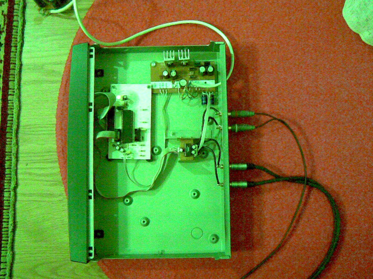

Now I work very slow. I spent a lot of time reading Romanian thread and I've made some PCB's for my project. Actually, seven (control board, power supply, pony prog, front board for display, LCD and pushbuttons, two boards for inputs and two boards for volume.
I understand some people need PCB's. I can't help Vict0r, but coolnose can use my design. It's not optimized because I don't work professionally. I just used halves of Euro format. I can also send design of other PCB's.
I hope in next ten days I'll have my boards completed and tested.
