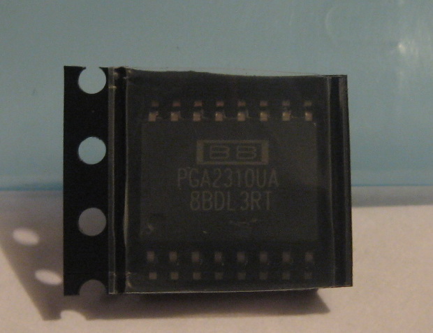

One question I've got: why only +10db?
Datasheet says that +31.5db max should be.
Danzup, can you fix it please?
Thank you.
I have limited to +10dB because if you do the math when you have on input a CD-player which usually have over 2V on output you will have big distortion because you overshoot the analog power voltage on PGA ( the soft I am using in one of my preamplifier I have build I use limit to 0dB !!! because +10dB tend to be to much) .
But if you want I can rewrite again the soft to reach the 31.5dB !
( Are you sure you want that ? )

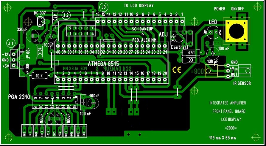

Here is a proposition for pcb layout :

Thank you danzup for PCB layout.
I already made my PCB.

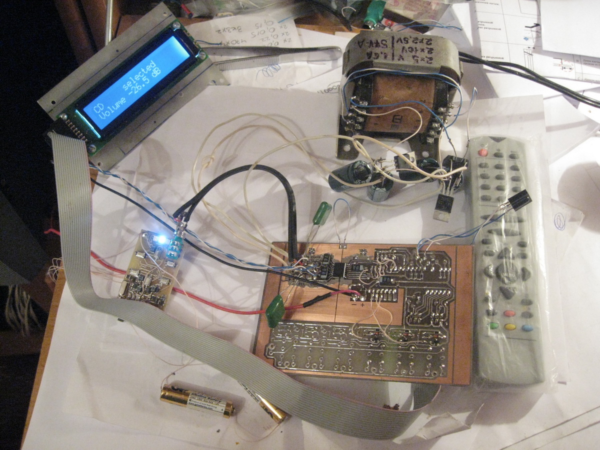

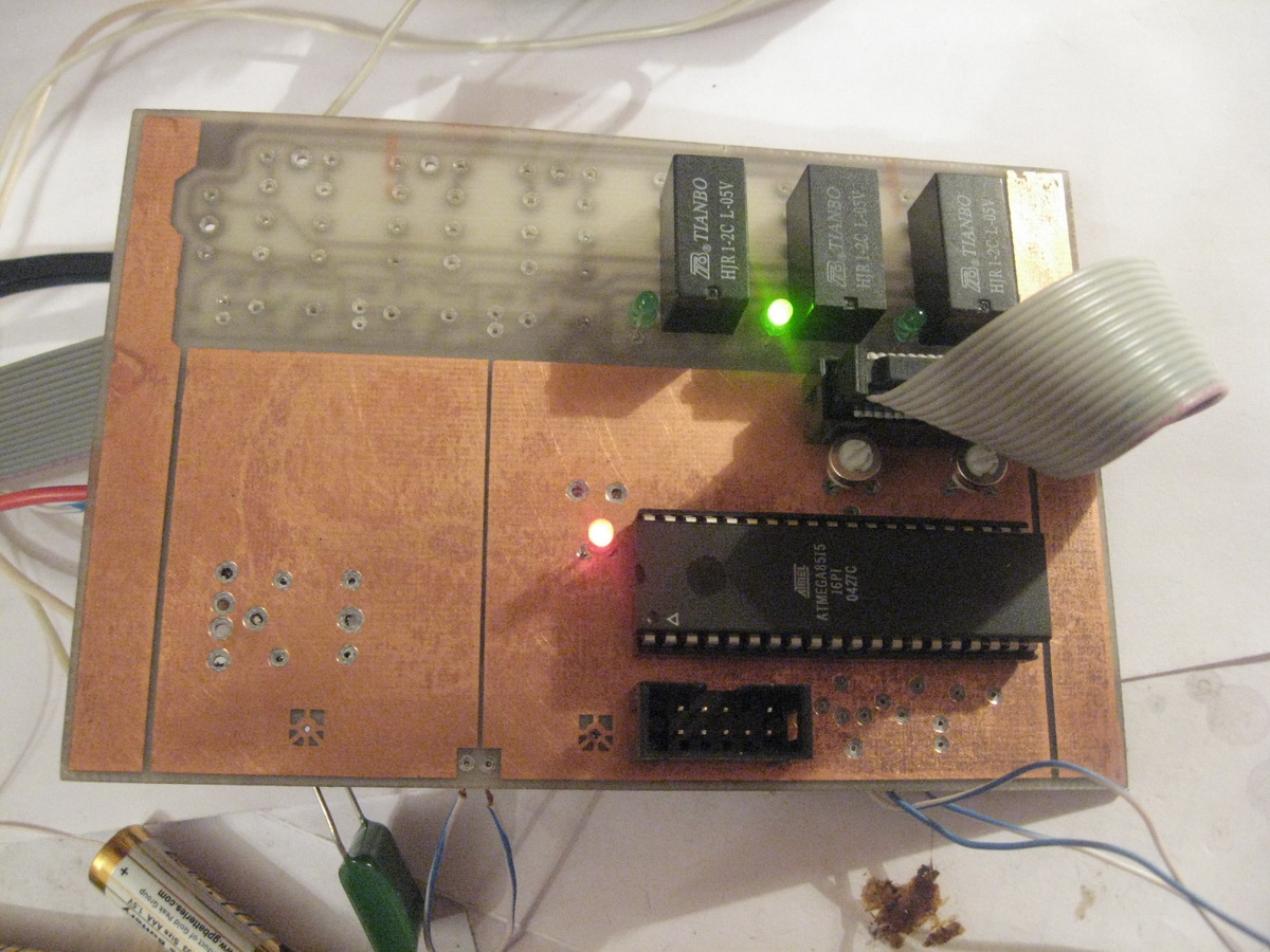

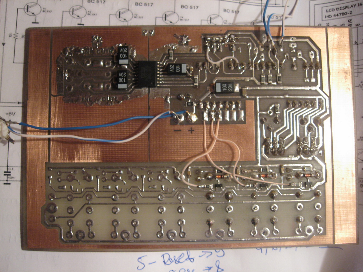

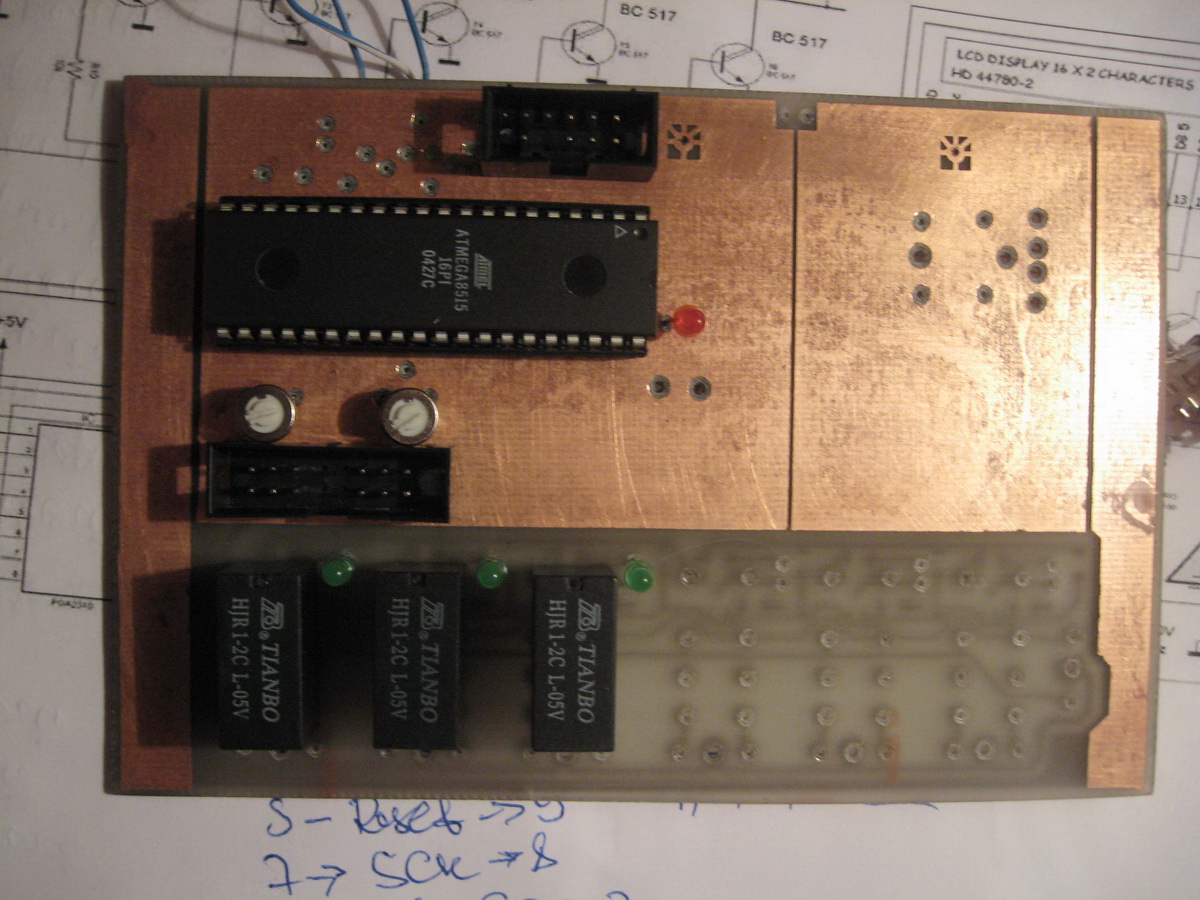

For kit : I have an kit with pcb etched on-house using toner transfer technique with 6 input to select , cost without transport : 50 euro (schematics and pcb posted here on first page
1. Volume controller / source selector for motor potentiometer ( like Alps blue velvet ) : )

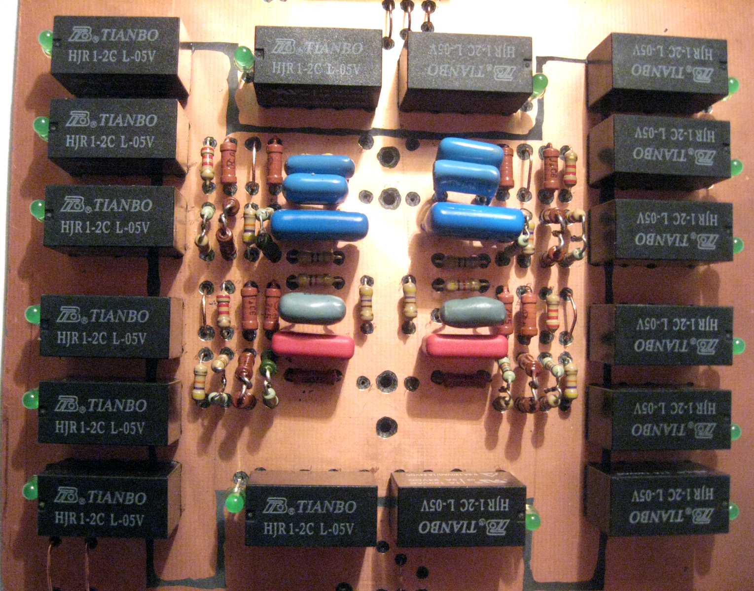

3. Control and audio source selection with relay and r2r volume
- volume with quality MELF resistors for r2r or shunt adjusting
- infrared remote control in the stop / start amplifier
- selection from 4 sources of signal relays
- display with 16 x 2 or 20x2 LCD
- switch and encoder for selections
Firmware for this project (the .bin and .hex files ready for programming the atmega16) .
You must also write 2 fusebits in atmega16 :
- Jtag disable
- Internal 8Mhz RC oscillator

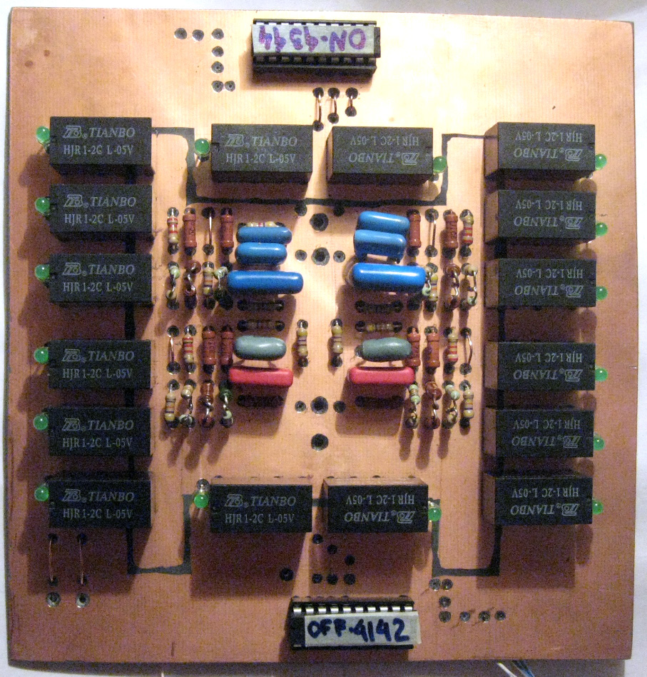

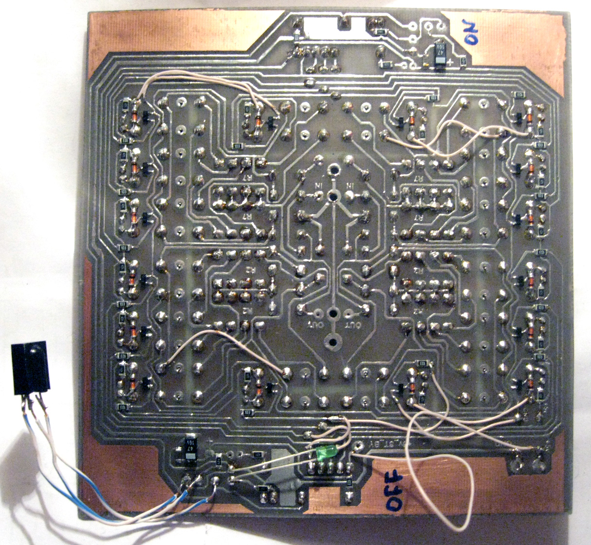

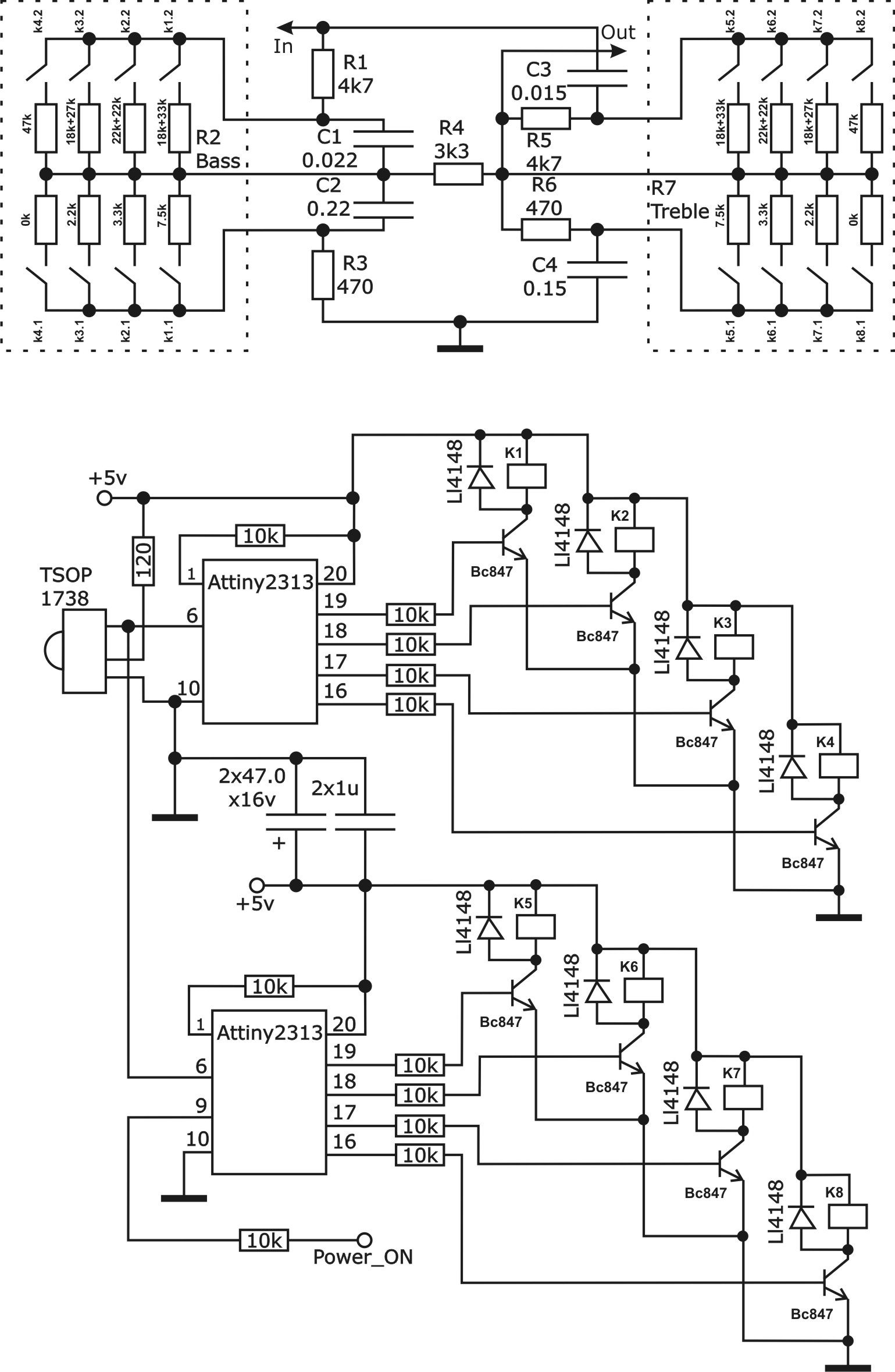

I will post some time soft and schematics with one atmega16 with r/2r 6 relay for volume and 7 relay for bass and 7 relay for treble controller (exactly like your but extended for 7 relay each tone control : bass and treble for 0dB in the middle and -5dB, -10dB ,-15dB and +5dB , +10dB , +15dB on both ).
It was made by me in year 2007 but never posted ....
here the schematics :
http://i31.tinypic.com/necfb5.jpg
