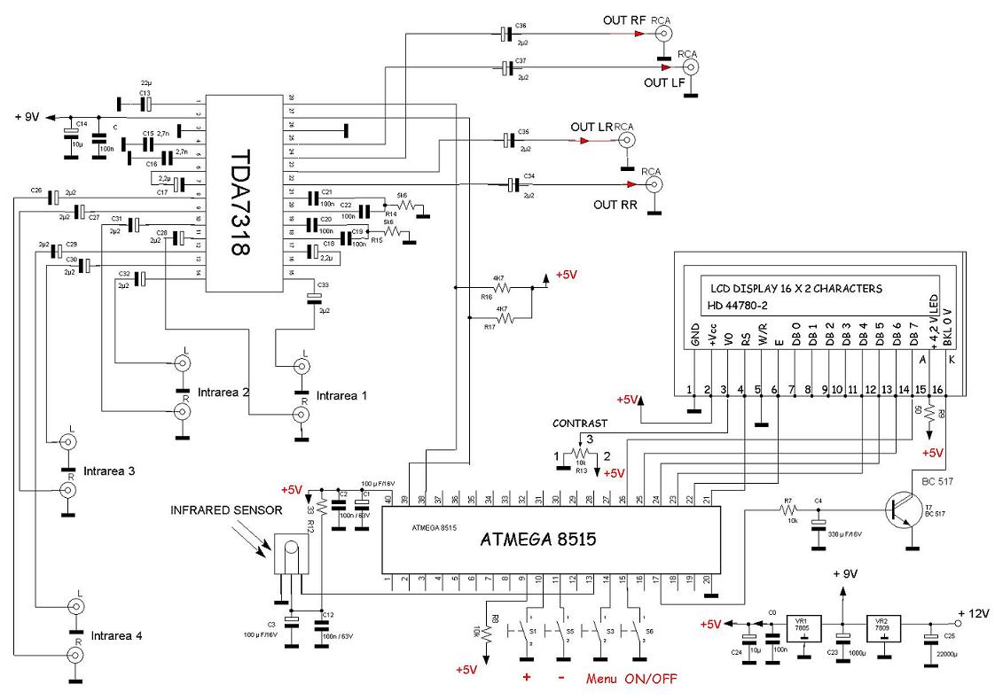

Look in the romanian forum : Forumul Electronistilor the organized links to schematics and firmware version.hello.

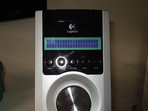

I'm new on this forum.sunt interested in this project since Logitech Z5500 controller has failed. want to reuse Z5500 with atmel and 2x20 display.
I would like to tell me which version is suitable for display hex 2x20. and PCB layout. I want to use the control with TDA 7318. View attachment 420065
Anyway for that schematic there are some version of firmware ( but with switch button and not with encoder as in Logitech ) i have attached here tda_7328_ctrl_v13
Also there is a schematic and a firmware with atmega8 micro if you search there.
