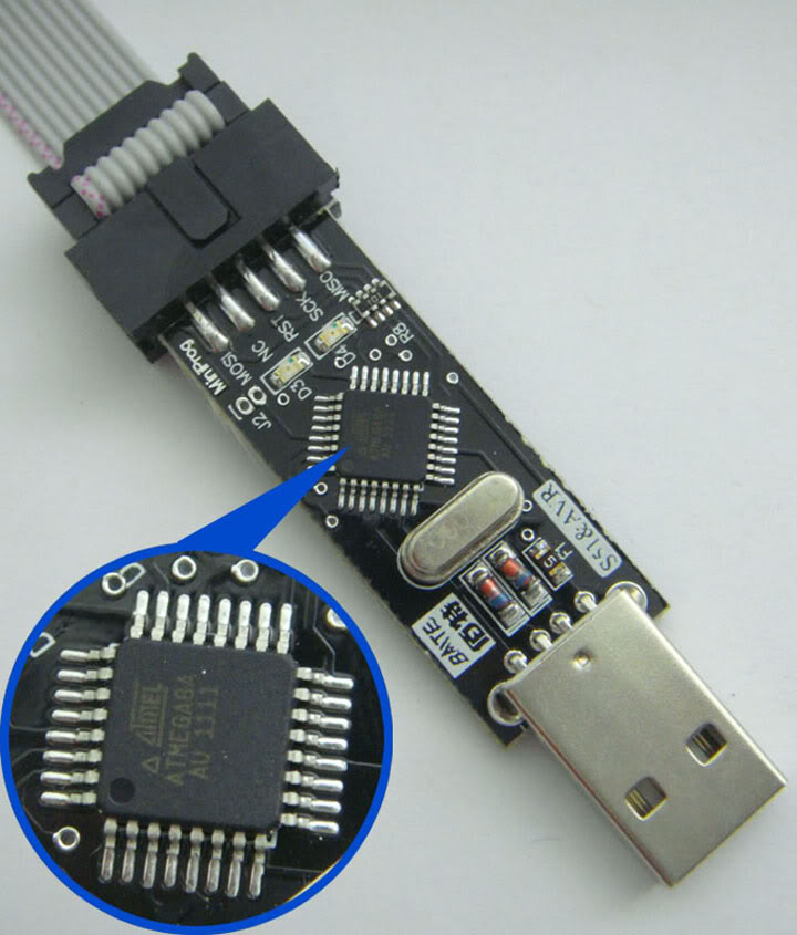

I was hoping do see the modified .bas file but this is OK.
Going to give up for now, can get the programer (USBASP) to connect to the atmega.
Tried Ponyprog, avrstudio, winavr, extreme burner and a free version from bascom avr and nothing.
Going to look for a serial programer.

what USBASP programmer did you get link
I used mine USBASP and it was OK
I used Bascom & khazama both works
Mine have 2 jumpers 1 for programmer update and other to select 5V or 3.3V
did you install libusb driver ?? see http://www.fischl.de/usbasp/

The .bas file in the .zip is the original one all the line for the PGA2310 are still there (or I'm missing something)
My USBASP is the black one, I know that there is at least 1 jumper for the 5V/3.3V selection but not sure about the second one.
About the software I'm starting to think that the problem is my laptop ( Vaio VGN-NR71B with Win 7 )
What is doing my head in is that I programed hundreds of avrs before (8515, atmega128...) and 32bits processors (Jtag) for digital set top boxes and never had so much trouble.

you still just write a color of you'r USBASP
to see what version yo have I do need the link to the USBASP you got
there are some of them that use reg as USB HID not USBASP so you need other program for this models
on ebay its the one with cover in many colors
software AVR_fighter
or serach for progisp that works ok
or check out uwezi blog about how to make it a "real" USBASP
This is the one I bought.
Bought from UK seller but looks like they all come from the same place.

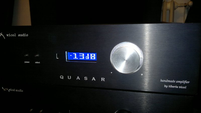

hey,
looks nice Tibi
Only 1 error i found
the MUTE is located 1 place wrong in menu
if you look at video around 3.44 min 🙂
looks nice Tibi
Thanks FarmTech !
Mute was added in main menu due a custom version made for a client.
Normally this should be available only from remote, but ... I'm not decided to keep or remove him.
Thanks for observation.
Tibi

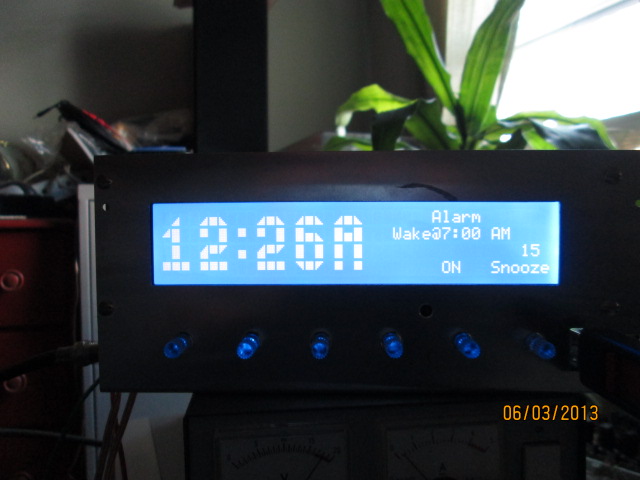

Hello,
I have made big digits for a 4-line (4x40) character display, Newhaven NHD-0440WH-ATFH-JT or NHD-0440AZ-FL-YBW. I used the following code. I did not include the variable definitions but it is fairly obvious what they would be. It reqiures the xmega library that I have posted at MCS Electronics a few times. This code was posted in the public domain, so I gave credit to the original author. I also fixed a few bugs as well. It is the basics of the alarm clock function for my radio/media player. I use push button encoders for the UI. At night when in alarm set mode, I use big digits to display the current time. As you can see I use the Pca8565 as a RTC. It works great. Keeps time for days on a small super cap.
Enjoy and hope you can make use of it.
Rick Savas
Rick Savas
