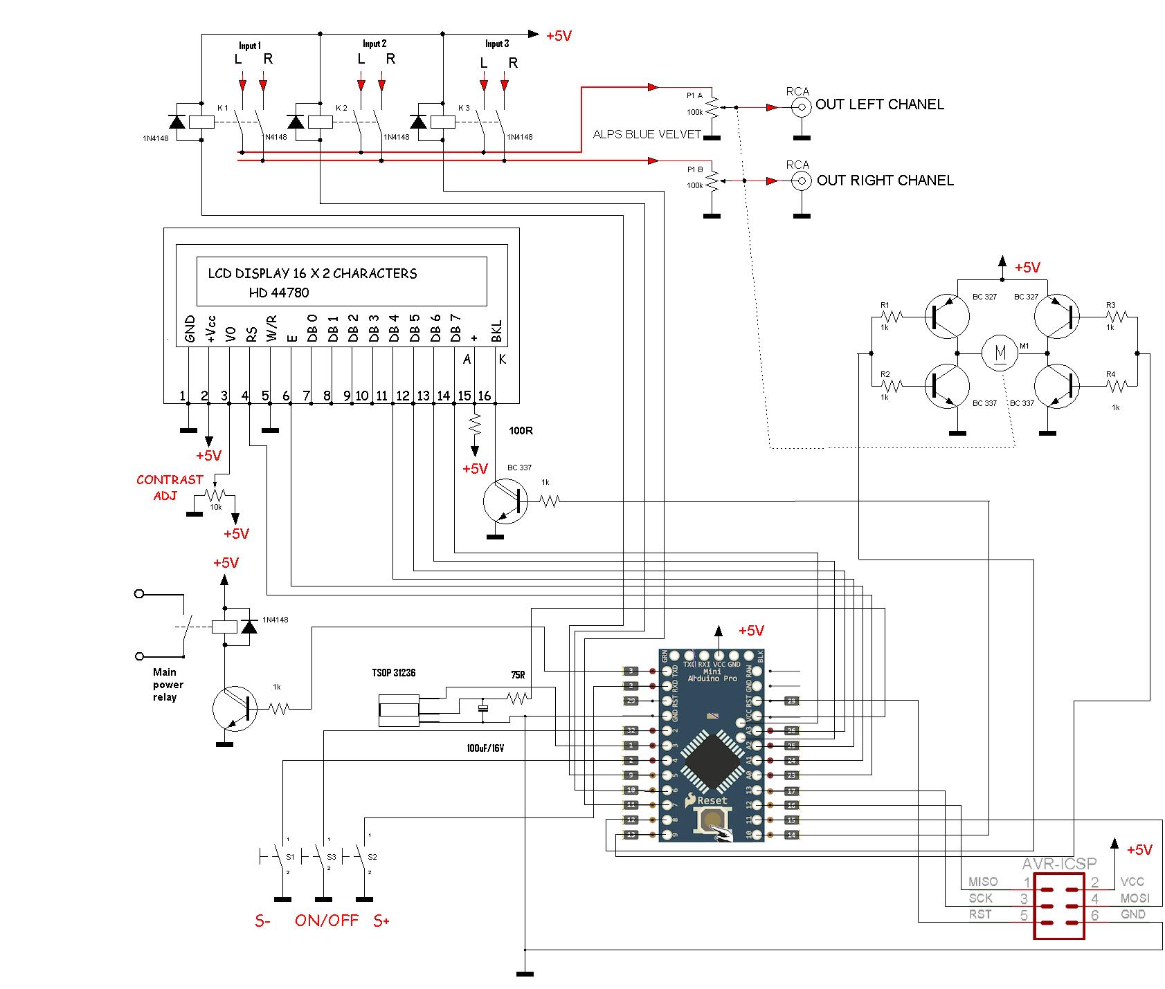

Ardu alps control
Here you find the promised control for any motor volume with Arduino mini pro .Schematics and firmware also some hints about how to breadboard the whole construction.
I have use a breadboard for 3 relay that select input . This will be used also for PGA2310 selection of input.
