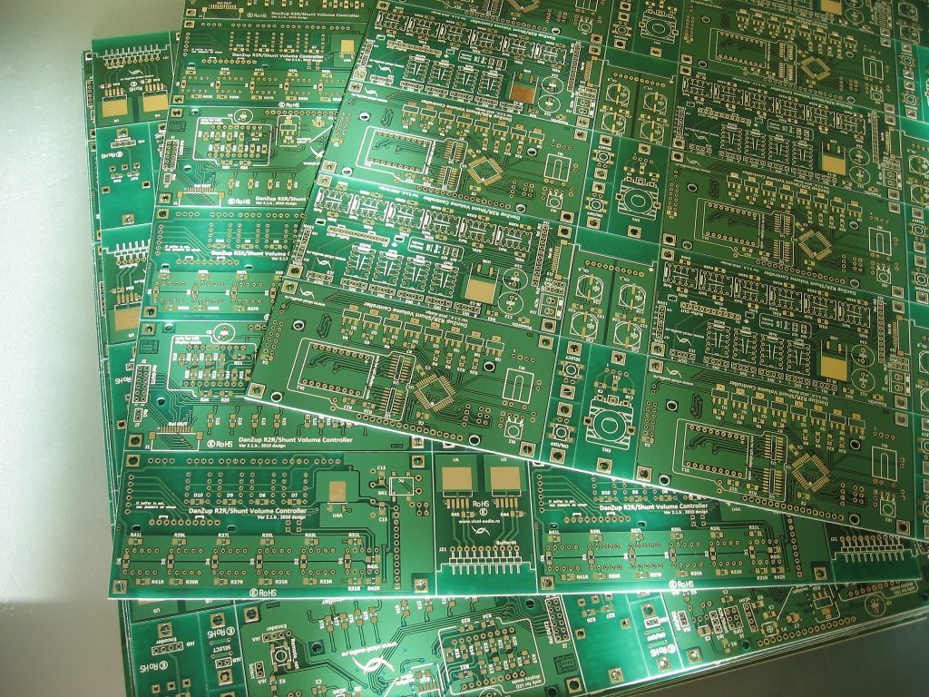

new boards ver 2.1b
DanZup r2r/shunt volume controller PCB version2.1b
Tibi
