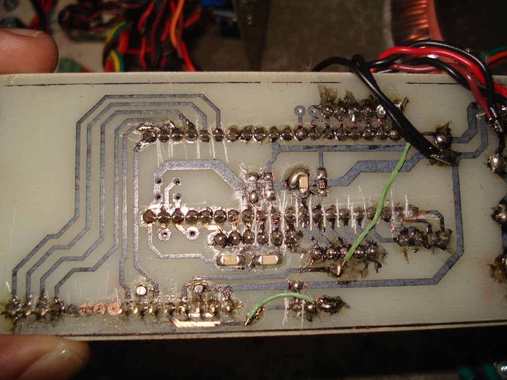

i cannont connect any device and play FM radio. when it plays static of non tuned radio goes. and if i touch avr when radio is connected i get very very bad statc,

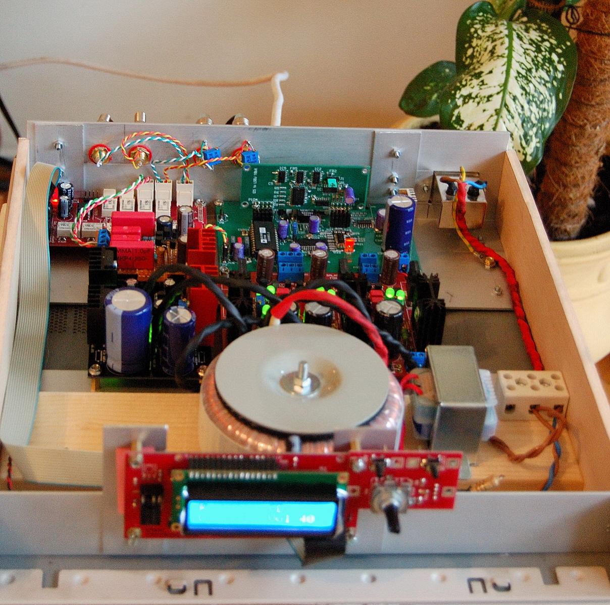

Can you take a picture of you build so we can see how it is connectet in the case ?
YES I WILL , currenly down ith some fever give a few days, once i m up and running i will post my picture.
but i have not changed anthing in the box exect the cpu card which goes behind the 16X2 large LCD, like a size to size pigiback/
will post the image shortly and some pcb layout pics

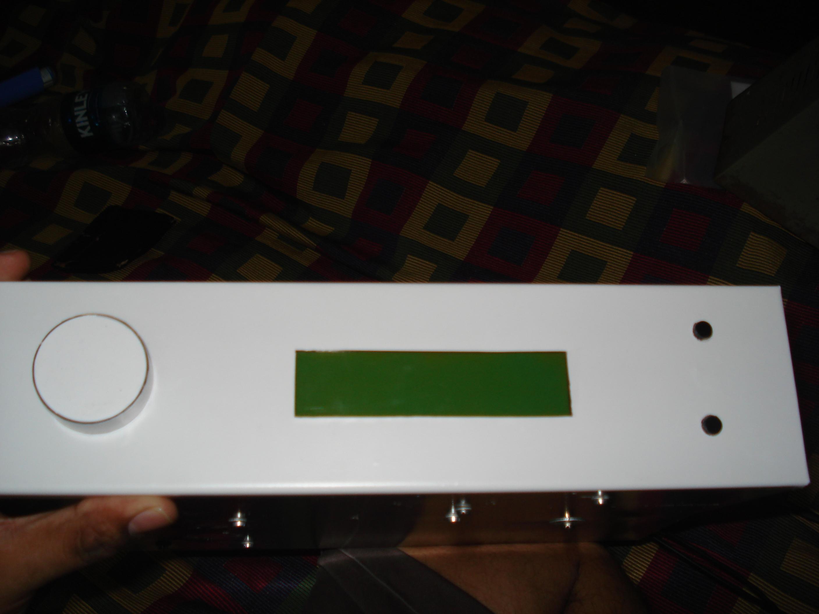

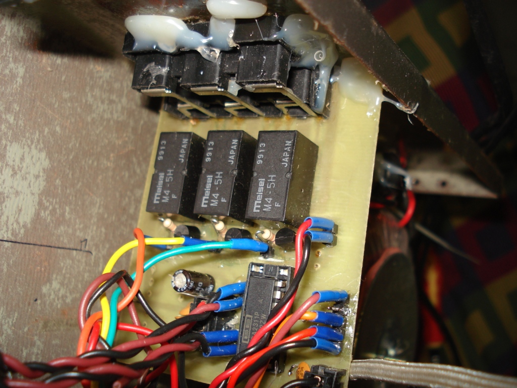

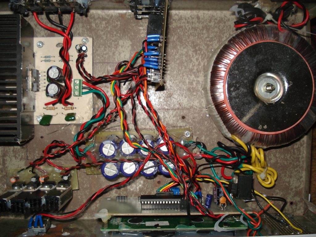

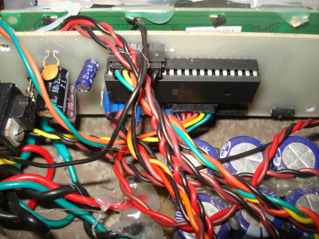

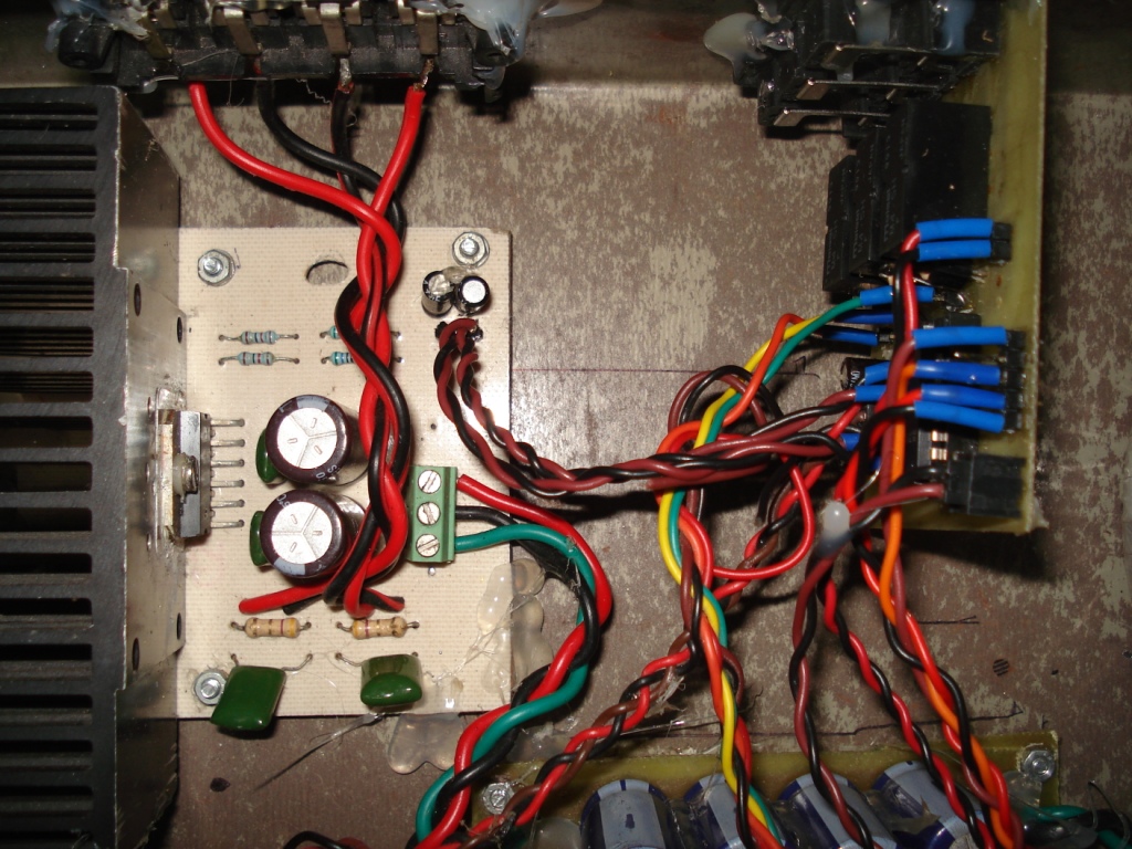

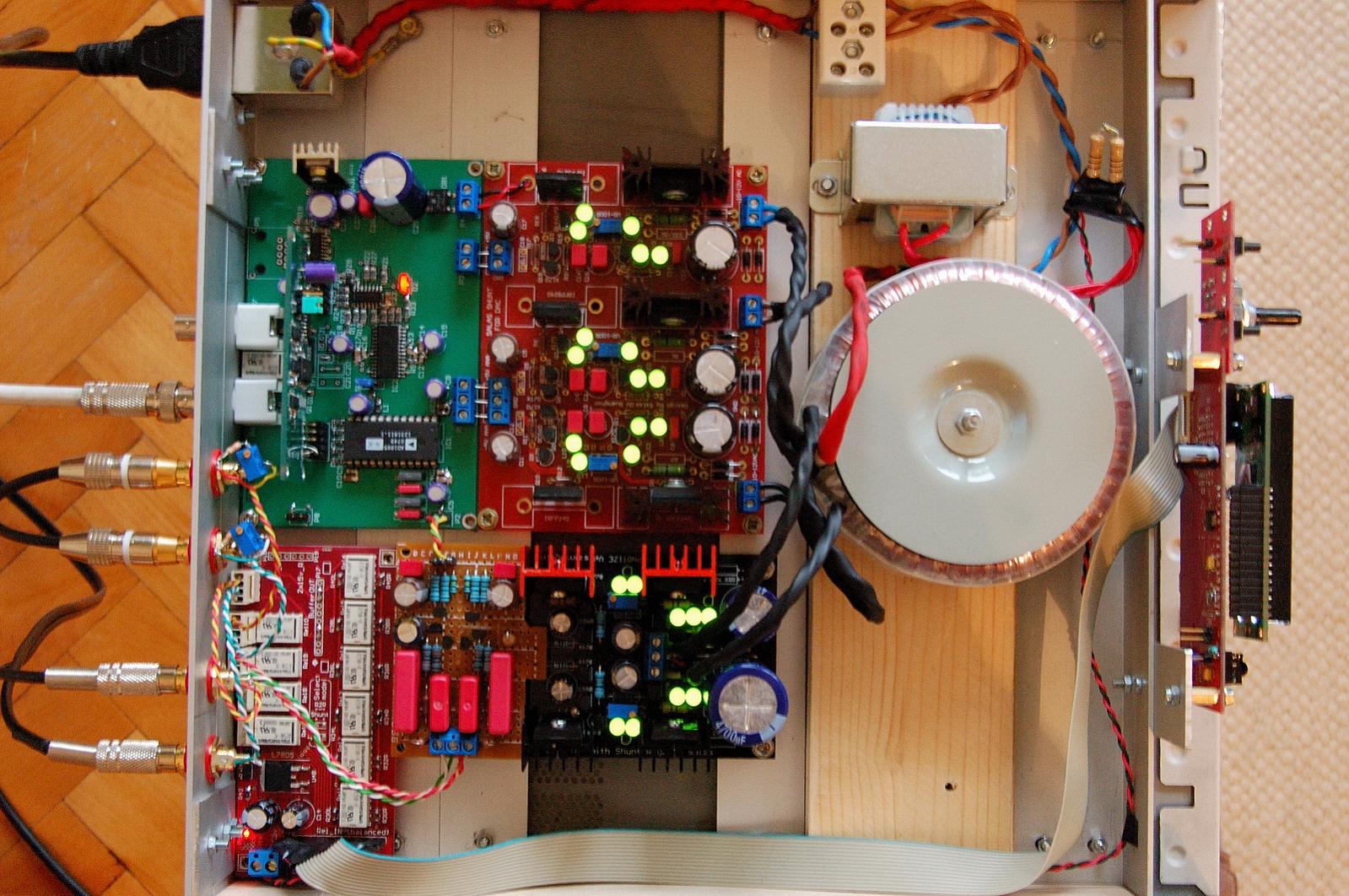

i m posting the pics of the assembled amp, i know too many wires but this was the case when i was using th pic18F452 and elektors program in it, and i could listen to radio with out issue

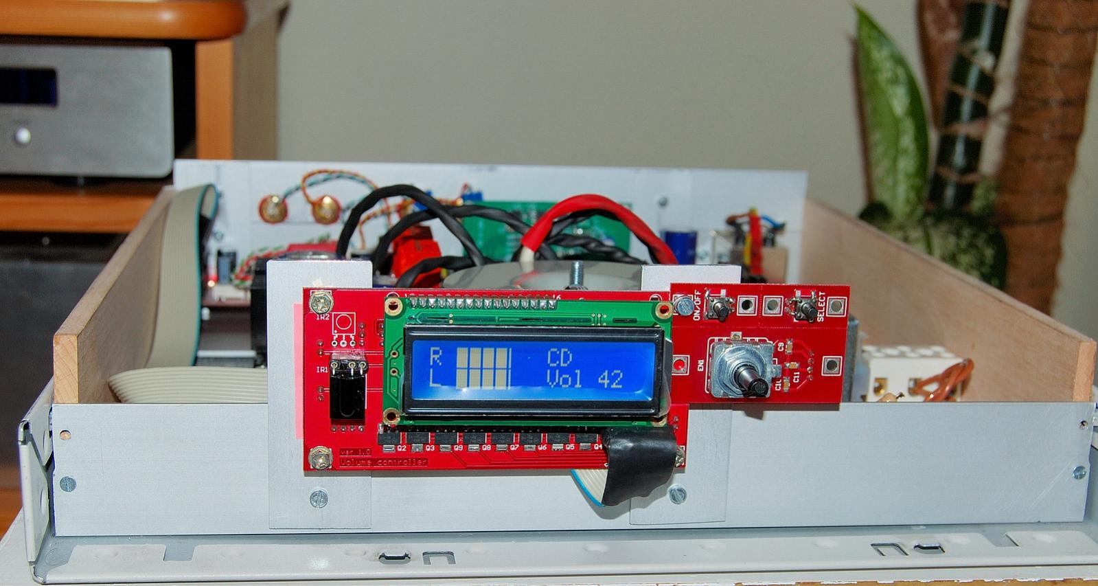

My take on this volume controller, completed 80% but its already working great :cheers:
It's attached after a NOS DAC + JBoz kinda line amp.
I plan to add in the future a B1 buffer after the controller to have lower the output impendace.
Of course there is a lot of work on the case yet. I want to paint it black and to add nice wood front and back panels. Lets see what wood my carpenter friend recommends.
Cheers!
p.s. @FarmTech: I found some bugs with the volume controller software, I will create an error list and send it to you, hope you can fix them

hii did you see the images i sent to you in the mail
Hi, Yes just got time to study them , but you write you will make a smal schematic , thats was what I was wating for
Main board AVR , clean the soildering up this can only make it better ,
check that your relay for RADIO is working ok (connect radio on other input for test)
You have alot of wires OMG , never seen one like this 🙂

yes i know the wiring its a bit just tooo much , i plan to reduce it but i m not getting time to make a sexy pcb, for it. such that i would have all the regulator ic , power amp chip, and pga2311A and also a 3 on one RCA jack, but then only issue that makes me make differnt boards is , cabinet fabrication, as i have access to ready made cabs of 3"h 12" w 8"D , so then cutting lcd cut out, making holes for rca sockets , is a bit tooo much ( some times a bit lazy as i have to go out and get it done, )
