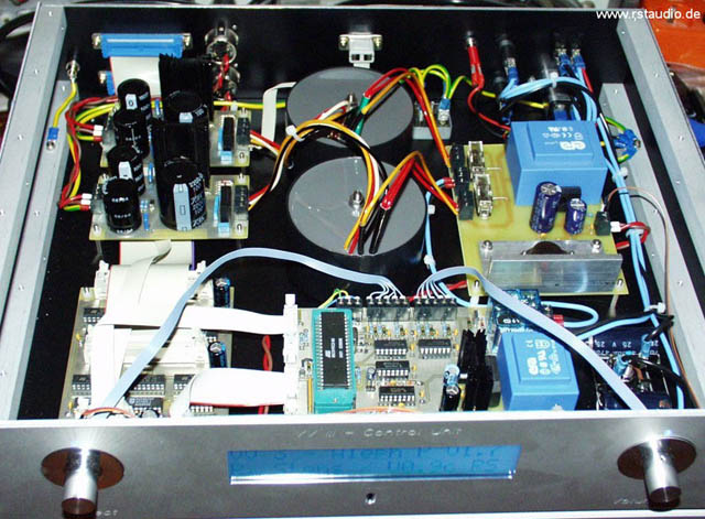

aditya gave me an idea. I want two encoders, one for input selector, other for volume and mode. Why? Well, the answer is symmetry.
Look at picture 1. Exellent preamp, very clever project. What do we see? Two encoders.
Look at picture 2. Very expensive preamp, two encoders.

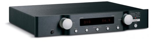

Look at picture 3. One of the best DIY projects I've ever seen. Complete symmetry inside, but front plate unfinished. How to improve it? Make it symetrical. Use two encoders.
well three encoder need 3 interrupts and not sure anyone like to have 3 encoders on the front
Why do you like to have 3 encoders ?

wow some one got a idea bug from my idea,, cool but after re thinking what farmtech said i think one encoder is also not bad, since fabricating front plate, or even making a new... cabinet is a nice headache (mainly due to cost ) in bombay(india)

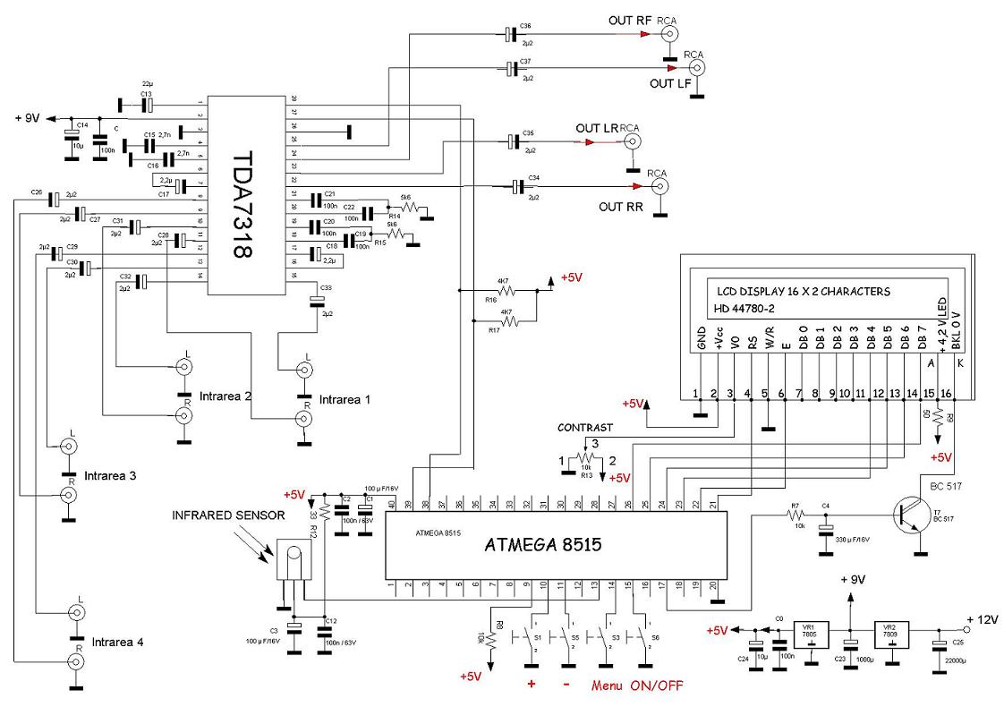

hi how to remove the rc5 code from the .bas file, post 370, dont want to use a remote, cnat get rc5 ir 36khz only getting 38khz ir sensor, and secondly my lovely wife will get a god's hand if a remote was present,
so what to delete in code from post 370
i want to remove menu optin and make it jsut toggle switch for input selection how to do it, such that at what ever the volume the chip maybe , i can just click the button and toggle between the input channels. thanks a lot for all the help, with warm regards aditya
