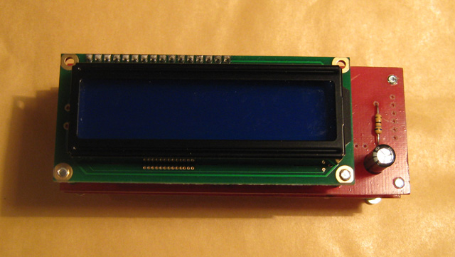

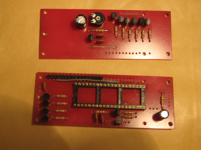

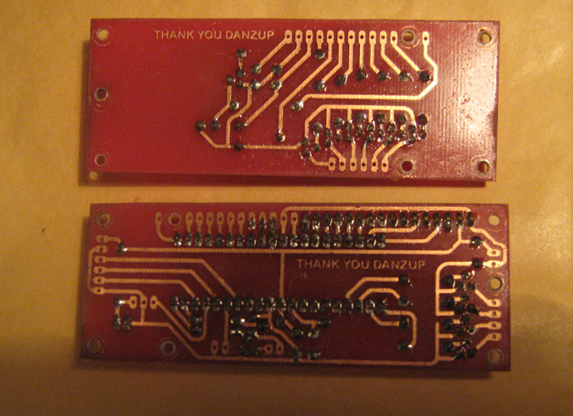

As you already know, I had great luck to be beta-tester of FarmTech's firmware. I'm not expert, I'm just common user, so I tried to do my part of deal the best I could.
I must say it was easy. FarmTech made brilliant firmware. Everything he sent to me worked without problems. I tried to outwit his firmware, but it was impossible.
Also, I work like. I don't have much free time for my hobby, so I had to steal time from my job. FarmTech wrote program for VU meter on LCD. It looks wonderfull, but you must have extra hardware for this feature. He gave schematic for half-wave rectifier in post #302. I made PCB.
Hi dobrivojem
Tank you so muts for the beta testing and then PCB layout for both Lm324 & LM358
The pcb look nice you did a fine job.
I notest that you dont use a shielded 2 or 3 conductor audio cable
for input to opamp from line signal
this "can" be reason for pickup some noise and feed it to the line out
I dont have any problems with noise even if my test setup was a breadboard with many wire connects , but just in case its a good idea to use shielded audio cable.

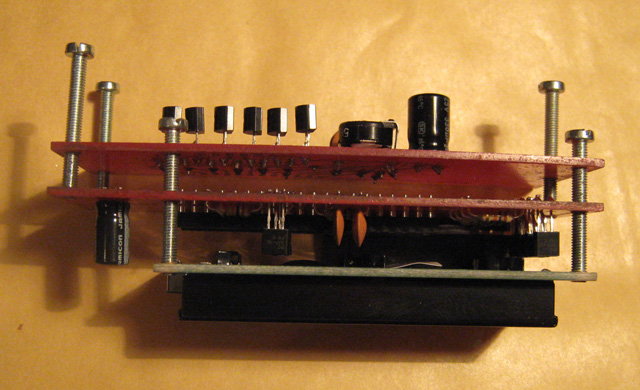

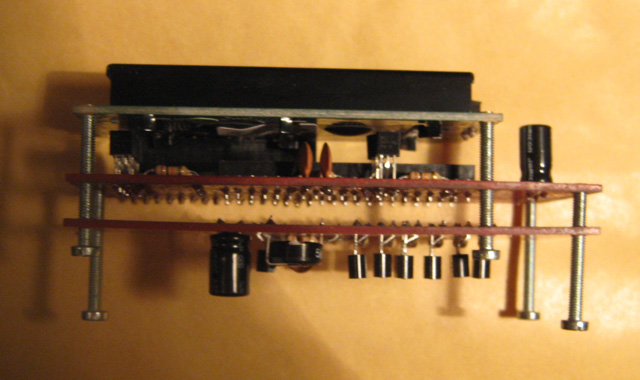

And when you put all together, you get something like this.
I also plan to redesign PCBs for input selector and relays.
Wow looks like you are a "pro" pcb maker , nice simple 1 layer pcb
well done .

Kim, don't thank me. It was pleasure for me.
Yes, I know a lot about shielding cables, ground loops etc, because audio is my field of interest. All conductors from picture are temporary, I was eager to see the result as soon as possible. When I put all vegetables in an enclosure, it will look much better.

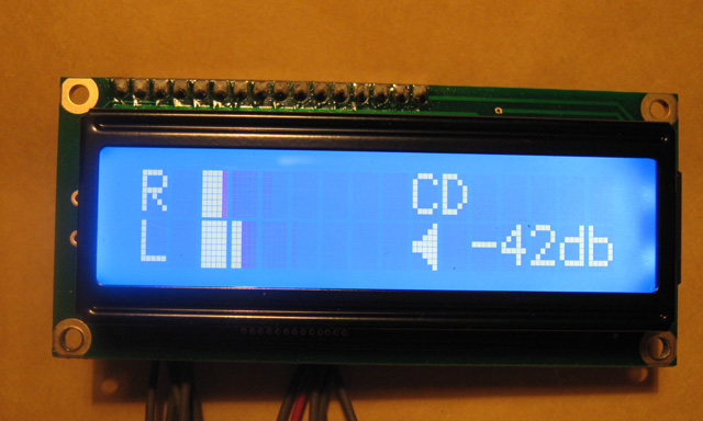

Firmware for Danzup Ir Volume Control Ver.1.6(c) VU Meter RC5 / Edit text
Now it time to release the firmware for Danzup´s Ir Volume Control Ver.1.6(c)
Here is a short info of what to do and how to do it
addon files in Zip : Hex & Bin for Atmega16
and pictures of how to connect it to controller ONLY LCD version !
Enjoy 🙂

Got the MSGEQ7 (an 7 band Graphic Equalizer) running smoot now
If anyone like it on the lcd of Danzup´s controller I add the code (same port as VU)
just had a thought, project 1 could be used to power the pot for an LDR volume control like the light speed or the lighter note. Has anyone tried this?
small video of lcd
