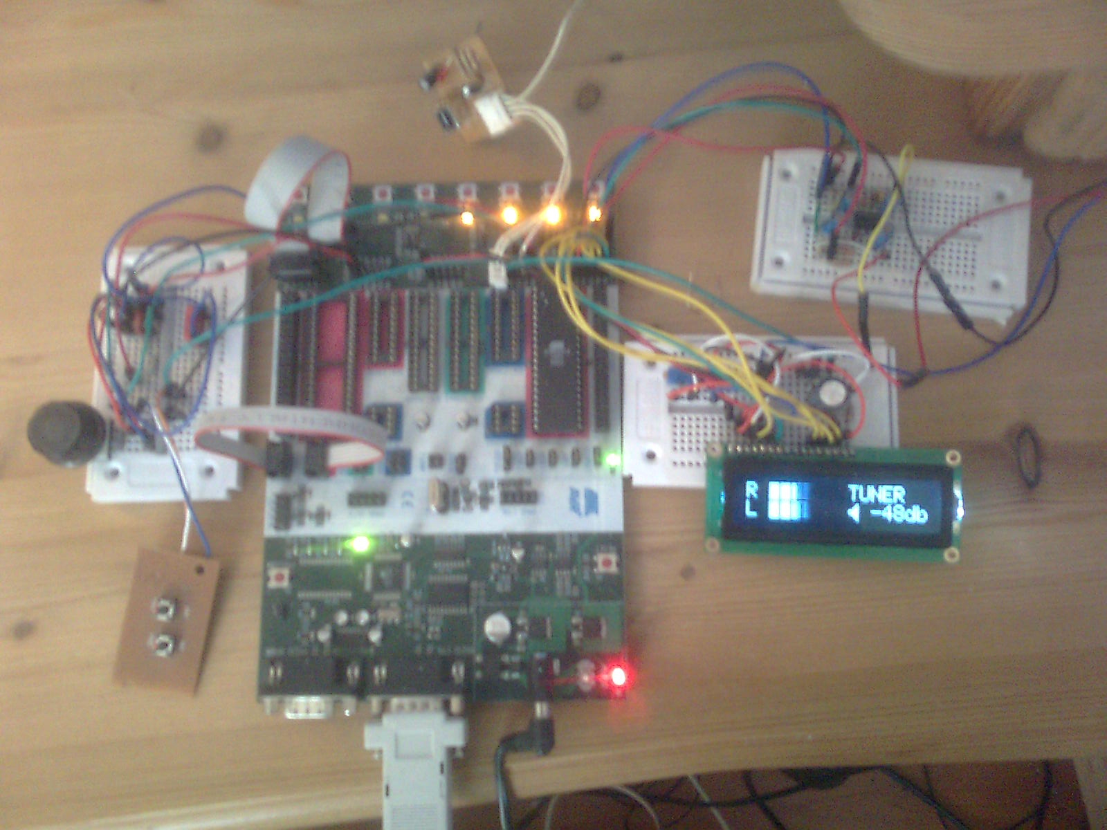

this is my test setup (dont have the real controller hardware yet

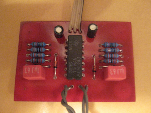

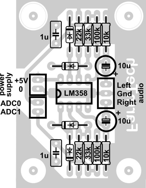

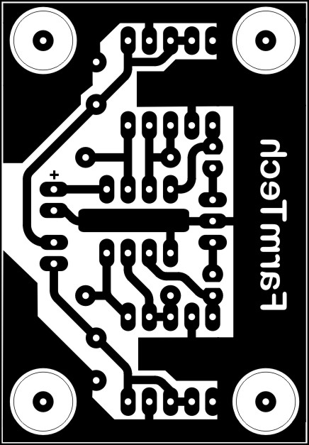

Also, I work like :snail:. I don't have much free time for my hobby, so I had to steal time from my job. FarmTech wrote program for VU meter on LCD. It looks wonderfull, but you must have extra hardware for this feature. He gave schematic for half-wave rectifier in post #302. I made PCB.
  • LM358 pcb.pdf
    LM358 pcb.pdf

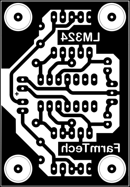

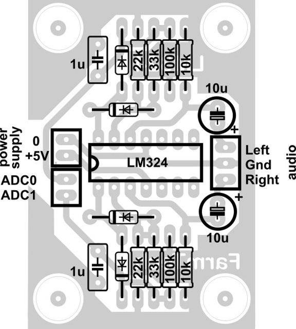

My problem is living in small city without electronic store. I must go to Belgrade even for a single resistor. I hadn't LM358, but I had LM324, so I made PCB. I also didn't have BAT42, so I soldered 1N4148.

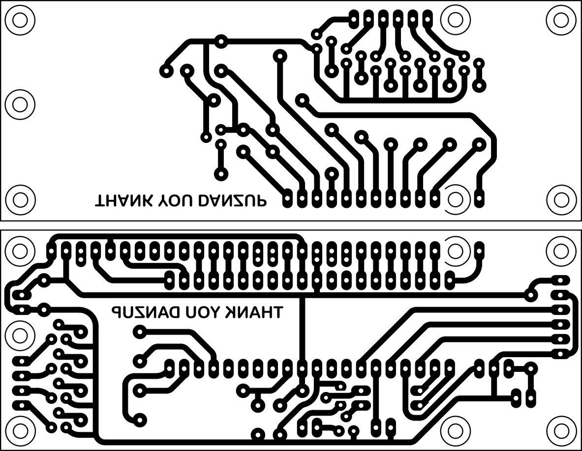

I still use my first PCBs from page 9 of this thread, but for the future I need slim and compact PCB for controller. I'm too old to use SMD, so I made new PCB. It also uses through hole components. I must warn you that this is amateur project, it's not optimised, there are no gerber files, it's just for DIY use. Simple, single sided.
