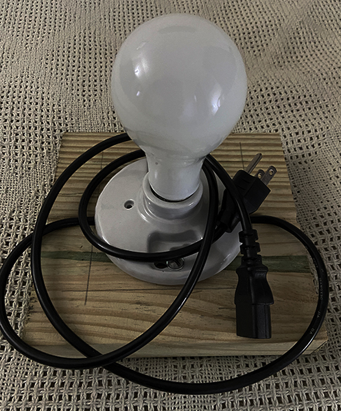

We have a known fault here. It is transient or intermittent such that smoke or steam is produced, but it's origins have not been found. It is likely a simple power supply problem, usually relatively easy to find, not an "it sounds different on Wednesdays" kind of impossible to troubleshoot thing.
It could be as simple as a bad rectifier tube, to an internal transient short in the power transformer. The only known clue in an incorrect ohmmeter reading, and a few things that do not make sense. We know that the problem started when UL was connected, but UL can not cause this, so the problem is likely related to the act of moving things around, or an early component failure. Electronic parts tend to fail in the first 100 hours of use, or after a long period of use, except for tubes, which are like car tires, they wear.
Just ran this test. 29.2 Kohms…. if I touch one of the bolts or heat-sinks with one finger and the top plate with another finger at the same time, the resistance on the ohmeter climbs to 36 Kohms.
29.2 K ohms is not low enough to blow a fuse, although it might be indicative of a transient breakdown within a part. The fact that it goes UP when you touch is also weird.
I am usually of the "put a fat fuse in it and see what burns mentality," but my projects usually start out with junk box parts, and I'm not afraid of blowing stuff up. That is NOT the popular method of troubleshooting this kind of stuff. A lot of money has been spent here, and a fat fuse can make expensive smoke.
If the amp was here, I would hook up an external current limited power supply that allows forcing power without blowing stuff up, but that's not an option here.....so we must improvise.
The usual method for hunting down these issues with limited equipment is to make a "dim bulb tester." Simply put you wire an incandescent light bulb in series with the line voltage to the amp. If there is a serious short in the amp the bulb glows brightly, but the fuse does not blow because the bulb absorbs all of the power. If there is no short or excessive current draw, the bulb glows dimly or not at all.
A dim bulb tester can be an elaborate piece of equipment with switches and meters, or it can be simple, a ordinary power cord with it's black wire cut and a 120 volt light bulb socket spliced in series with it.
Make one, connect it in place of the amp's power cord, use a bulb of 60 to 100 watts, connect the amp and apply power with the usual meter on B+. You should see no glow with no tubes installed. There will be a slight glow with only the rectifier tube, until the tube warms and the B+ begins to climb. This is where things went wrong before. As the B+ climbs the bulb should dim, but if the problem still persists it will glow brightly.
If that is still the case, disconnect the choke and repeat. Bulb dim, problem is after the choke. Bulb bright, problem is before choke.

Yep, I also used a spare computer power cord. That's a 200w bulb, not sure if it's the right wattage.
I plugged one end into the amp and the other into a power strip, and used the power strip on/off switch so I didn't even have to touch the amp.

I did round up the parts for a dim-bulb tester (paid $7 for two 100w incandescent bulbs, FFS!) and hope to put it together on the weekend.

- Built my dim-bulb tester
