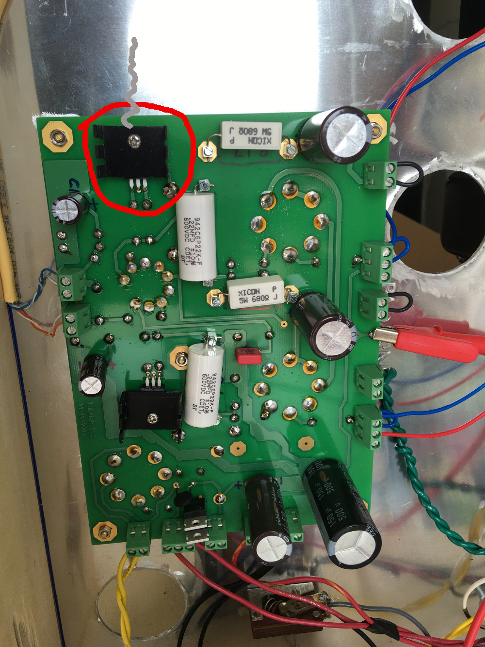

OK, well that didn't take long.
Rectifier only test, DMM hooked up to test B+, remote power switch, just as George prescribed.
B+ got up to maybe 30 volts, the rectifier tube lit up normally, and then I heard a short, quiet vvvvhhhnt (you know, that sound of current, like in a seized electric motor?) and immediately looked at the board.
A small stream/puff of smoke came from the CSS (see attached). Actually, I am not 100% sure. It may have come from the other side of the board...
I shut it down with the remote switch and stood there for a minute or two, thinking. I then went ahead and flipped the remote switch on again.
No B+ at all. I waited 15 or 20 seconds and then shut it down again.
So that's where it stands right now.
I used these CCS chips: IXCP10M45S IXYS | Mouser Canada

Hey, you're making progress. And a lot of extra credit for the "smoke", which was totally awesome. I don't recall ever seeing anyone do that before, and it does help us visual types. So... regardless of what actually poofed, I'll place my bets now that George's next question would be, "So what made it smoke?"
It's more than likely that there are several possible causes, but George is much better qualified to weigh in on those. In the meantime I'd do another visual, then (assuming it's the CCS) measure several of the components surrounding it to verify whether or not any of those other components were affected (again, assuming U10 blew then I'd measure R13, R14 and R19).
Hopefully you have one or two spare ICs, but if not I wouldn't worry about that until you ascertain the root cause.
Another thought: when you flipped the switch the second time (when there was no B+), were you able to determine if the heaters were lit? And did the fuse blow?
And another another thought: if the smoke did originate from the "far" side of the board, then just about every component in that vertical line is still suspect, including the other CCS. And if it is indeed one of the CCS chips then something other than a tube is completing its path to either ground or some other lower voltage point.

When I flipped the switch the second time, I didn't check anything except B+ and I looked for more smoke. There was no action at all.
I should check the fuse...

First check the fuse. If there is no B+ and the rectifier tube is not lighting up, the fuse is likely dead.
I have seen the CCS chips blow, but rarely in an SSE, in fact I can't remember seeing a dead one in an SSE since there is a resistor between the CCS chip and B+. Look at R14 and R24 for any signs of damage. If none is found remove the heat sink and look at the plastic part of the CCS chip. If smoke happened, it should be obvious.
Your comment about bad IXYS parts brings me to the FRED diodes, D1 and D2. If you are not planning on using the solid state rectifier option, just remove them. The IXYS parts were prone to failure on power surges. A dead one will blow fuses and cause no B+. They are not used unless the solid state rectifier switch is installed, but a bad one can cause problems.
The fuse is dead.
I will need to remove the board from the chassis to inspect R14/24. Is there anything else I should try/test before removing the board for inspection purposes (just to save myself some time)?
When I remove the board, I'll remove the FREDs. I thought I would have fun playing with SS vs. tube rectification, but I just want the amp to work now.

The CCS chip could be fried into a lump of carbon (highly unlikely/nearly impossible) and there would not be enough current flow to blow a fuse. There is a major issue somewhere that is not obvious yet.
There is a short, or intermittent short, somewhere on the B+ circuit that is strong enough to blow the fuse. You could divide the problem in half by disconnecting the choke and powering it up again with the rectifier tube installed. If the fuse does not blow, the problem is after the choke. If the fuse still blows, the problem is the rectifier tube, C1, the FRED diodes, or the wiring. Without the choke, there will be no voltage on C4 so connecting a meter is not necessary. There will be voltage on the choke connector pin closest to the rectifier tube if you want to measure B+.
Is it possible that one of the components (or the screw for the CCS chip) on the other side of the board is up high enough to touch the top plate?
With no power to the board connect an ohmmeter between the B+ (R4 is fine) and ground (like when the B+ voltage was measured, only set to ohms). It will take a minute or so, but the reading should settle to around 75K ohms. My SSE measures 74.2K ohms. A low reading indicates a short somewhere. If the reading is around 75K flex the board in the area where the CCS chips are to see if the reading changes.

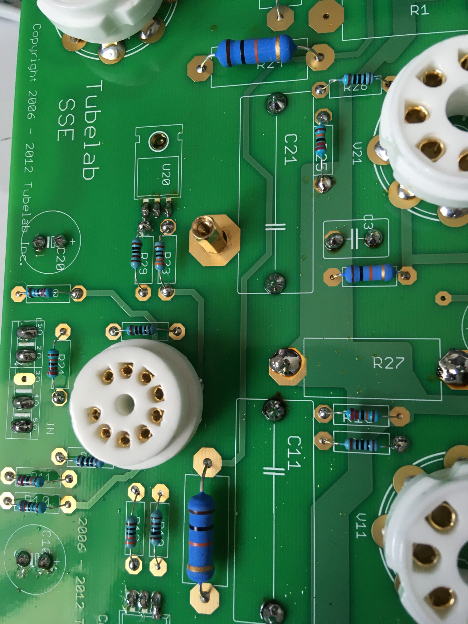

Went ahead and removed the board. No signs of damage to R14 or R24 (see attached). No signs of damage to any resistors, actually.
I lifted U10 slightly (bent the pins just a bit) to get a look at the CCS plastic. No obvious signs of melting or burning. I should note that I used heat-sink compound (the common white stuff) when I installed the heat-sinks on the CCS parts. Could it have been boiling/burning?

I see no signs of spark marks on the top plate, and nothing that I can see that would come close to the top plate when the board is installed.
