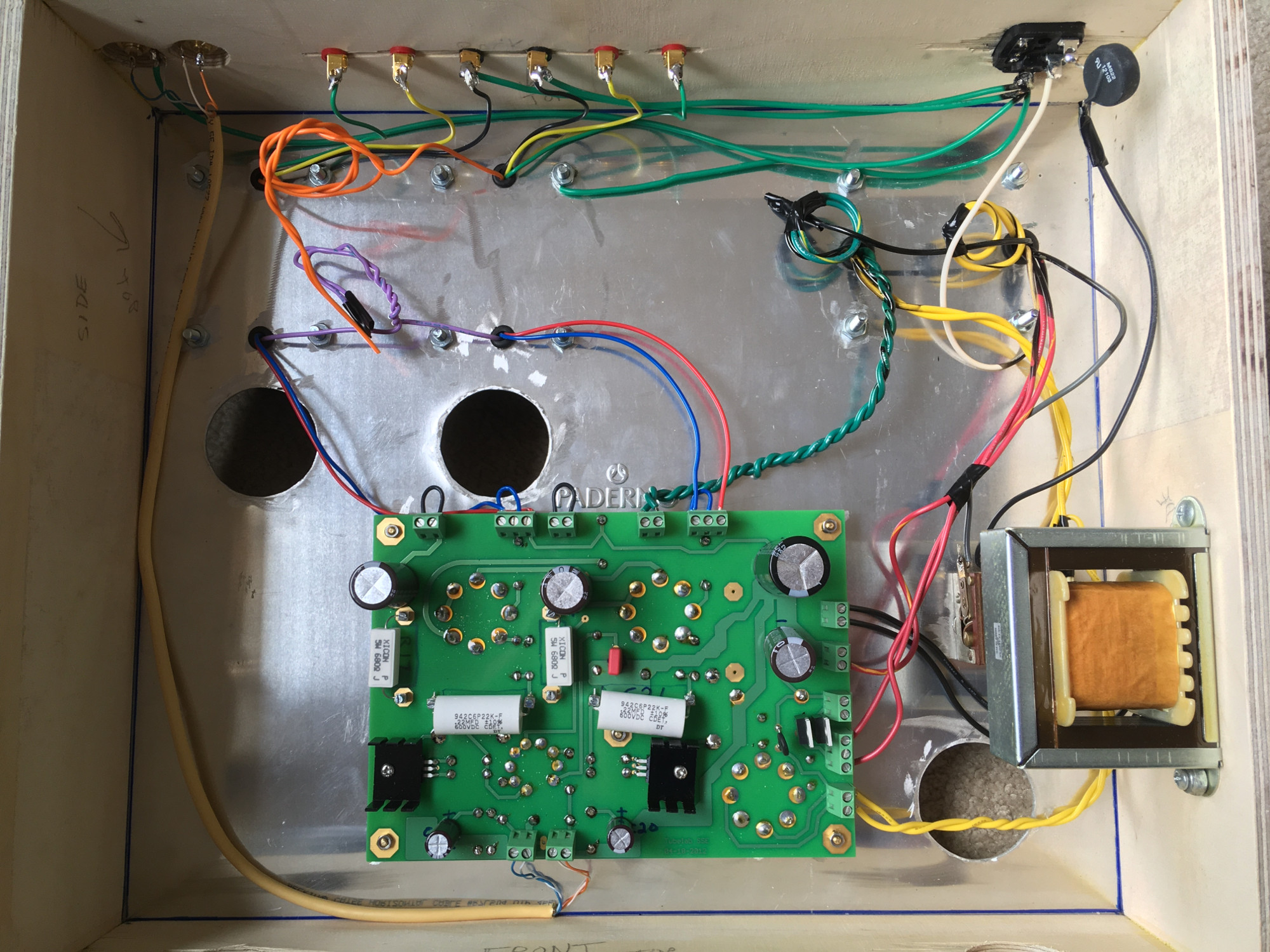

I looked at the pictures of your board and everything seems to be installed correctly.
The amp was still making music from both channels when the event occurred? If so all of the major components are still alive.

I removed the board earlier and inspected all the top-side components and found no sign of heat anywhere. All the resistors look like they did when I installed them. No browning on any of them. All solder connections look shiny and solid. I've looked closely at the caps and other components on the bottom side and it also looks fine to my untrained eye. No signs of capacitor leakage. Cathode resistors also look immaculate.
The output tubes are Electro-Harmonix (Russia) EL34-EH that were previously used in my EL34 P-P amp. They were a set of 4 and I burned one out in that amp so pulled the remaining three and installed 4 new Mullard re-issue EL34s. So these EL34-EH tubes have some hours on them. Enough that one of their brothers burned out. Close inspection shows no obvious signs as you have described. Neither tube was glowing red when the event occurred. I feel like I would have noticed that, but again I was in "kill it fast" mode.
Attached pic is how I have it wired now, which is precisely as it was wired when it worked fine for hours in triode mode. When I switched to UL, I removed the blue jumpers and installed the (purple, now taped off) UL taps exactly as shown in your wiring diagrams. That was the only change I made.
I should note that the only sign of heat that I can find in the whole works is the aforementioned star ground point. As you can see, I have that point connected to: 1) the top plate (via one of the OPT bolts), 2) ground connector of each speaker output, 3) ground connector of one RCA input connector. The charring on that ground point was there before this event occured (due to my screw up with the alligator clip) but I can't say for sure that it isn't worse now.
